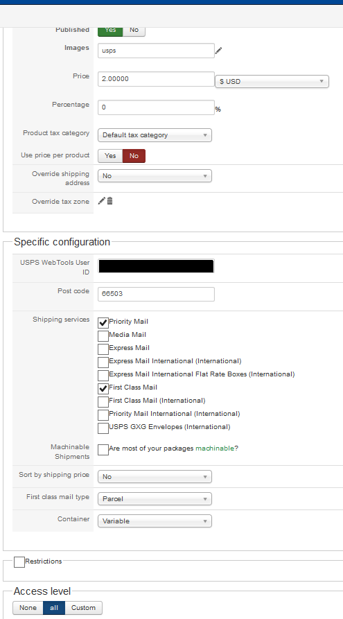

Can you give me more information through some screensthos for example about :
- the issue that you are having when using the last version
- the way you configured you shipping method / product

No error is displayed. It just displays the same rate for every order regardless of the destination, products, weight, quantity, etc.
It is always returning $4.54 for First Class Mail. I'm not sure where it is getting the number.

The priority mail seems to be correctly updating (the first class mail wasn't displayed), also note that your issue can be coming from the fact that you have just set a weight and no dimensions for your products. Can you test it with product which have weights and dimensions ?
