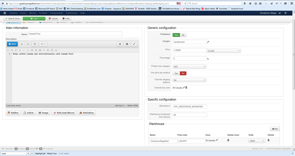

-- url of the page with the problem -- : greatnessmagnified.com/store
-- Joomla version -- : 3.4.0
-- Error-message(debug-mod must be tuned on) -- : An error occurred. The connection to the Canada Post server could not be established:
There is no warehouse usable for that location
I've upgraded to the recent version 2.4, two months as you anticipated from your last post ( www.hikashop.com/forum/shipping-methods/...-group-packages.html ). Thank you for the new release.
I'm hoping that my previous issue will be resolved but am now also receiving a new error. I've searched the forums and so far have not found a solution to my problem.

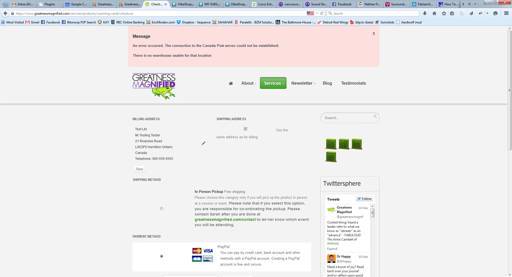

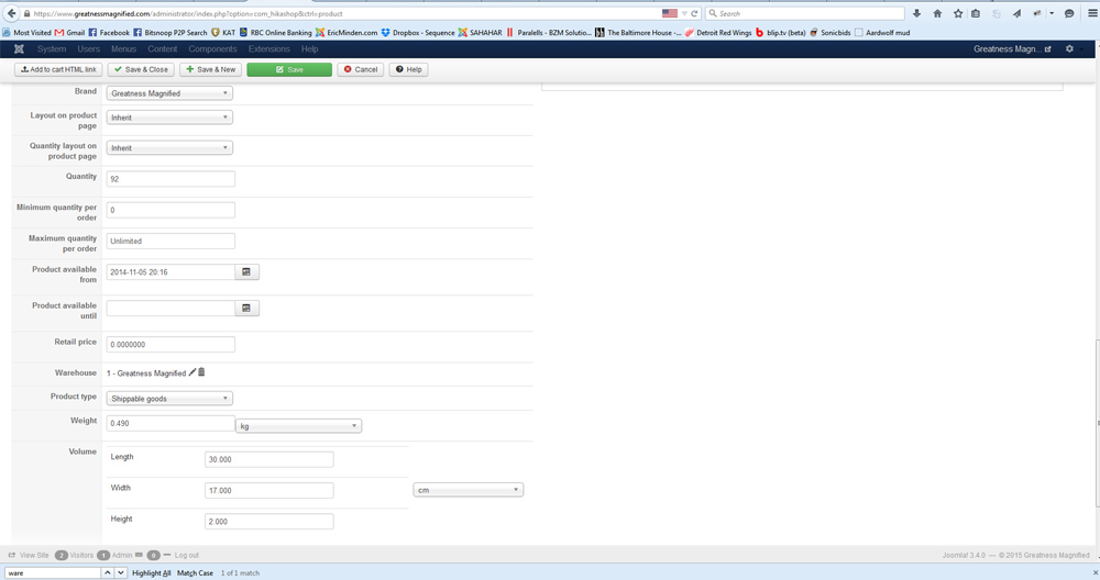

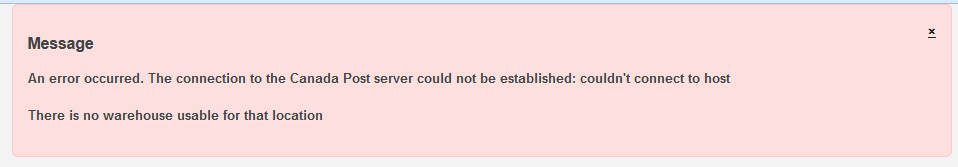

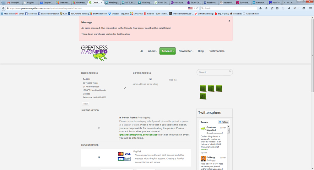

Front end checkout, after entering a valid Canadian address (I've tried a couple) I get the following message:
"An error occurred. The connection to the Canada Post server could not be established:
There is no warehouse usable for that location"

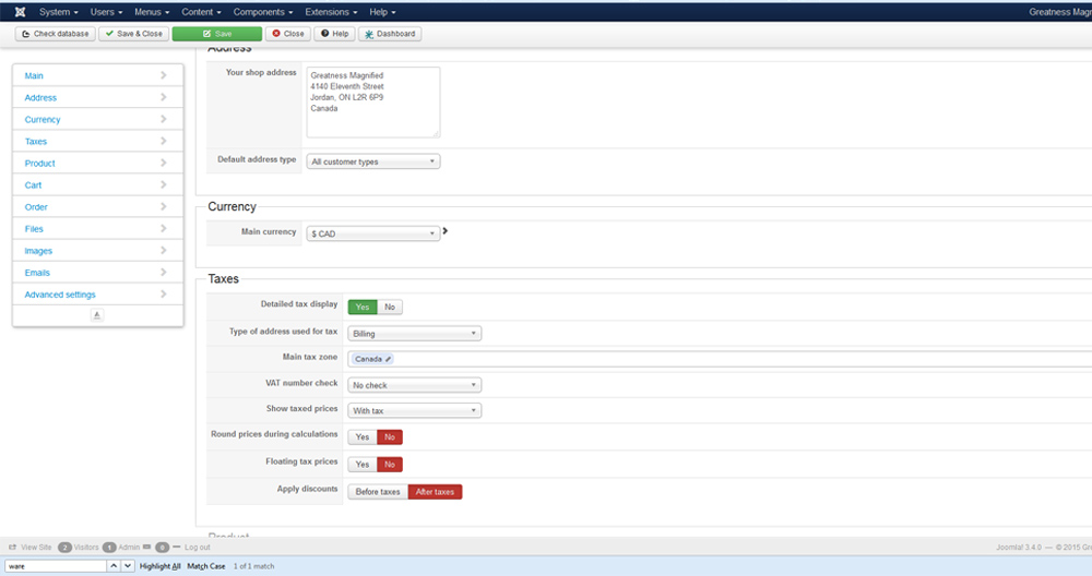

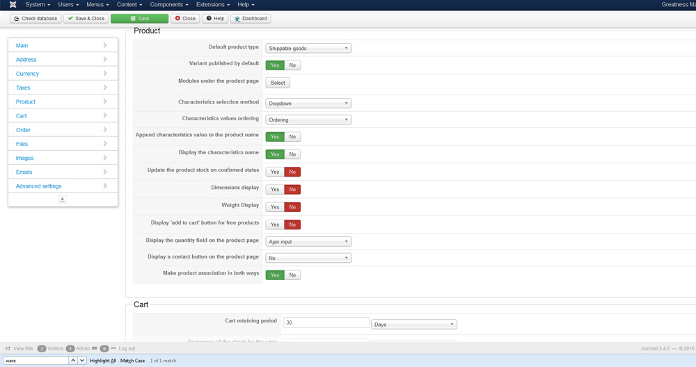

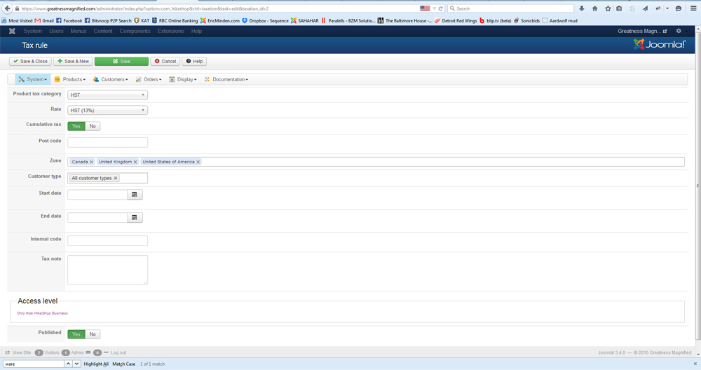

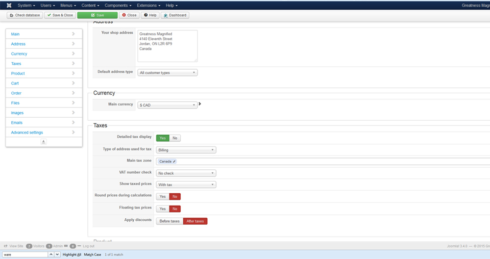

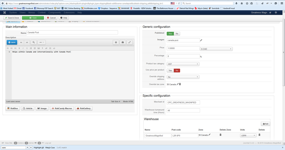

I have recently tried adding in sales tax but even with sales tax unpublished in the "taxes" section and switched off in both the Canada Post Shipping configuration and Product configuration I still get this error.

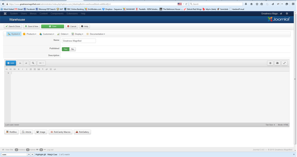

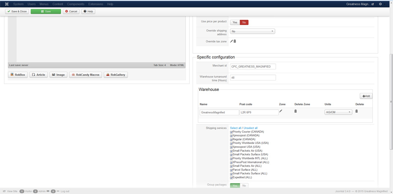

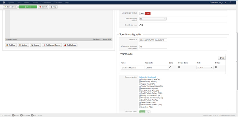

I believe I set up the warehouse correctly and didn't have this issue with the previous version. I have tried modifying the warehouse address, adding or eliminating zones, all to no avail.

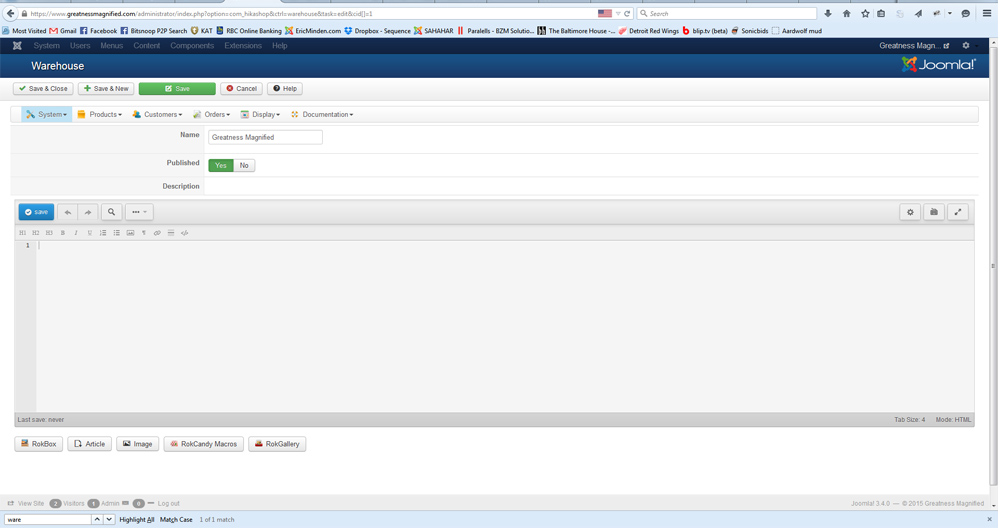

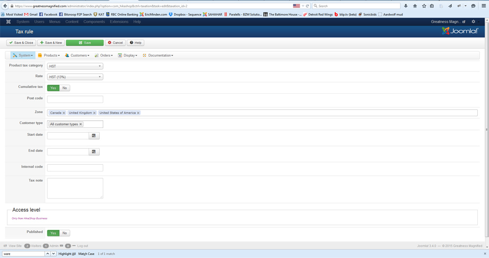

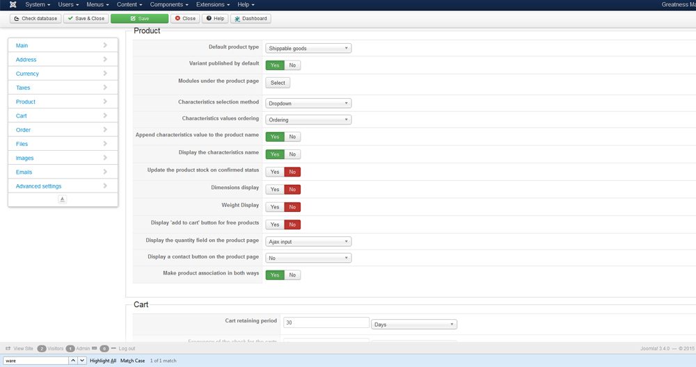

Below I'll add some screenshots and Mohamed I'll send you credentials again through a PM.
Thanks,
Eric

Can you test it with that last Canada Post version ?

Can you remove the "Zone" restriction from your warehouse and test it again ?
  • Posts: 12
11 years 4 months ago #194968
Removed but no change

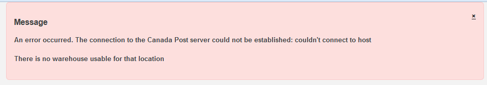

  • Posts: 12
11 years 4 months ago #195481
Full error message less the quotes..
Message
An error occurred. The connection to the Canada Post server could not be established: couldn't connect to host
11 years 4 months ago #195517
As it's said on the error message, something is currently preventing your shop to access to the Canada Post server, It could some kind of firewall/protection tool, you should check it or directly ask it to your hosting company.

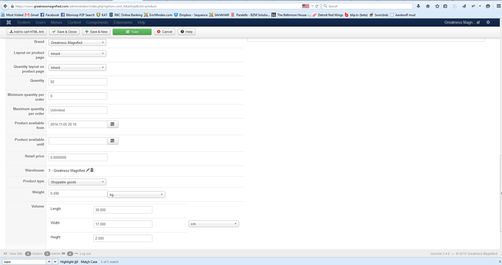

I too am having the following error message: "There is no warehouse usable for that location". That is the only message I receive. I have set up a warehouse and assigned it to the products, but still keep getting this message. I have only installed HikaShop within the last two months and this is the first time I have had a customer try to use it & we keep getting this message. Also all the products have the dimensions in the restrictions category.
I have tried different variations of the postal code entry, but that doesn't work. I have no zone restrictions. I am at a loss as to what I could be missing in regards to this.
