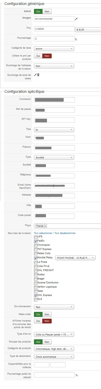

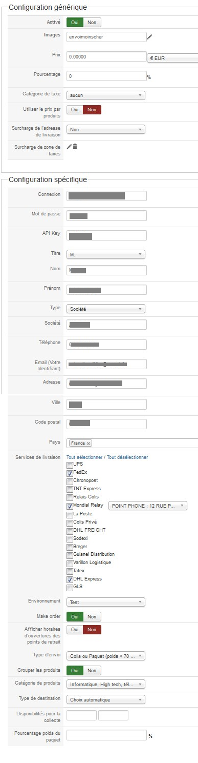

10 years 10 months ago #221037
if nothing is showing then the issue is probably coming from the fact that no pickup point are available for your order regarding its Dimension/Weight, can you also show me some screenshots of how you configured your Envoimoinscher shipping method to see if you correctly configured it ?

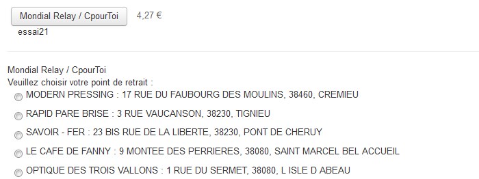

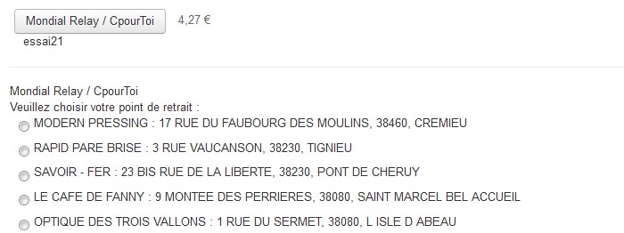

10 years 10 months ago #221186
I solved one problem. Button for Mondial Relay is there. If the address buyer had a company name it seems that we can't send to a company with this mean but only to residence address....
But a got a new problem. When I click to the button I have got a shop list with radio button. I select one click on next but nothing happens. I'm back to the same page....see attached file
