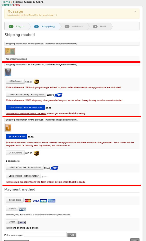

Thank you for your help in setting up this mixed system of shipping. Many bugs are worked out, and it is working fine but I still have a few questions.
The image below is a screenshot of a sample order with:
1 - A free booklet item at the top that does not have any shipping method.
2 - Shipping area for a heavier item
3 - Shipping area for a standard flat rate shipping item
4 - The payment area
The problem is the page looks very jumbled together and customers sometimes get confused. I made some red lines between the areas in the image, but is there is anyway to make some division show up in the checkup page. A heavy line, a large space, a box around the areas? Do you have any ideas. My code writing skills are very limited, but I do a lot of cut and paste and tweaking.
10 years 7 months ago #230642
The best solution will be to directly use some CSS code customization : www.hikashop.com/support/support/documen...the-display.html#css
Or to directly edit the "Shipping" file of the "Checkout" view of your front-end template via "Hikashop->Display->Views".
