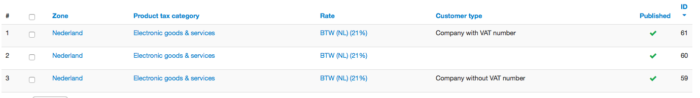

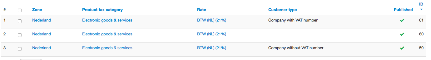

Please edit each tax rule for your country and provide a screenshot of the option screen of each one.

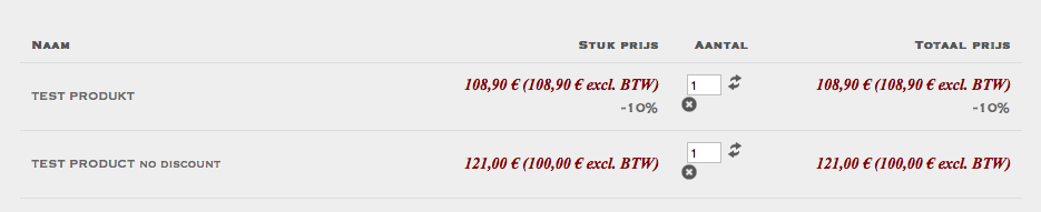

11 years 8 months ago #185824

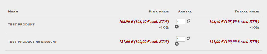

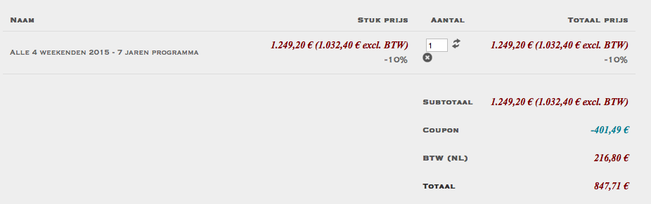

Of course could be a wrong setting somewhere but it keeps coming back:
Setting: standard customer in the Netherlands:
VAT 21%:
The customer order 2 identical products, (made a copy). One with 10% discount the other not:
As you can see, one gets VAT applied, the other not.

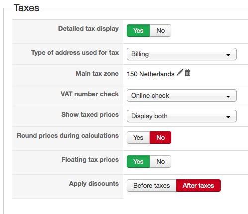

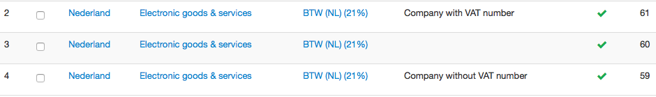

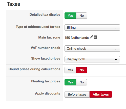

Tax settings in config:
Curious whats going on.

11 years 8 months ago #185941
It could come from the floating tax prices option.

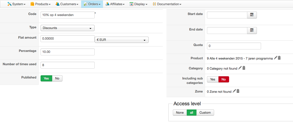

That is a new option we introduced in the 2.3.5 and I wouldn't be surprised that it would have some issue with discounts.

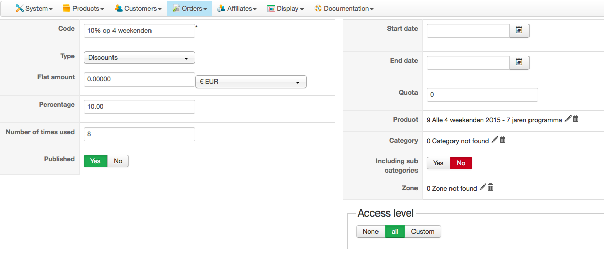

How did you configure your discount ? Could you do a screenshot ?
Could you try to turn off the "floating tax prices" option and see if that helps ?

Discount is pretty simple. just 10% on that specific product.

Nicolas, we need to apply after taxes, this is a consumer site and 50 euro discount should end up as 50 euro of the total.
So for testing: floating set and taxes before:
When I have no discount, it show inc and excl taxes ok
When I set a discount, taxes before, it seems ok
I get the same incl and excl prices when I switch back to after taxes.
So the issues is indeed when set to discount after tax
Coupons seem to work OK. (although we had to change them all and give them a VAT select to get the same prices back again.)

Setting: VAT set to FLOAT, apply discount after TAX. That seems to mess up the VAT calculation when using an overal discount. (not coupon)

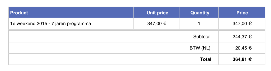

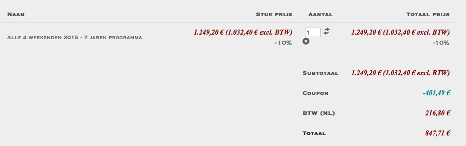

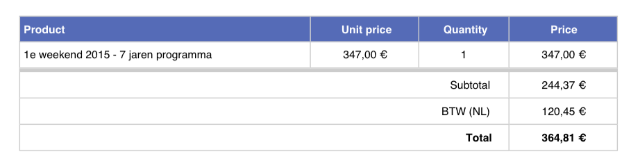

Just to add to the misery: I get clients that are confronted with wrong prices:
Shop is using prices included VAT but see this invoice when someone enters his VAT number while in a country without exempt:
(Dutch company buying in NL from our Dutch shops)
Some crooked calculation pops up. Instead of the proper 347, he has to pay a strange amount. We are now serious in trouble with a bunch of clients and overloaded helpdesk..
We have set the VAT amount for companies in the Netherlands equal to consumer amount. With or without VAT number:

  • Posts: 187
  • Thank you received: 10
11 years 8 months ago #186928
Hi Jerome,
Yes it works now for a general discount and VAT seems ok, although I will have to test a bit more tomorrow with and without VAT number.
but coupons still don't work right. My settings is still apply discount after tax but the coupon code still takes discount before tax.
Of course I have a complicate example: product receives 10% discount and then people can add a 50% discount coupon that should override. 50% of 1388 = 694. Not whats on the sheet now:

				$discount->taxes[$namekey]->tax_amount = $discount->taxes[$namekey]->tax_amount * floatval($discount->discount_percent_amount) / 100.0;
				$price->taxes[$namekey]->tax_amount = $price->taxes[$namekey]->tax_amount - $discount->taxes[$namekey]->tax_amount;
			$prices->prices[$k]->price_value_with_tax = $price->price_value_with_tax - $discount->discount_percent_amount_calculated;
			if(isset($price->price_orig_value_with_tax)) {
				$prices->prices[$k]->price_orig_value_without_discount_with_tax = $price->price_orig_value_with_tax;
				$discount->discount_orig_percent_amount_calculated_without_tax = $discount->discount_orig_percent_amount_calculated = ($price->price_orig_value_with_tax * floatval($discount->discount_percent_amount) / 100.0);
				$discount->discount_orig_percent_amount_calculated = $this->getTaxedPrice($discount->discount_orig_percent_amount_calculated, $zone_id, $discount->discount_tax_id, $round);
				$prices->prices[$k]->price_orig_value_with_tax = $price->price_orig_value_with_tax - $discount->discount_orig_percent_amount_calculated;
		} else {
			$discount->discount_value_without_tax = 0;
		$discount->discount_value = $prices->prices[$k]->price_value_without_discount_with_tax - $prices->prices[$k]->price_value_with_tax;
		$prices->prices[$k]->price_value_without_discount = $price->price_value;
		$prices->prices[$k]->price_value = $price->price_value - $discount->discount_value_without_tax;
I also made some modification in the class discount for other improvements.
  • Posts: 187
11 years 7 months ago #187116
Hope your headache is better, mine is not :-)
Replaced the class but discount is still applied before taxes. Switching that option in the config does not change the numbers.
Checked it only with a very basic product (ID=1) and a coupon.
Also switching tax category in the coupon setting does not change the amounts so it seems to miss those values completely.
For security of testing it might be safer to attach or email the full currency.php file.
  • Posts: 26386
  • Thank you received: 4078
11 years 7 months ago #187181
I'll need more details about your coupon in order to reproduce it.
