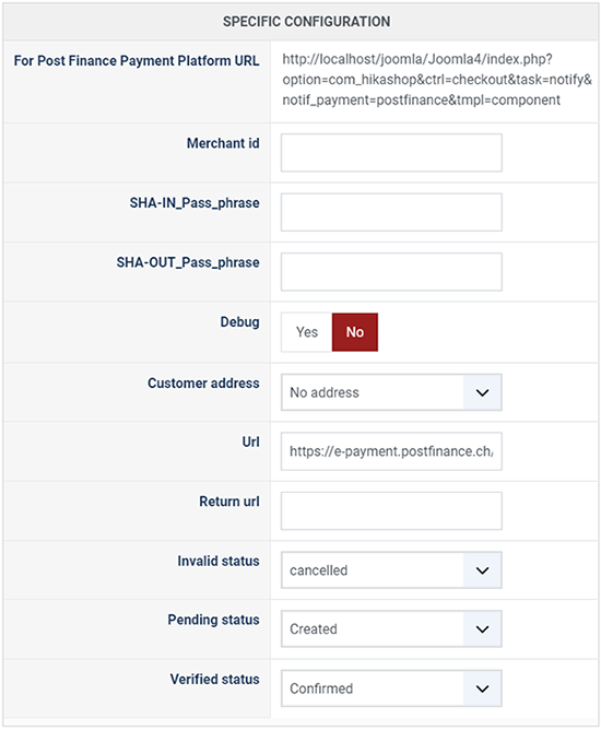

Additional Information
Additional information
  • For Post Finance Payment Platform URL : You need to enter that URL in the settings of your PostFinance user account interface. That's where the payment notifications need to be sent so that the PostFinance plugin can confirm your orders.
  • Merchant ID : Your PostFinance merchant ID
  • SHA-IN Pass phrase : The security pass phrase that you'll have to define through the "SHA-IN pass phrase" option of  the "Data and origin verification" section of your PostFinance user account configuration page.
  • SHA-OUT Pass phrase : The security pass phrase that you'll have to define through the "SHA-OUT pass phrase" option of  the "Transaction feedback" section of your PostFinance user account configuration page.
  • Debug : You can activate the debug mode of the PostFinance payment plugin. If you do so, information about each notification received from PostFinance will be logged in the payment log file. You can see and modify the location of this file in the configuration page of HikaShop
  • Customer address : If you want, you have the possibility to include the billing or shipping address of your customers to the PostFinance payment engine.
  • URL : The URL to which your users are redirected to for the payment. By default, it is set to https://e-payment.postfinance.ch/ncol/test/orderstandard.asp and directs the customer to the payment gateway test environment. Once you want to process real transactions, you'll want to change it to https://e-payment.postfinance.ch/ncol/prod/orderstandard.asp
  • Return url : The address the customers are sent back to after the payment.
  • Invalid status : Here, you can select the status to set to an order if the plugin receives a notification from PostFinance for an order with an amount different from the order total or in a different currency. In that case, we highly recommend you to check your PostFinance account, the order information, and maybe contact your customer, and decide yourself what to do with the order.
  • Pending status : Here, you can select the status to set to an order if the plugin receives a pending notification from PostFinance for an order. A pending notification means that the customer entered his payment information but that PostFinance could not yet receive the funds. In that case, we highly recommend you to check your PostFinance account, the order information, and maybe contact your customer, and decide yourself what to do with the order.
  • Verified status : Here, you can select the status to set to an order if the plugin receives a successful completion notification from PostFinance for an order.
