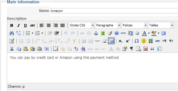

Main Information
If you use one of our commercial versions, you will be able to enter the name and description in different languages. This feature requires to have joomfish installed and can be activated in the configuration page, in the display tab. The languages available will be the ones in joomfish. If you don't enter something for a translation, it will just use the default information in the Main information tab instead. After you click on save or apply an additional publish icon will appear next to the fields where you entered something in the languages tabs so that you can easily enable or disable them. The default publish status can also be changed in the configuration page of HikaShop.

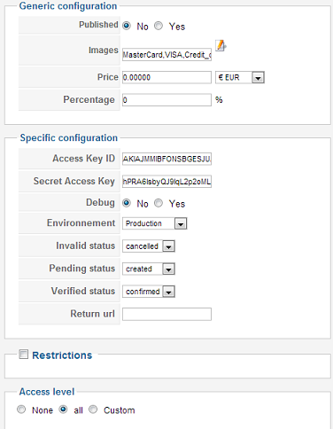

  • Zone : You can restrict the Amazon payment method to a zone. By clicking on the edit icon, a popup will open enabling you to select a zone. You can also remove this limitation by clicking on the delete icon.
  • Images : You can click on the edit icon to select one or several images to display next to the name of the Amazon payment method during the checkout process. Those images are stored in the folder media/com_hikashop/images/payment so you can easily add more of them by uploading your images to this folder via FTP.
  • Shipping method : With this option you can select the shipping method for which this payment method will be available. For example, if you choose UPS, this payment method will only be usable if UPS is selected as shipping method. If an other shipping method is selected, this payment method will not be displayed. Note: if you selected "None" or don't select any shipping method, this payment method will always be available.
  • Currency : This option allows you to restrict Amazon to only some currencies. Note that on top of that, the Amazon method won't display for any currency not supported by Amazon.
  • Access Key ID : Your Amazon access key ID that you'll find through your amazon configuration pages.
  • Secret Access Key : Your Amazon secret access key that you'll find through your amazon configuration pages.
  • EnvironmentThe Sandbox environment is used for testing. Once you have tested the plugin, you can pass to a production phase and set the Environment option to Production.
  • Debug : You can activate the debug mode of the Amazon payment plugin. If you do so, informations about each notification received from Amazon will be logged in the payment log file. You can see and modify the location of this file in the configuration page of HikaShop
  • Cancel url : The url you want your users to be redirected to when they cancel the order from the Amazon interface. By default, they will be redirected to the first step of the checkout process.
  • Return url : The url you want your users to be redirected to when they finish their payment on the Amazon interface. By default, they will be redirected to the after_end page of the checkout process which will thank them for their order.
  • Invalid status : Here, you can select the status to set to an order if the plugin receives a notification from Amazon for an order with an amount different from the order total or in a different currency. In that case, we highly recommend you to check your Amazon account, the order information, and maybe contact your customer, and decide yourself what to do with the order.
  • Pending status : Here, you can select the status to set to an order if the plugin receives a pending notification from Amazon for an order. A pending notification means that the customer entered his payment information but that Amazon could not yet receive the funds. In that case, we highly recommend you to check your Amazon account, the order information, and maybe contact your customer, and decide yourself what to do with the order.
  • Verified status : Here, you can select the status to set to an order if the plugin receives a successful completion notification from Amazon for an order.
