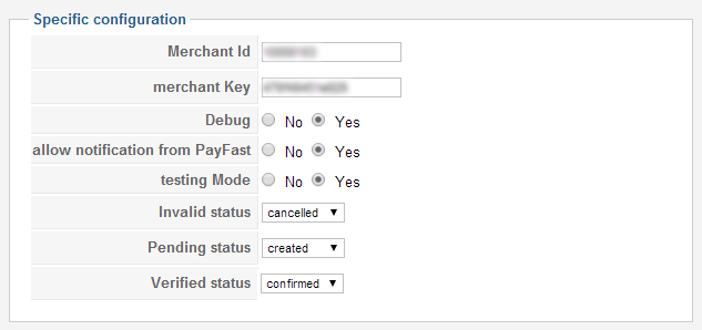

- In this part, we will see the primordial options of the PayFast payment method. The only things you will need are your Merchant Id and your Merchant Key.
- Merchant Id : Just put your Merchant Id in this field. This identifier is given by PayFast.
- Merchant Key : Just put your Merchant Key in this field. This code is given by PayFast.
Note: If you want to know more about these PayFast settings, you can look at the step by step sandbox setting page.
The different options:
- Debug : You can here enable the debug option of the API. Don't enable this one if you don't have to look into the API's configuration
- Allow notifications from PayFast : If this option is enable, the automatic response of PayFast server will be treated to update the order status. For example, if the payment has been completed correctly, the order status will be the specified verified status.
- Testing Mode : You can choose here to switch in test mode (for use the PayFast sandbox) or in production phase.
- Invalid status : Here, you can select the status to an order if the plugin receives a invalid completion notification from PayFast for an order.
- Pending status : Like, for "invalid status"you can set to an order if the plugin receives a pending completion notification from PayFast for an order.
- Verified status : Same idea than "invalid" and "pending" status.

- In order to use the PayFast payment method, you have to possess some informations that PayFast should have given to you,your Merchant Id and Merchant Key, so you must create an account on PayFast to get this information and be able to reach your PayFast setting page.
- After this, you have to enter your Merchant Id and your Merchant Key in your PayFast Specific Congiguration.
- Choose to switch on the testing mode OR not ("production phase") and your plugin will automatically send the needed data to the right PayFast page.
- Once your plugin is configured properly, you will probably want to try it. Before switching to the production phase ("Testing Mode: Off"), you should be able to make test payments with PayFast Sandbox. The capture will not be done and you should see a confirmation ticket proving you that everything works ok and if the payment is accepted, your order will take the specified verified status automatically (you need to have your website online for that as PayFast needs to notify it of the payment).

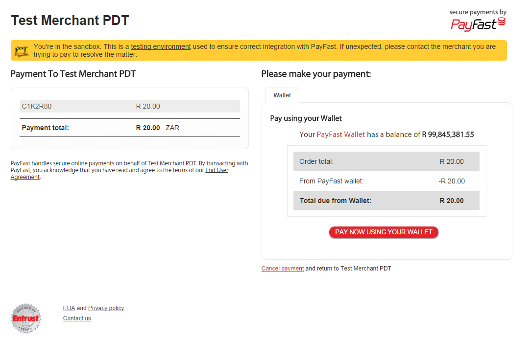

View on PayFast Purchase
- Let's have a look just after the customer click on the finish button.
After the checkout, customers will be redirected to the PayFast payment window (here in testing mode).
For the end of the operation
- Customer have to validate to validate his purchase on the PayFast platform.
Later, the order status will be get and save by Hikashop.
