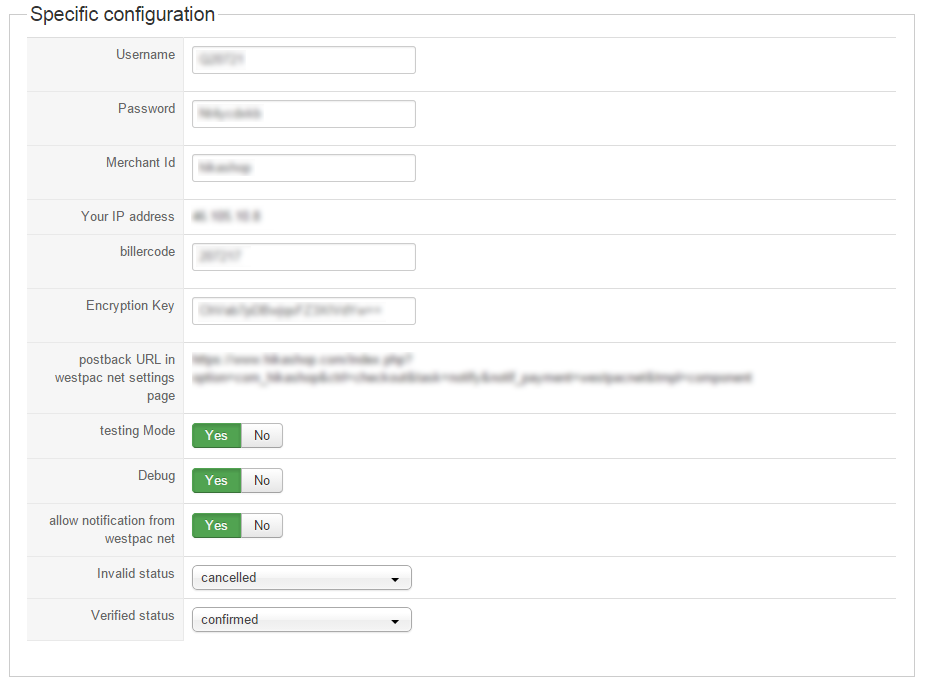

In this part, we will see the primordial options of the Westpac Net payment method. You will need your Username, Password, your Biller Code AND your Encryption Key, and for production phase, your Merchant id. These references are in the Westpac/Payway setting page.
Also, you want to note the server's IP Address and the postback URL, as it will be useful later on.

- Username : Just put your Username in this field. This identifier is a code made of characters (number and letter).
- Password : Like the Username. You will find it on the account Westpac/Payway setting page.
- Merchant Id : Your Merchant Id in this field, especially for the production phase. (Not required in testing mode)
- Your IP address : Here, you can see your IP address, it will be useful to set it in your Westpac/Payway setting page. Payway will accept only the registered IP Address in order to process payments (even for the testing mode)
- Billercode : Like other security references, you will find it on the Westpac/Payway setting page
- Encryption Key : Another required field to decrypted Westpac/Payway notification.
- Postback URL : This will be useful on the Westpac/Payway settings page.

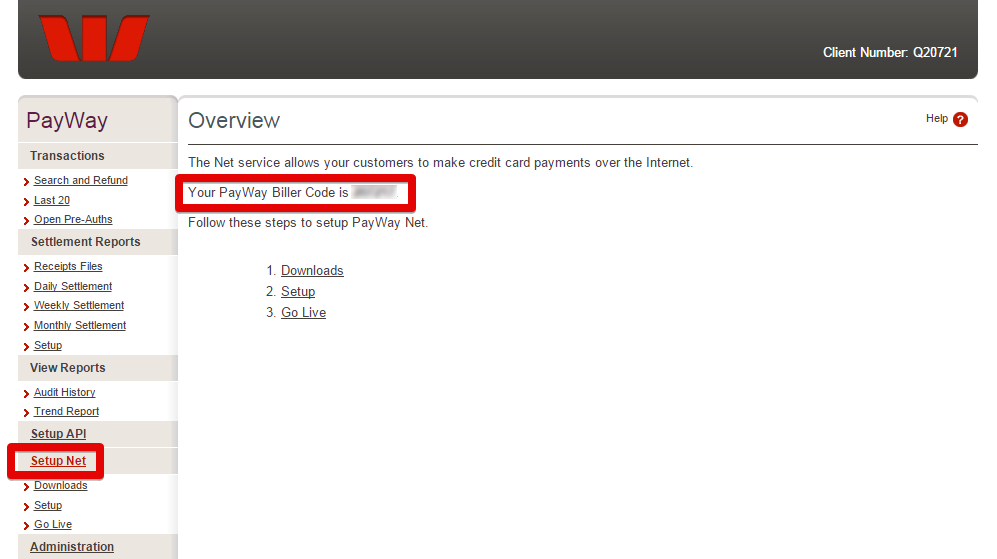

To go to Westpac/Payway Security page, go on payway.com.au log in, and click on Setup Net, then Security. You will now see your Biller Code, keep it for your Westpac Net specific configuration plugin and click on setup.

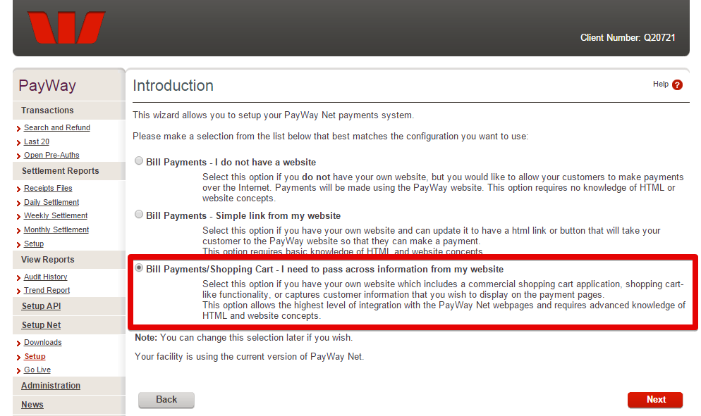

Here, you must select "Bill Payments/Shopping Cart", and continue by clicking on next.

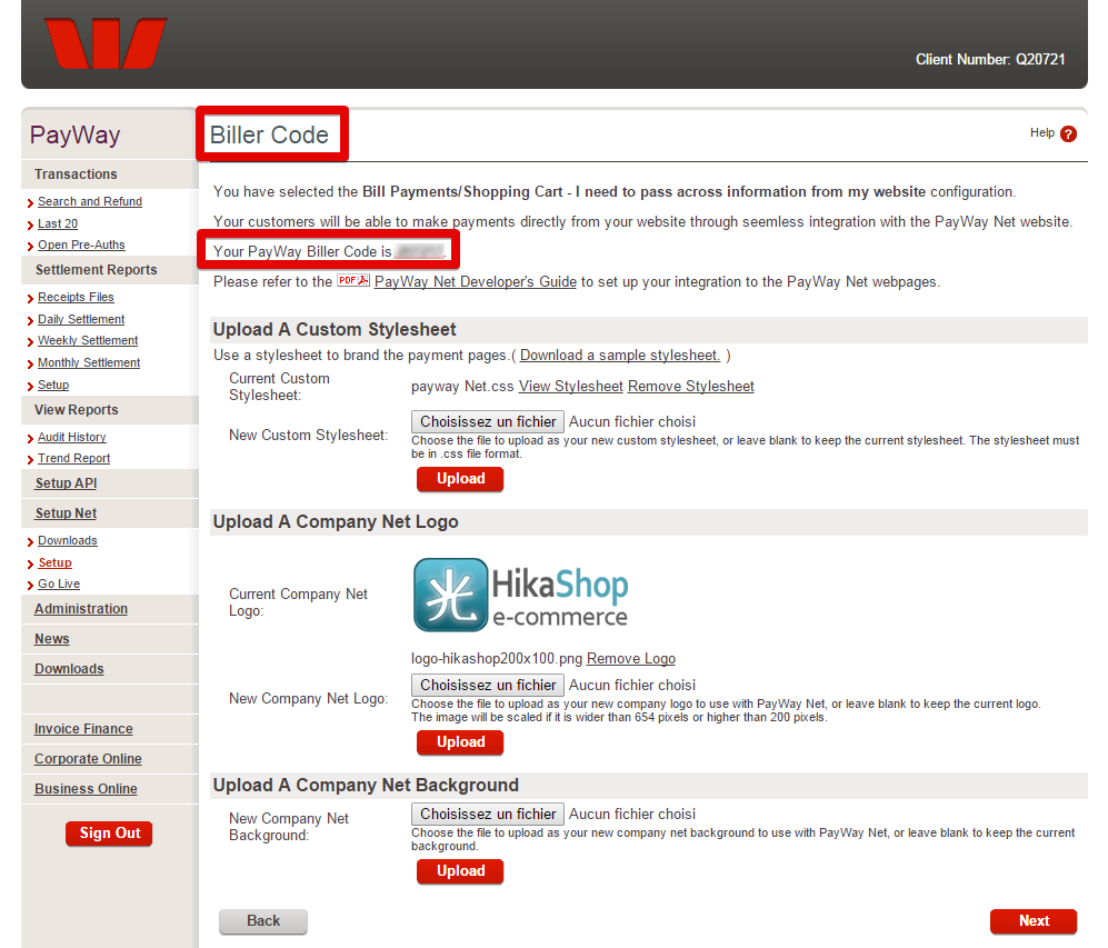

This page shows you again the Biller Code and allow you to custom the Westpac/Payway payment page, for our plugin configuration continue with the next button.

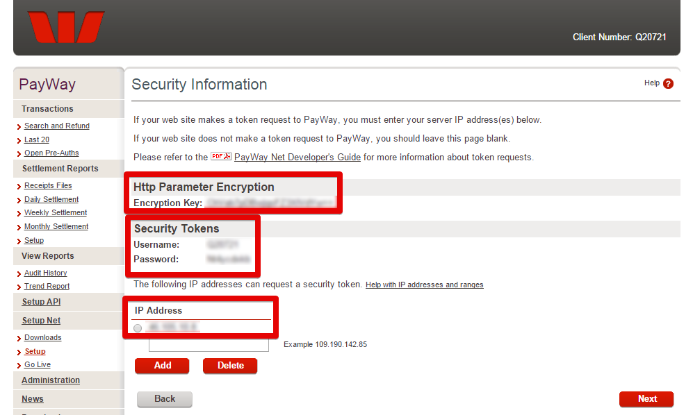

Here, you will find your Encryption Key, your Username and your password.
Plus, don't forget to set your IP Address shown in your Westpac Net plugin specific configuration, as usual click next.

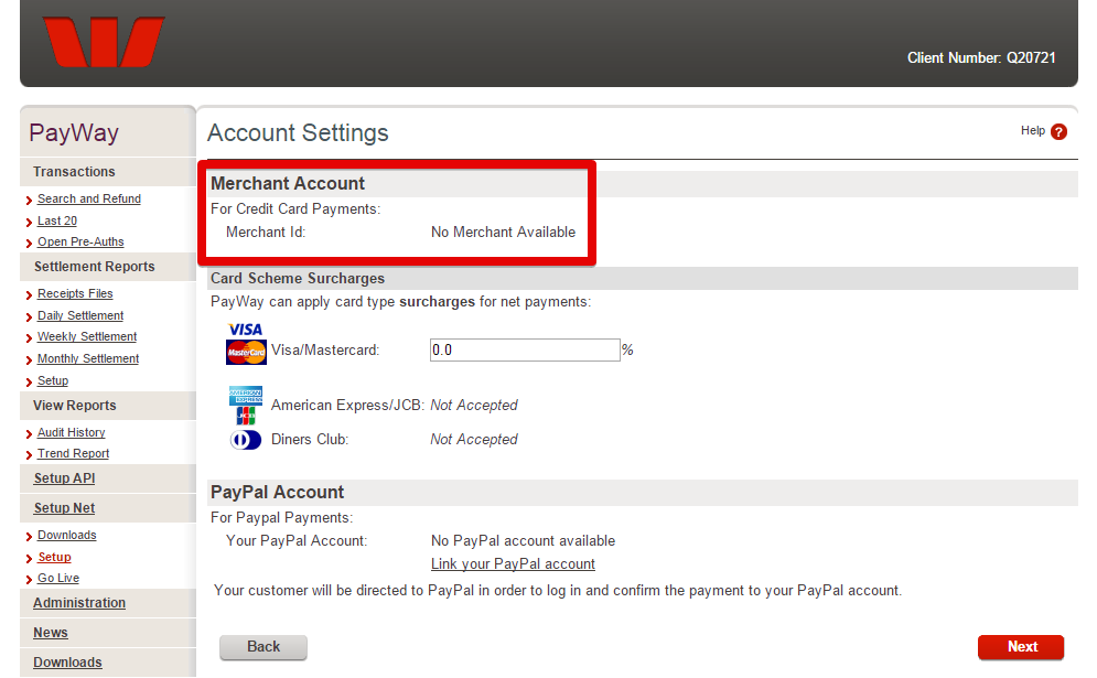

Close to the Westpac Net setting end, you will see your merchant Id, this one is facultative for testing mode but required for the production phase.

- Debug : You can enable here the debug option of the plugin which will then log the debug data in the payment log file of HikaShop.
- Allow notifications from Westpac Net : If this option is enable, the automatic response of Westpac Net server will be treated to update the order status. For example, if the payment has been completed correctly, the order status will be the specified verified status.
- Testing Mode : You can choose here to switch in testing mode (for use the Westpac Net sandbox) or in production phase, don't forget to fill in your Merchant id if you didn't.
- Invalid status : Here, you can select the status to an order if the plugin receives a invalid completion notification from Westpac Net for an order.
- Verified status : Same idea than "invalid".

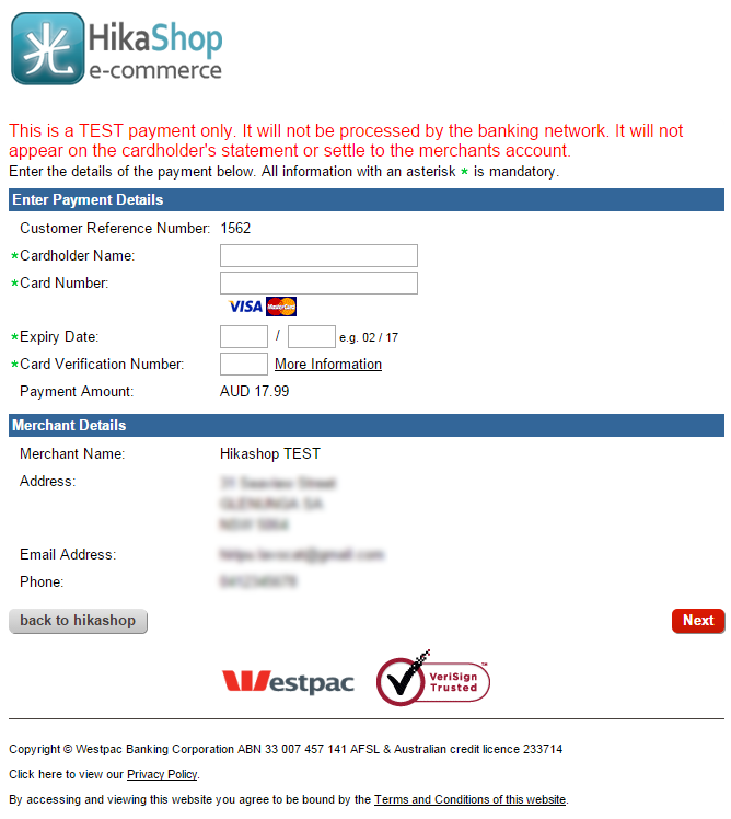

When the customer will proceed to the payment, HikaShop will redirect the customer to the PayWay payment platform.
The customer will have to fill in his credit card information, and he will see directly the transaction result, he will then be redirect to Hikashop (If you ask for it the Westpac/Payway setting page).
