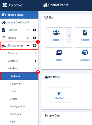

First, log in on the back-end and go to the menu Components->HikaShop->Products
Then, click on new to create a new product

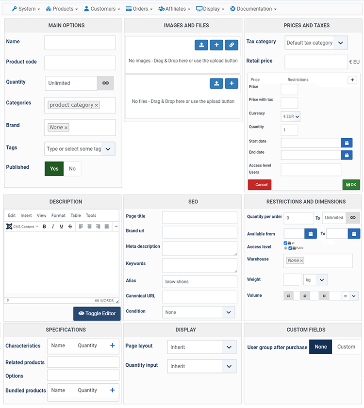

You will have to write at least a name for your product. You can also write a description, add categories, related products, images, files, characteristics, etc
By default, the published currency is the euro. If you want to use others currencies please go to the currencies management screen ( HikaShop menu System->Currencies ) to do so.
Once you're done click on the save button.

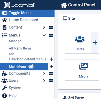

Go to the menu "Menus" and click on one of your menu areas
Then, click on new to create a new menu

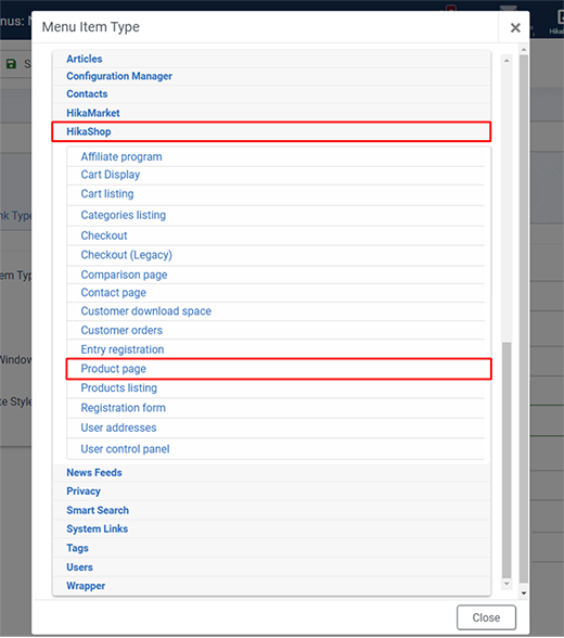

You will have to click on the menu Item Type HikaShop in order to display the list of menu types of HikaShop. Then, click on the Product "Product page" link.

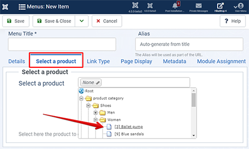

You will be able to set standard Joomla options for the menu as well as select a product to display on the right part of the screen

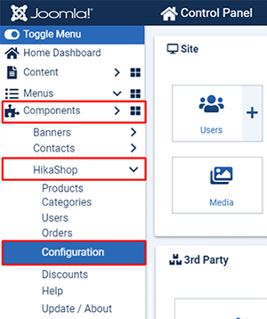

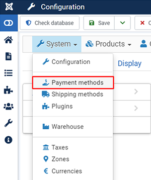

Go to the Component->HikaShop menu if you're not already in HikaShop and then go to the System->Payment methods HikaShop menu in order to access the payment management screen.

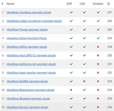

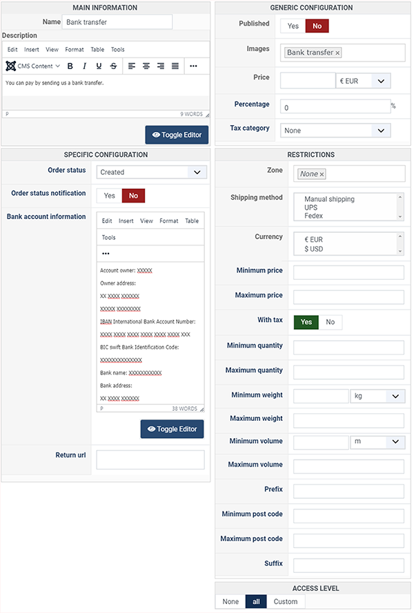

Once there you have to click on "New" in the toolbar and you should see a list of payment methods which are all unpublished. Publish one AND click on its name to edit its information. For the purpose of this tutorial we will use the payment method "bank transfer" which is easy to setup as it doesn't connect to any external payment system and thus doesn't require you to create an account on such system.
When you finish to change the default information, don't forget to enable the option "Publish" and please click on the save button. You're done with the configuration of your first payment method.

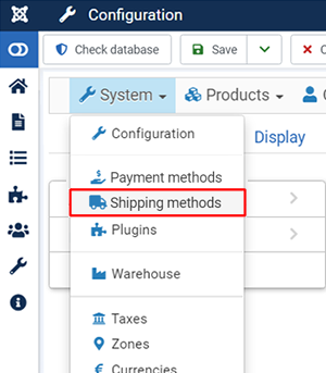

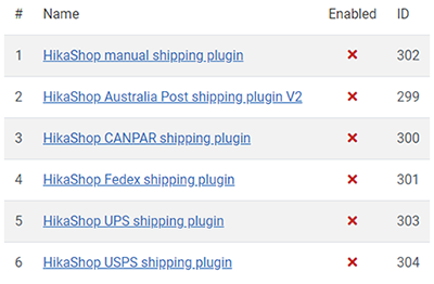

Go to the Component->HikaShop menu if you're not already in HikaShop and then go to the System->Shipping methods HikaShop menu in order to access the shipping management screen.
Once there you have to click on "New" in the toolbar and you should see a list of shipping methods which are all unpublished. Publish one AND click on its name to edit its information.

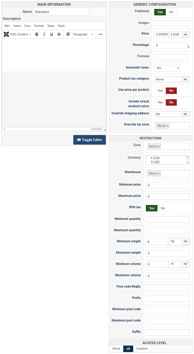

On this screen, you can enter the information of one shipping method and then click on the save button. Our demo website provides an example of shipping methods you could use on your store.

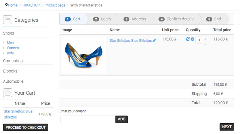

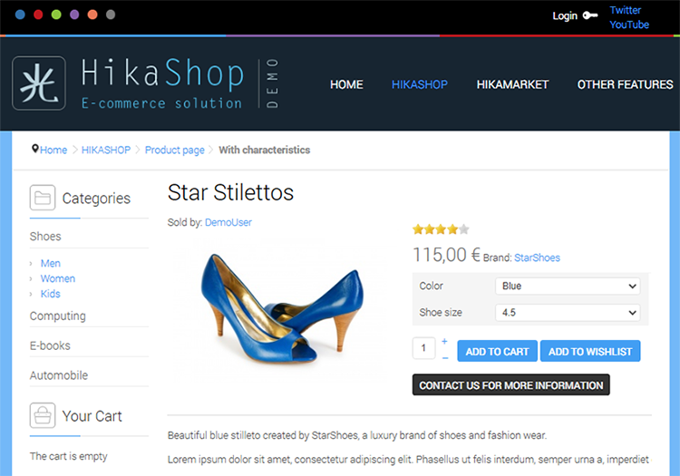

Go to the front end and click on the menu you created. The product page will be displayed.
There, click on the "add to cart" button (provided that you product isn't free) which will redirect you to the first step of the checkout process unless you have the cart module displayed (in which case it might update the cart instead of directing you to the checkout based on your HikaShop configuration).

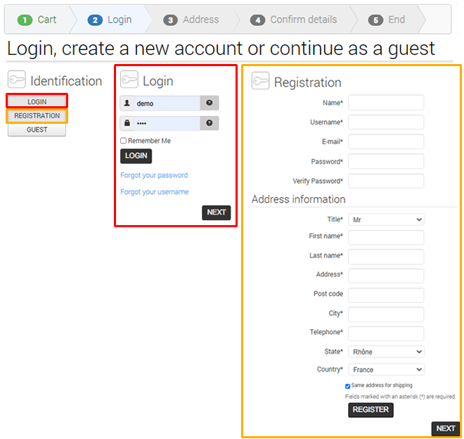

If you're not logged in, you will be asked to login or create an account. If you register, you will have to enter your address here as well which will make you skip next step.

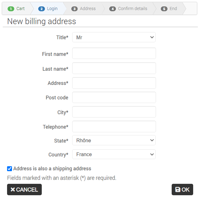

Then, you will be asked to enter an address. You can click on the new button if you don't have one already and a popup will open asking you your address information.

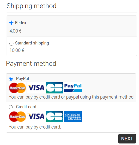

Then, you will be able to choose the payment and shipping option.

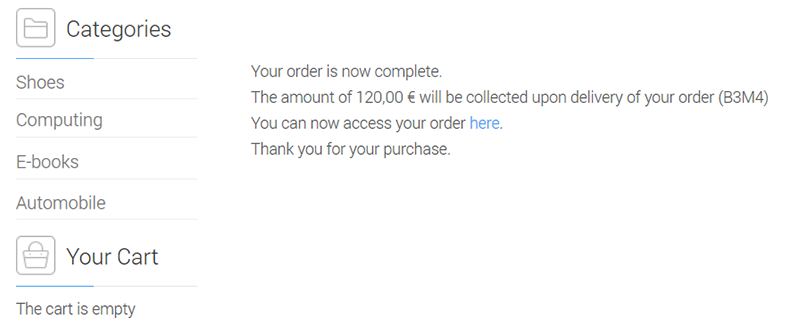

Then, you will be able to finish your order and an information screen will be displayed explaining you how to make your bank transfer if you chose this payment method.
Main menu
You should receive an email shortly after with the detail of the order.
