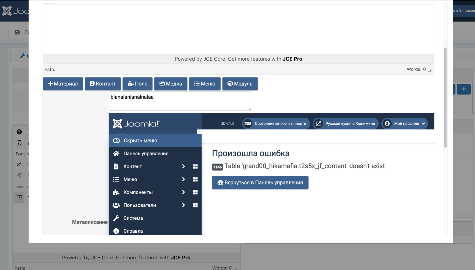

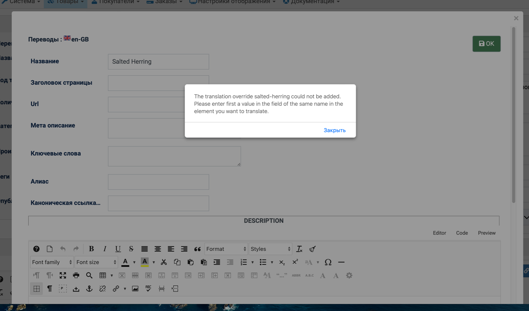

-- Error-message(debug-mod must be tuned on) -- : The translation override could not be added. Please enter first a value in the field of the same name in the element you want to translate.
just bought hikashop. I did the translation manually, but I get an error when saving. meta description, keywords and everything else is not saved
Why do three languages appear along with my main one, instead of two additional ones ???
Why does this error appear in the translation window _hikamafia.t2s5x_jf_content' doesn't exist ?
Wtf there is no documentation on creating a multilingual store ???
I am disappointed...

  • Posts: 85713
  • Thank you received: 14050
3 years 10 months ago #343183
The first message indicates that you're trying to add a translation before adding text in the main field.
So before you fill the translation popup, please make sure you fill in the main product fields.
You can't enter a translation for the product name if you didn't enter yet the main product name.
Regarding the "jf_content" table, that's a table from Falang. Are you using Falang on your website ?
Could you activate the "debug" setting of the joomla configuration and try again ? It should display an error message with more information on where the problem comes from which will allow us to tell you what to do.
There is not much documentation because normally you just have to activate the translation interface and fill in your translations for your products / categories with the new interface and that's it.

Error for sampe:
1146 Table 'grand00_hikamafia.t2s5x_jf_content' doesn't exist
Call stack
# Function Location
1 () JROOT/libraries/vendor/joomla/database/src/Mysqli/MysqliStatement.php:433
2 mysqli_stmt->execute() JROOT/libraries/vendor/joomla/database/src/Mysqli/MysqliStatement.php:433
3 Joomla\Database\Mysqli\MysqliStatement->execute() JROOT/libraries/vendor/joomla/database/src/DatabaseDriver.php:675
4 Joomla\Database\DatabaseDriver->execute() JROOT/libraries/vendor/joomla/database/src/DatabaseDriver.php:1375
5 Joomla\Database\DatabaseDriver->loadObjectList() JROOT/libraries/vendor/joomla/database/src/Mysqli/MysqliDriver.php:584
6 Joomla\Database\Mysqli\MysqliDriver->getTableColumns() JROOT/libraries/vendor/joomla/database/src/DatabaseDriver.php:1951
7 Joomla\Database\DatabaseDriver->updateObject() JROOT/administrator/components/com_hikashop/helpers/helper.php:2431
8 hikashopClass->save() JROOT/administrator/components/com_hikashop/controllers/toggle.php:107
9 ToggleController->toggle() JROOT/libraries/src/MVC/Controller/BaseController.php:735
10 Joomla\CMS\MVC\Controller\BaseController->execute() JROOT/administrator/components/com_hikashop/hikashop.php:73
11 require_once() JROOT/libraries/src/Dispatcher/LegacyComponentDispatcher.php:69
12 Joomla\CMS\Dispatcher\LegacyComponentDispatcher::Joomla\CMS\Dispatcher\{closure}() JROOT/libraries/src/Dispatcher/LegacyComponentDispatcher.php:71
13 Joomla\CMS\Dispatcher\LegacyComponentDispatcher->dispatch() JROOT/libraries/src/Component/ComponentHelper.php:389
14 Joomla\CMS\Component\ComponentHelper::renderComponent() JROOT/libraries/src/Application/AdministratorApplication.php:143
15 Joomla\CMS\Application\AdministratorApplication->dispatch() JROOT/libraries/src/Application/AdministratorApplication.php:186
16 Joomla\CMS\Application\AdministratorApplication->doExecute() JROOT/libraries/src/Application/CMSApplication.php:278
17 Joomla\CMS\Application\CMSApplication->execute() JROOT/administrator/includes/app.php:63
18 require_once() JROOT/administrator/index.php:32
Last edit: 3 years 10 months ago by Alex3.
  • Posts: 85713
3 years 10 months ago #343234
I sure can do the debugging and patching. But without the full error message or precise instructions to reproduce the problem, I'm stuck. The screenshot you gave in your last message is great. And the full error message even better. I was able to understand what is the problem. The issue is that these icons should actually not appear in the popup. These are to be used only when you're translating your content with the extension Falang, which isn't your case. So I've made a patch to remove these from the popup.
Thanks for the feedback on these.
And regarding points 1, 3 and 4 you raised, these are all coming from the same issue. The system wasn't meant to support non latin letters for the key of the translation. The patches I made earlier were incomplete. So I worked further on them and ended up adding an extra option "Non-latin translation keys" in the HikaShop configuration which I've activated on your website. That way, with that option activated, the translations work fine. So please test but it should be much better now. Thank you for your feedback on these too.
Regarding point 2, canonical URLs are generated, however, the translations of the canonical URLs is not yet supported by the system generating the canonical URLs. There is no easy fix here. It would require complex coding. I'm afraid you'll have to enter the canonical URLs for the translations manually for now.
