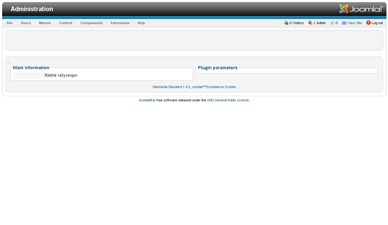

13 years 9 months ago #69023
Please find the attached screenshot and plugin file.
Please have a look at the procedure of installing the HikaSerial plugin which I've done and correct me if I'm wrong:
1. I've installed the attached plugin through the extension manager.
2. Gone to HikaSerial->Plugin section and I've enabled the Tally Serial plugin.
After clicking on the plugin, I'm getting the page which I've attached the screenshot.
Please get me some idea to get in the correct path.
Thanks,
Manjesh.
  • Posts: 83
13 years 9 months ago #69067
I've found out the solution for the issue mentioned in my earlier post. :)
