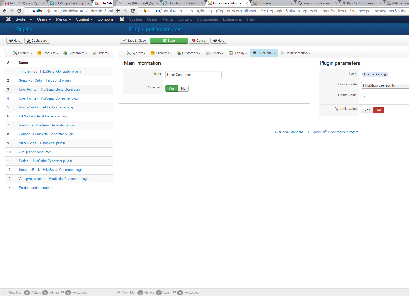

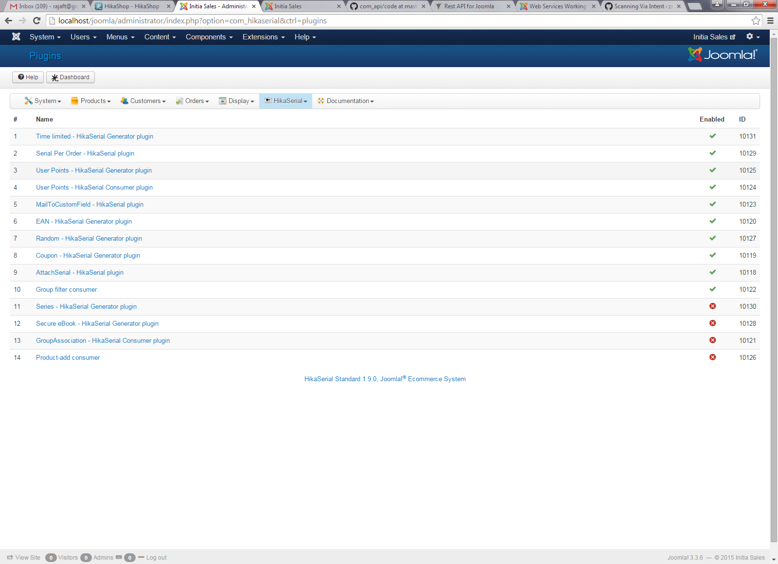

  • Posts: 15
11 years 4 months ago #192780
I have attached the plugins and it shows that I have the "points consumer" activated
I also attached the configuration of the consumer
I only tried it with the administrator account for now.

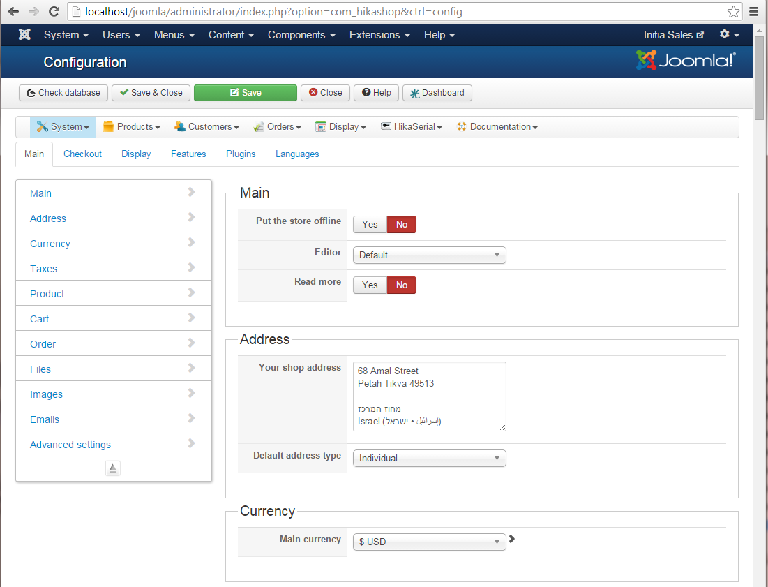

So it seems that somehow the main_currency is not defined for the above code.
I have attached the Hikashop configuration page where you can see that the main currency is indeed configured.
What am I missing?
  • Posts: 26376
11 years 4 months ago #192926
Thanks for the report ; it is strange that I didn't have the issue last time I tested it.
