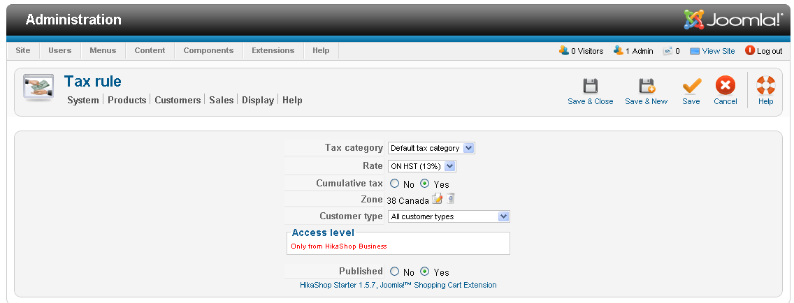

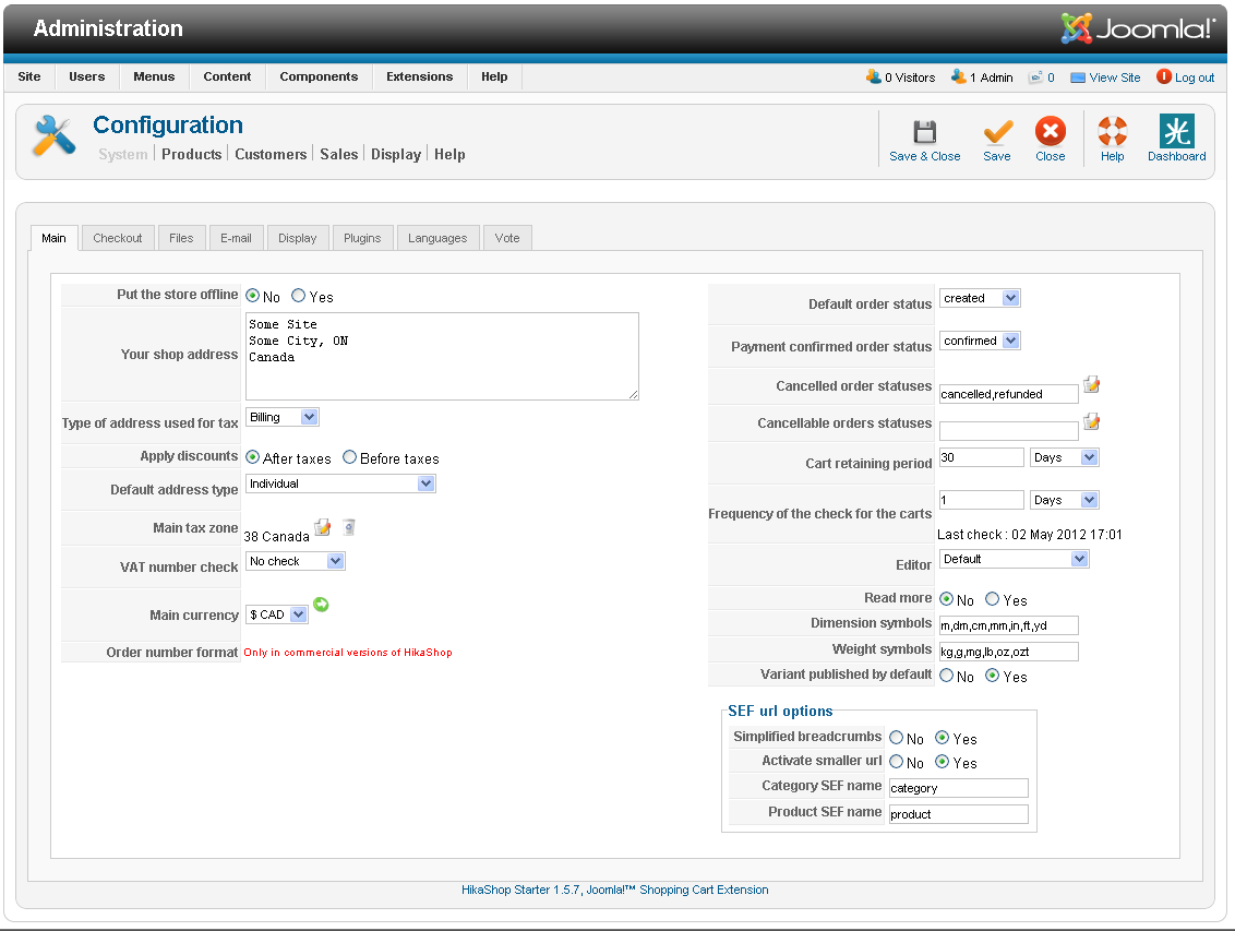

I really managed to screw things up.
No matter what I do, the tax is not showing up.
Here's what I have currently after trying to get some indication that the tax is applied:
- under System/Configuration: Main tax zone: 38 Canada (this should be Ontario really).
- under Tax category: Default tax category (no sub-categories)
- under Tax rates I have the following
Zone Tax category Rate
Canada Default tax category ON HST (13%)
(for the above I assume is the main tax zone is Ontario, the tax rate zone should also be Ontario)
This rate never showed up regardless of selecting Cumulative tax or not and yes, it is published.
What am I missing or doing wrong? Is there some other place where I have to change the configuration to make HS pickup the correct tax?
Thanks for your help.
D.

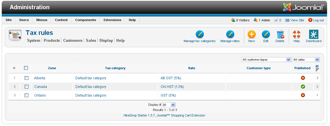

Can you do a screenshot of the listing in menu System->Tax ? Normally, you should have there your tax rules which link the tax rates, the tax categories and the zones together.
  • Posts: 9
14 years 4 months ago #49045
Here you go.

  • Posts: 86178
  • Thank you received: 14213
14 years 4 months ago #49129
That is fine. It should display a 13% tax on product prices on your front end for users not logged in or with their address in Canada if the "prices with tax" in the Display tab of the configuration and the same option in your products listings menus/modules (via the menus Display->Content menus/modules) are turned on.
The cumulative option won't change anything with your configuration. You have only one tax rule published so there is no need to cumulate the tax rates.

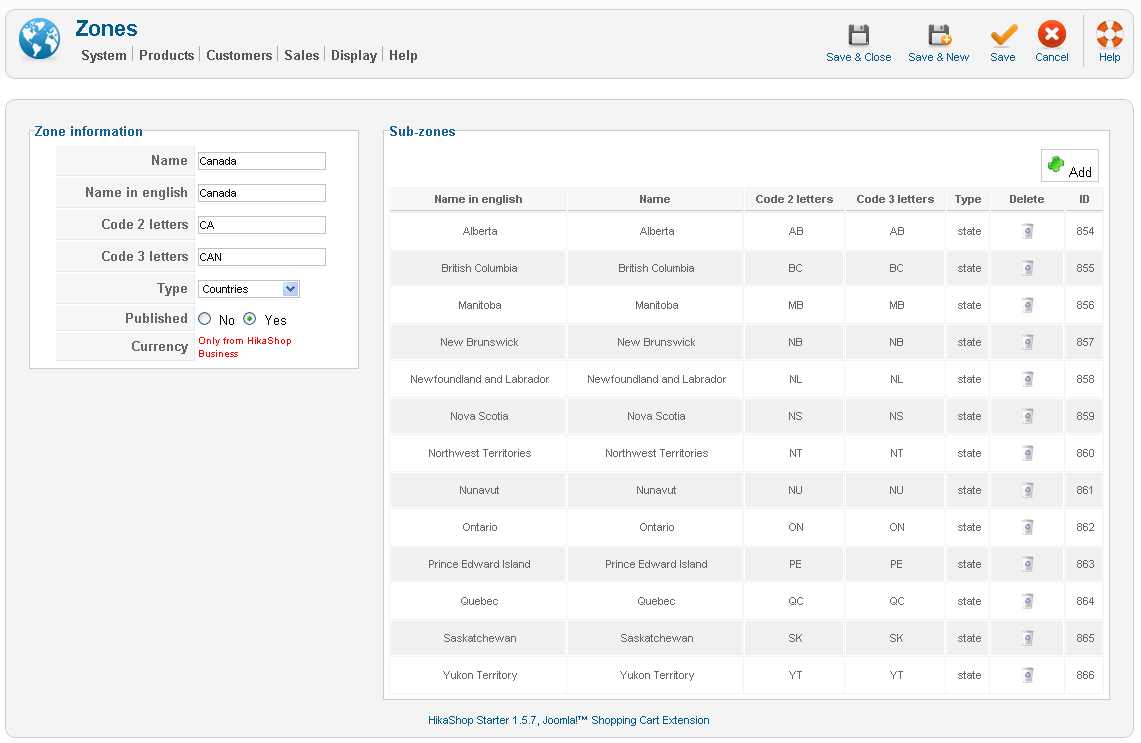

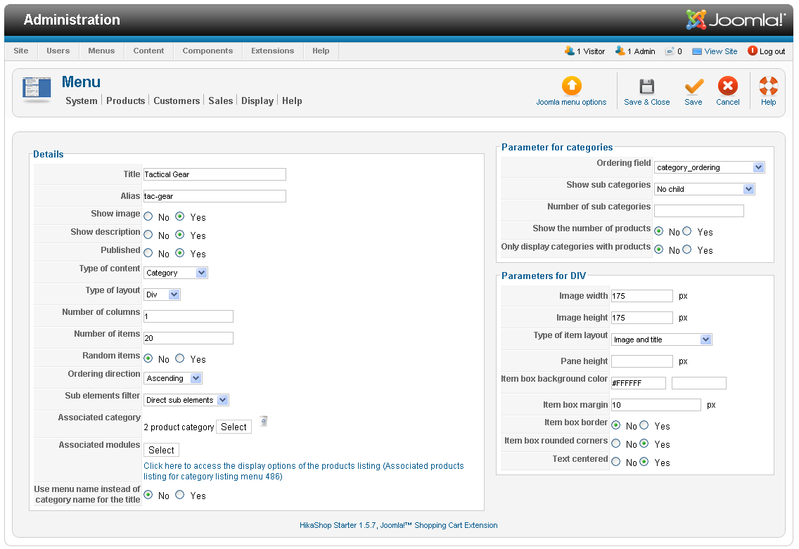

  • Posts: 9

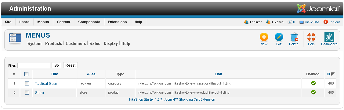

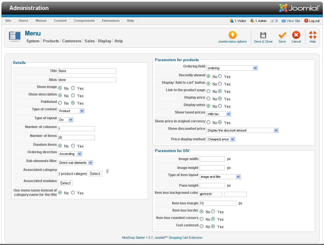

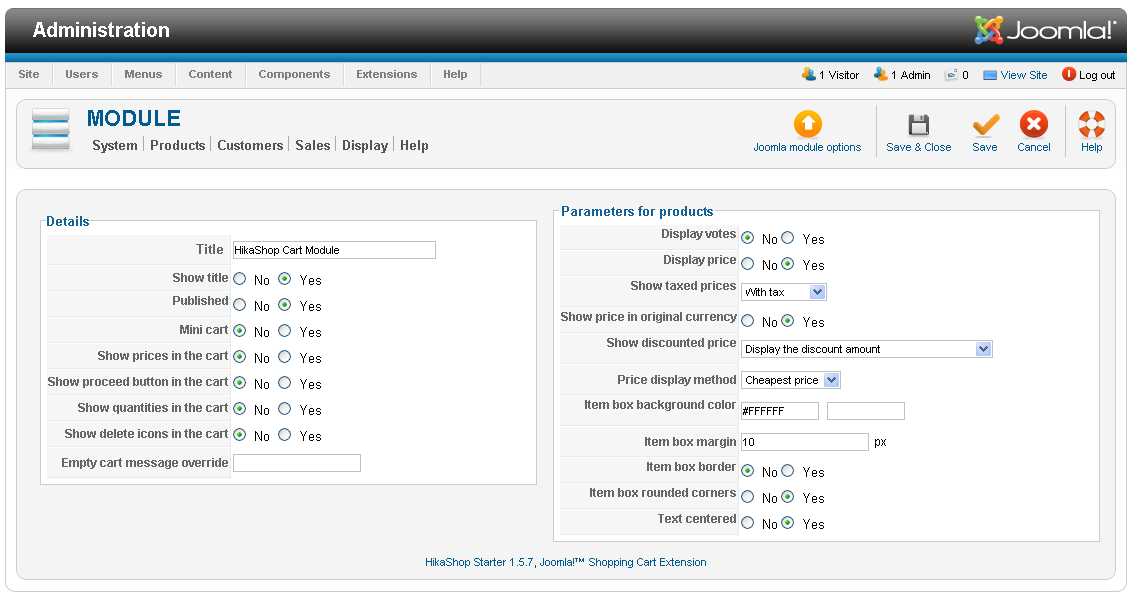

14 years 4 months ago #49163
As far as I can tell, everything look like it should.
See attached, maybe I'm missing something.
Screenshot are for Display/Content Menus, Display/Content Modules and Zones (Canada).
  • Posts: 86178
14 years 4 months ago #49254
Ok that is fine too.
