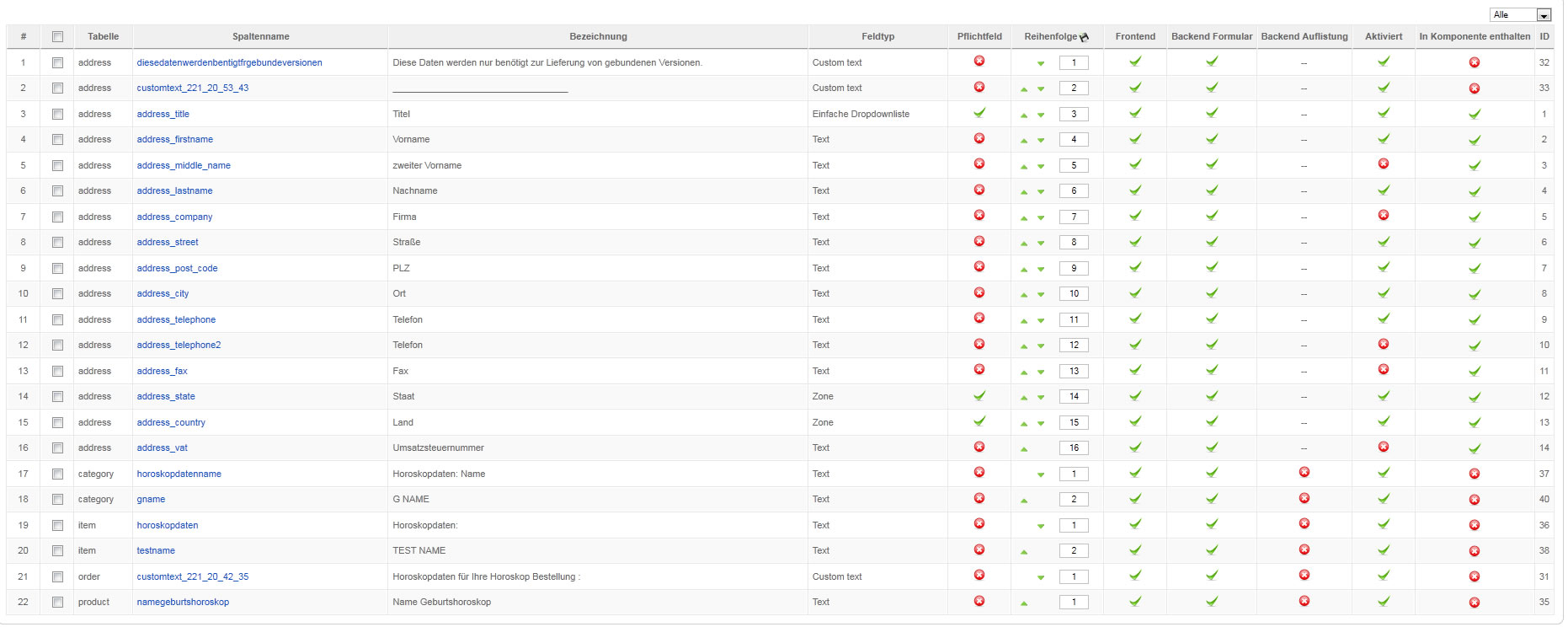

I like to create product-related fields.
I've tried many things, but do not show the fields?
Description:
When a user buy a article i need specific entry field for the product 1.
for example
1) name for the product
2) Place of birth
etc.
user buy product 2, i need the following fields.
1) Name of Partner
2) Date of birth from the partner
etc.
I have created and tested
produkt fields
artikel fields
etc.
thanks and best regards kurt
  • Posts: 86027
  • Thank you received: 14169
14 years 11 months ago #23285
You indeed need to create artikel fields (item fields). Please make sure that the custom field is published AND displayed on the front end.
If that still doesn't work, please post a screenshot of the configuration of your custom field.

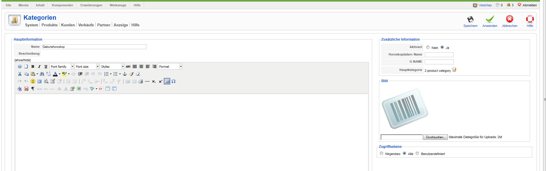

14 years 11 months ago #23352
  • Posts: 93
14 years 11 months ago #23354
  • Posts: 93
14 years 11 months ago #23355
  • Posts: 93
14 years 11 months ago #23356

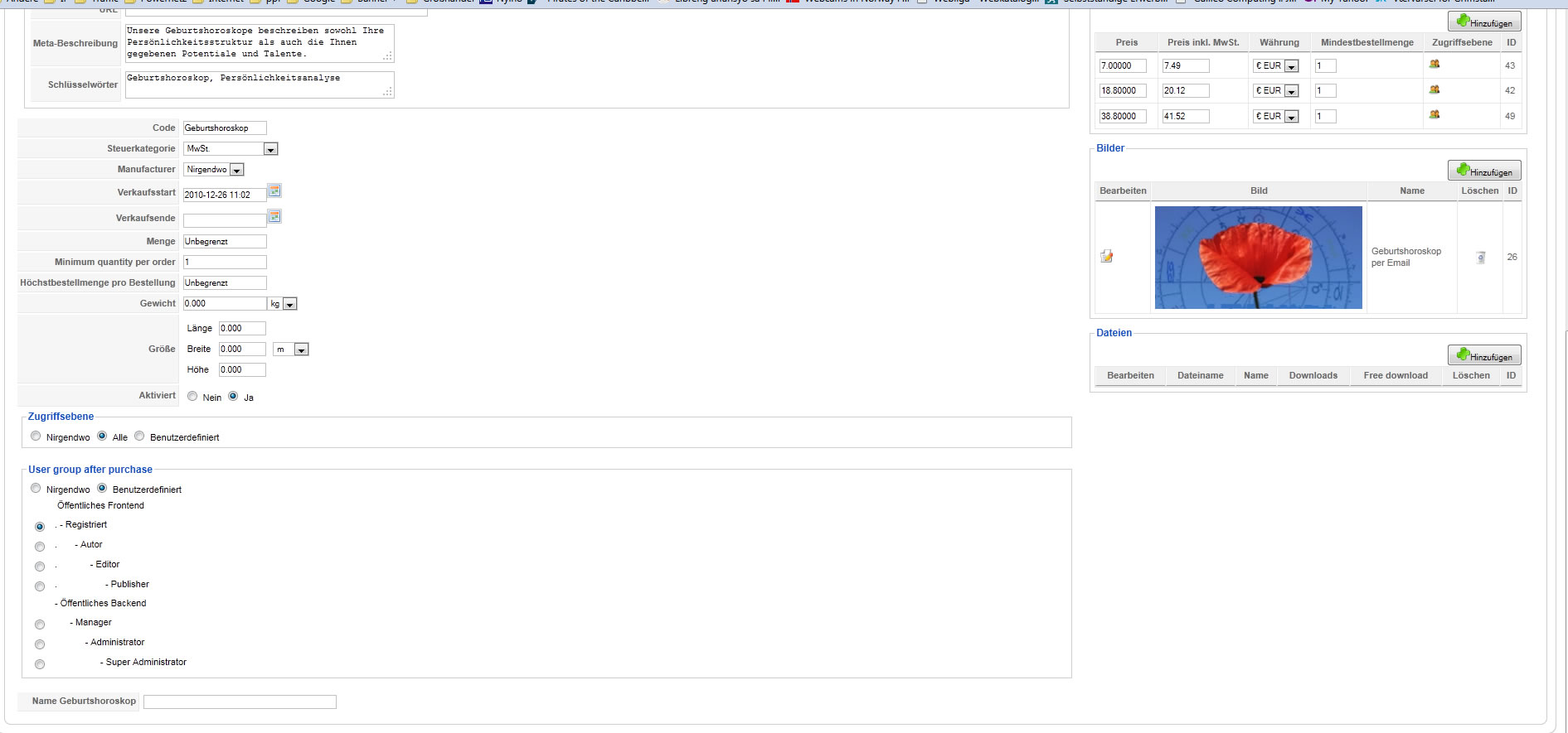

  • Posts: 86027
14 years 11 months ago #23386

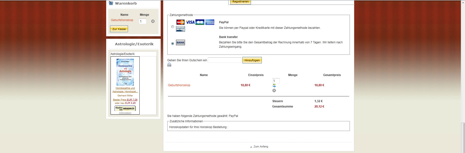

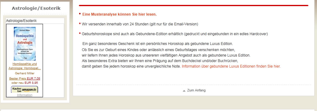

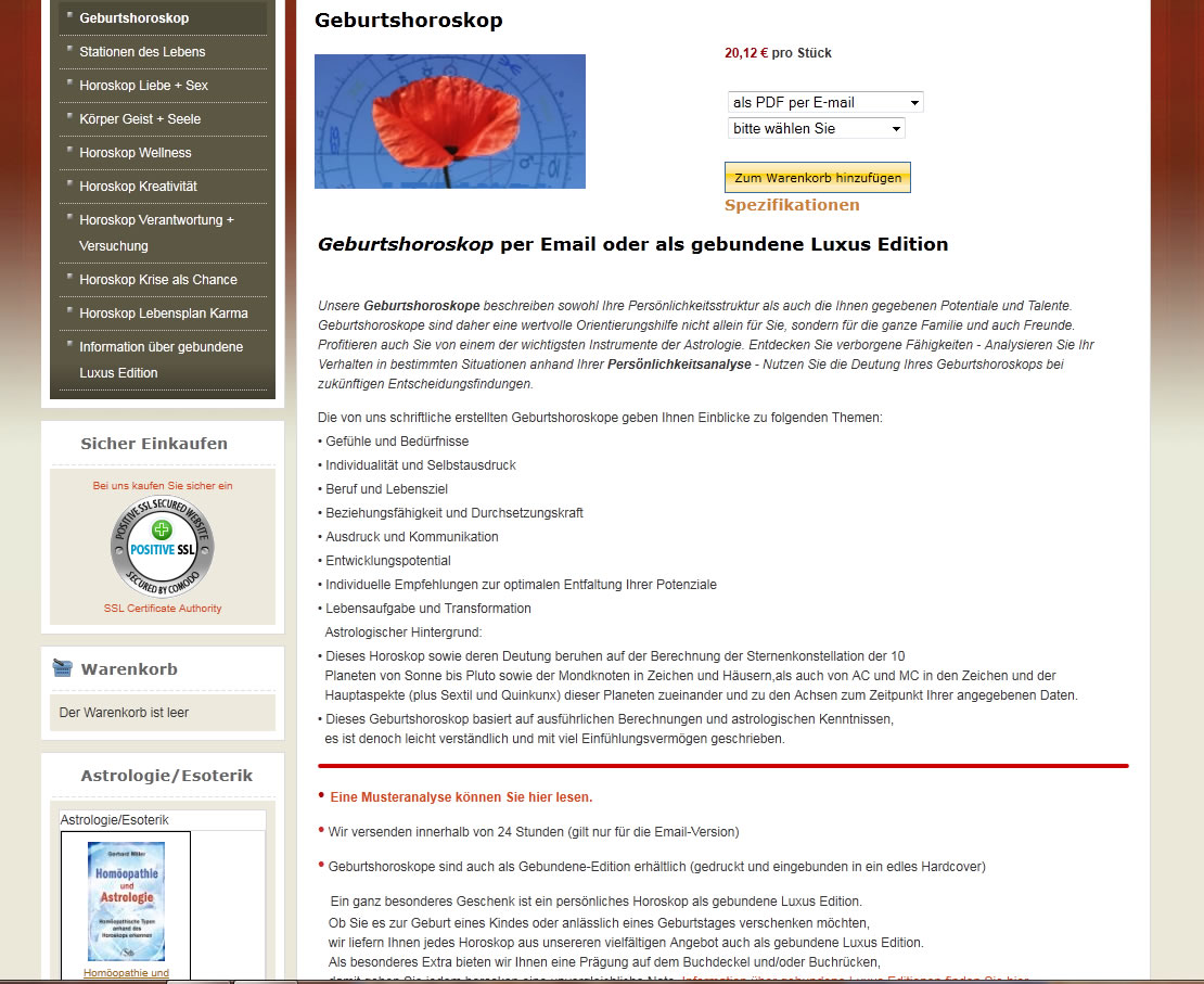

Could you do a screenshot of the product page of your product Geburtshoroskop ? You should see there the custom item fields.
  • Posts: 93
14 years 11 months ago #23408
  • Posts: 93
14 years 11 months ago #23409
  • Posts: 86027
14 years 11 months ago #23413
So I can see the custom fields on your product page.
So it means that it's working, right ? Or do you still have a problem ?

Ah I misunderstood. I thought that the two dropdowns were your cusotm fields. Could you give a back end access to your website so that we can check the problem out ?

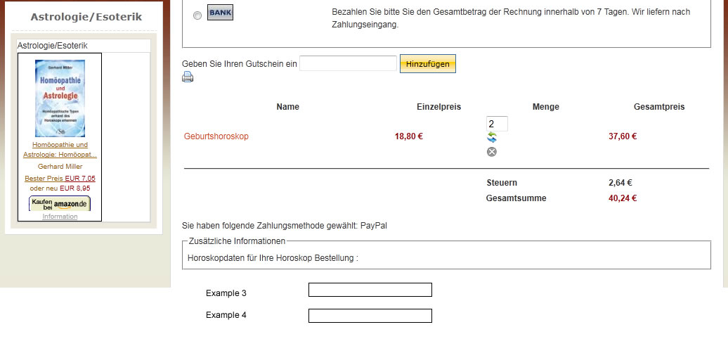

  • Posts: 93
14 years 11 months ago #23478
Here are two examples of what I want to reach
For example, a customer buy product 1
I need for this product field example 1 and example 2
Look the picture
  • Posts: 93
14 years 11 months ago #23479
For example, a customer buy product 2
I need for this product field example 3 and example 4
Look the picture

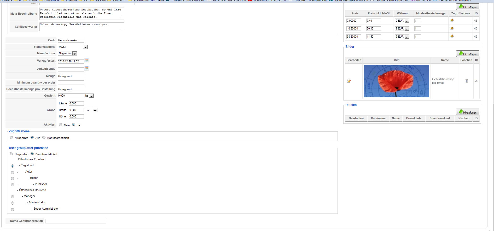

It's not possible to do the on the checkout. However, you can do that on the product page of your products with custom fields of the table item.
You gave a lot of screenshots but not the screenshot of your custom item field edition page as I asked. On your product pages you don't have your two custom item fields. It's probably because they aren't configured properly.

  • Posts: 86027
14 years 11 months ago #23492
When you create a custom field of the table item, you need to make sure that it is published, that the front end option is turned on. Then, if you don't see it on your products page, it might come from the categories restrictions of the custom field if you set any. But I can't be sure without seeing how you configured the custom field. Which is why I asked that you give us a screenshot of your custom item field options, which you still did gave. I'm talking about that page:
www.hikashop.com/en/support/documentatio...shop-field-form.html
  • Posts: 86027
14 years 11 months ago #23495
Thanks to the access you provided we found that the problem came from the category restriction you had setup in the custom item fields options.
There was actually a bug between that new functionality of custom fields and the fact that your products had characteristics resulting in the fields not being displayed.
We fixed the problem on our end and on your website. That fix will also be included in next version of HikaShop.
