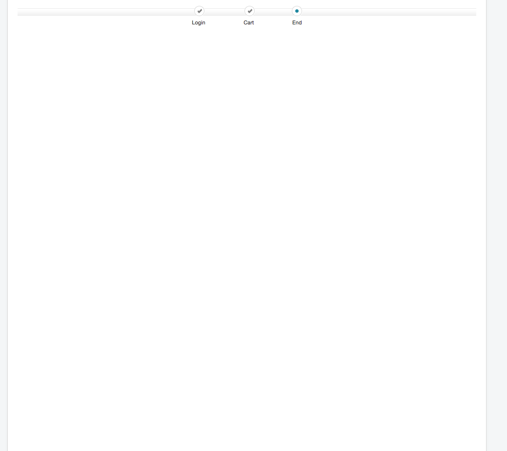

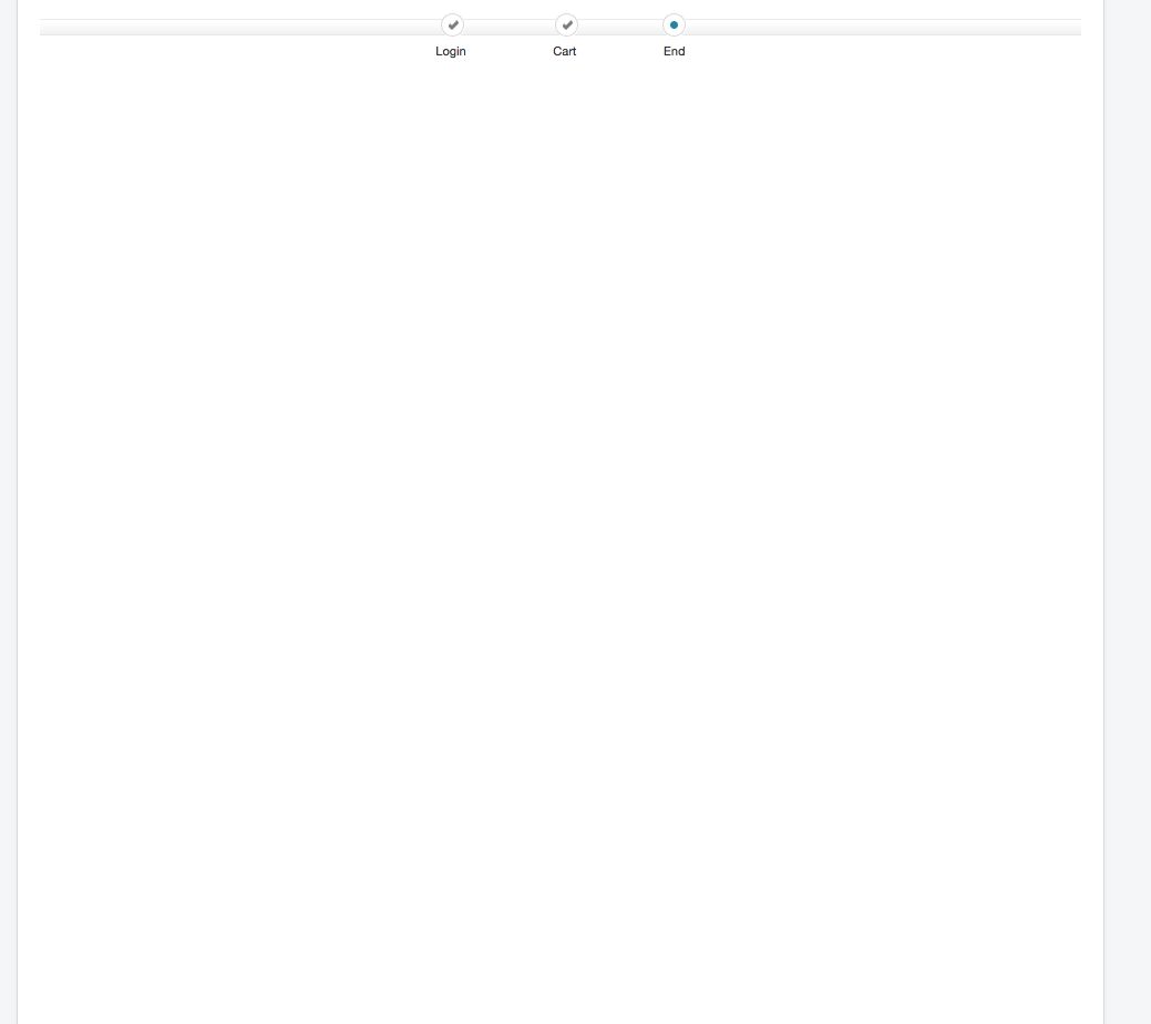

Originally the end step was redirecting to A.net and using the SIM method even though I have DPM configured in the plugin.
I changed this:
<?php if ($this->payment_params->api == 'dpm' && @$this->payment_params->iframe ){
		$url=urlencode(base64_encode(json_encode($this->vars)));
To this:
<?php if ($this->payment_params->api == 'dpm'){
And, now the end step is not redirecting, but instead its correctly trying to load the iframe on the page. The issue now is that the iframe is empty.

Thank you for your response. Ok, ok bad example. My point is that this isn't resolving to true:
- @$this->payment_params->iframe.
I do see in authorize.php that if the api is not == 'aim' then iframe is set to 1, but in authorize_end its not 'true'.
Also, I did actually review the iframe code via my browser inspector (ie, firebug). The target URL looks correct, but the form is not populated in the body of the frame.
target URL:
index.php?option=com_hikashop&ctrl=checkout&task=notify&notif_payment=authorize&tmpl=component&lang=en&Itemid=465&iframe=long_encoded_gobbidy_gook
iframe size: 660 x 1000
3by400, Inc.
3by400.com
Websites that Work, Marketing that Matters
Last edit: 11 years 6 months ago by 3by400.
