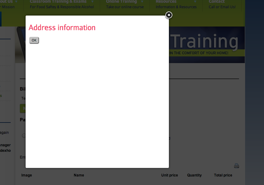

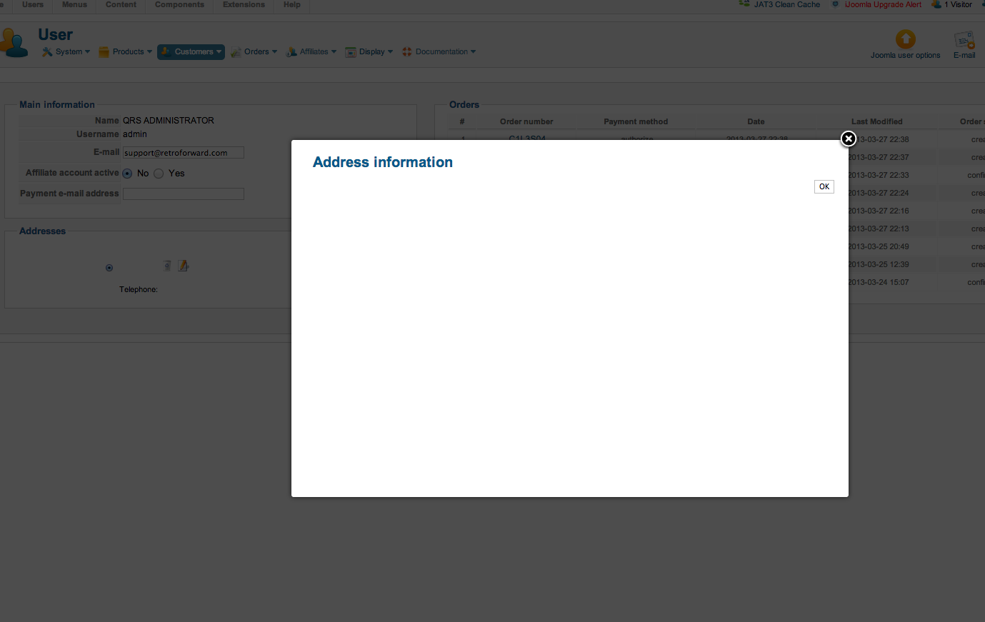

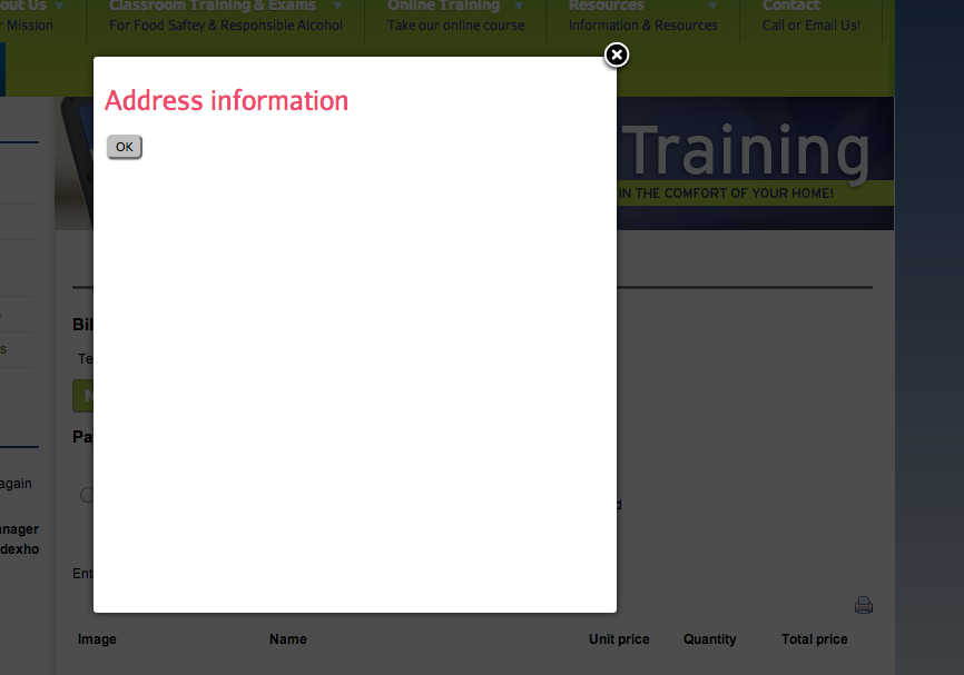

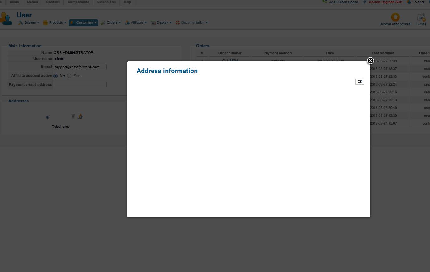

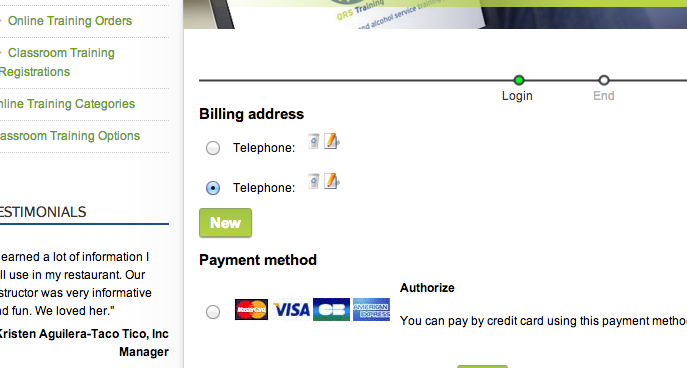

I am having trouble with address also. I am not sure if it related to this topic, but it seems similar.
Right now, there is no way to ever your address. when I click on the NEW button, the pop up is blank. it's doing it on the front end and back end. Please see the attachements. The only things I see is the word "address" and the "OK" button.
When I press the "OK" button, if create an entry for Telephone.
Hikashop is installed here: www.qrstraining.com/index.php/online/category . please message me privately for login details if you need to take a look. thanks.
I am stumped what is causing thing. Thanks in advance for any help you can provide.

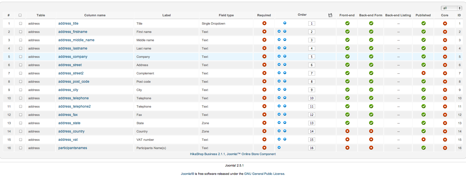

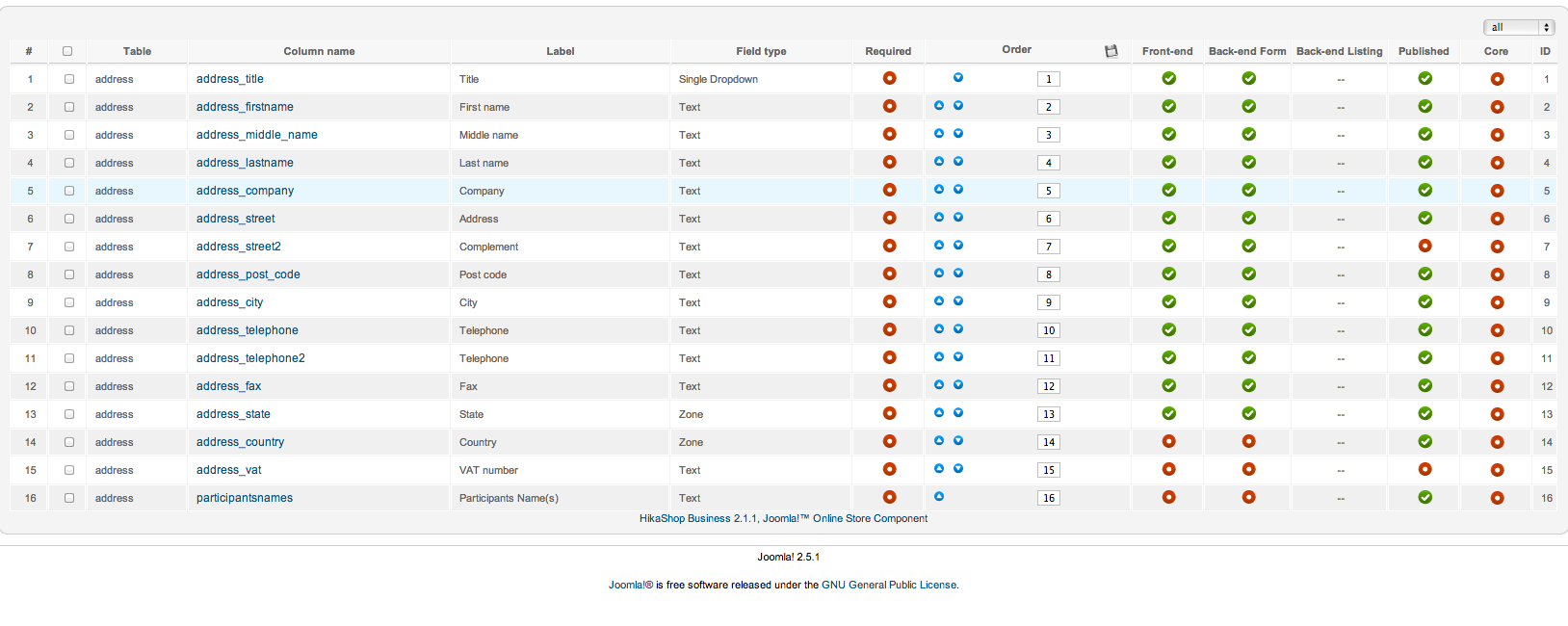

  • Posts: 4
13 years 4 months ago #96792
this is how my fields are configured
13 years 4 months ago #96823
Ok, when I'm going through your checkout the popup is disabled, and I'm being redirected to a page where I can fill my information, so I don't have any popup.

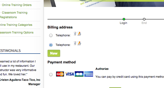

Yes, the regular joomla site registration works. It uses the community builder form.
The problem is in Hika shop. there is a problem for our customers who have not registered for our site, and they need to purchase something. They cannot put in their address or any other contact details. Please see this video link below that illustrates our problem. If we cannot resolve this, we cannot use hikashop, and we'll need to ask for a refund. thanks.
Attempting to update or add address on backend
www.youtube.com/watch?v=ZQMtHGRd6vI
Attempting to add address on front end
youtu.be/Iv_4JaHeCq8
I really want to get this up and running and this is the last thing we need to work in order to make this shop live.
thanks.

13 years 3 months ago #100682
I checked your settings and I see that you edited each custom address field via the menu Display->Custom fields and changed their access level from "all" to "custom" without selecting any use group, which means that they are accessible to no one and thus that's why you don't see them.
Please change their access level to "all" as it is by default and you will see your address fields everywhere as it should be.
