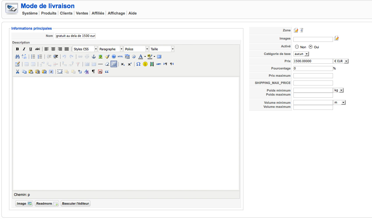

Could you make a screenshot of the manual shipping methods plugin's edition/creation screen ?
  • Posts: 107
15 years 6 months ago #7165
Sure here it is :
So I've got a field price "prix" (unless that's the same as minimum price) and a maximum price

15 years 6 months ago #7167
So you have all the fields. It's just that there is a mistake in the french translation file.
It's actually:
SHIPPING_MIN_PRICE="Prix minimum"
SHIPPING_MIN_PRICE="Prix maximum"
Where it should be:
SHIPPING_MAX_PRICE="Prix maximum"
You can go in the config under the tab languages to fix it.

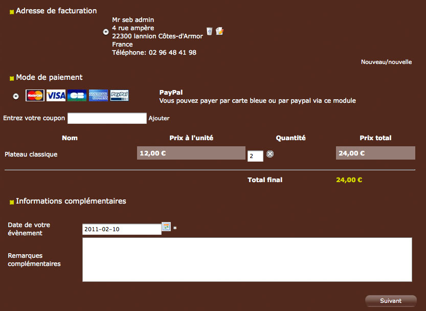

  • Posts: 107
15 years 6 months ago #7175
Arff ... another stupid question (I'll have asked all of them... you'll be able to create a fasq (frequently asked stupid questions) after me)
So I created a zone for an all country (as a test)
I defined : minimum price and maximum price and I defined a shipping price.
the setting is activated. plugin is published but I don't have any shipping during the payment ... did I forget something ?
Another thing ... (the only payment I've got is paypal) when I ckick on "next" I have to actually click twice on next .. the first time it sends me on the checkout page (the same)
any ideas ?

15 years 6 months ago #7176
You need to set a weight in your products, otherwise, they will be considered as virtual goods.
You shouldn't have to click twice on next unless you changed the checkout workflow option in the config. Did you ?
  • Posts: 107
15 years 6 months ago #7177
I really didn't think about that !
Nop didn't change a thing in "the checkout workflow options" ...
I'll firts look a the wieght thing .. maybe both problems were linked ... I agree one of them wasn't a problem just my mistake
  • Posts: 107
15 years 6 months ago #7285
Seems to work fine now ... so it was probably all related
