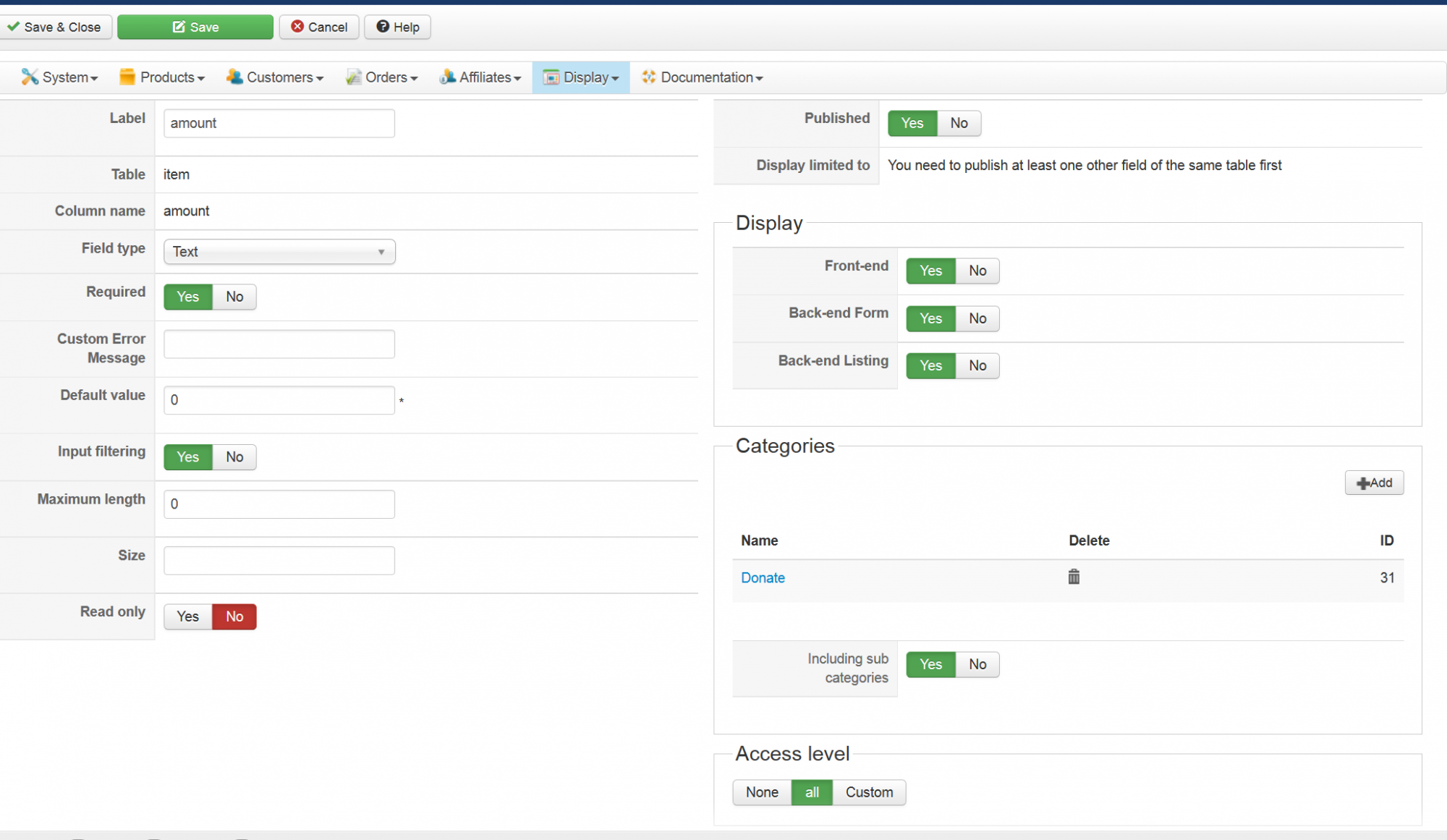

11 years 5 months ago #185773
Do you have named the custom field "amount" ?
Please give us more details on the settings, etc.
  • Posts: 59
11 years 5 months ago #185789
Yes here is a screen capture
  • Posts: 85786
  • Thank you received: 14079
11 years 5 months ago #185796
So did you configure a product in that "donation" category ? Can you provide a link to that product's product page ?
