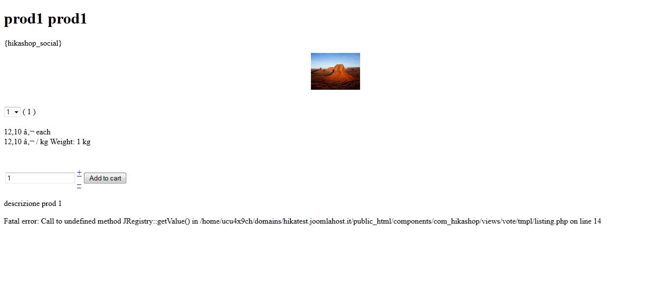

Another issue: when I click over the image of a product in the hika modules (best sellers, top rated, etc..) it redirects me to a not well formatted page, see image attached, and give me this error: Fatal error: Call to undefined method JRegistry::getValue() in /home/ure4x9ch/domains/xxxxxx.yyyyyyy.it/public_html/components/com_hikashop/views/vote/tmpl/listing.php on line 14

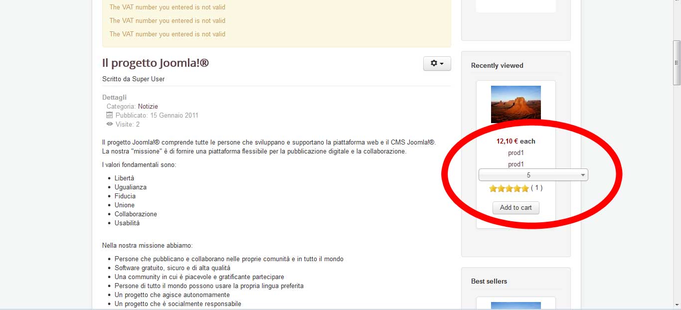

Another issue for module dropdown list: see attached image.

  • Posts: 86178
  • Thank you received: 14213
13 years 10 months ago #73381
Here is a new package which fixes the VAT and the fatal error for the votes.
For the votes dropdown being displayed, we don't have the problem on our end.
Could you give a link to that page so that we can see it ?
I'm thinking that there might be a javascript error on your website resulting to that dropdown being displayed.
The topic has been locked.

  • Posts: 26386
  • Thank you received: 4078
13 years 10 months ago #73402
The problem comes from javascript execution.
Chosen was initialized before hikashopVote so, the chosen dropdown was displayed.
I made a patch which would delete chosen dropdowns is there.
So the bug is fixed (and would be included in the next zip file).
