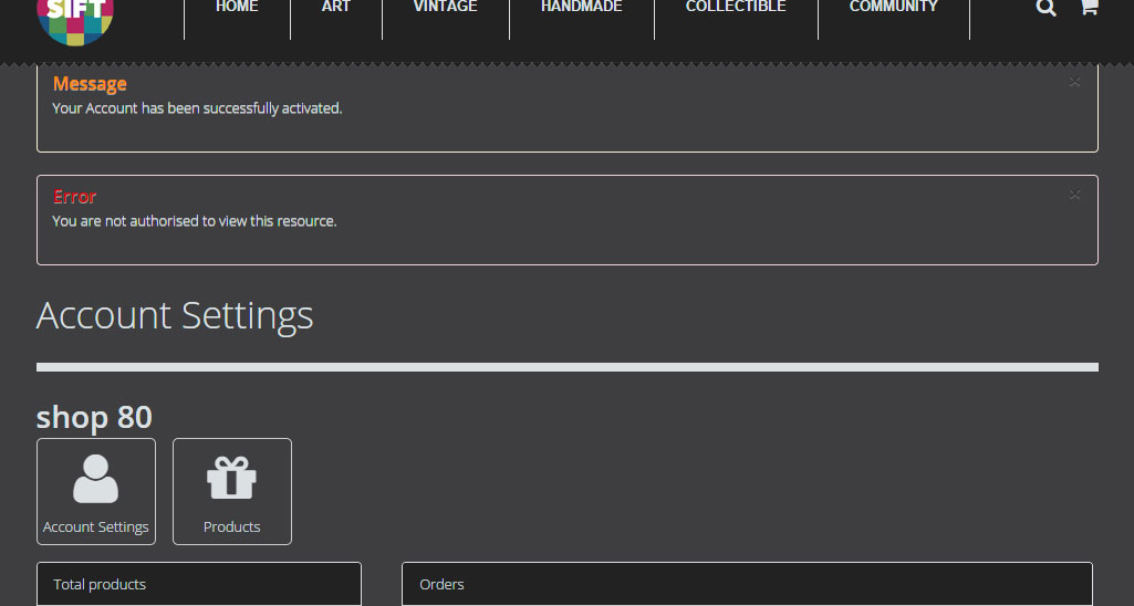

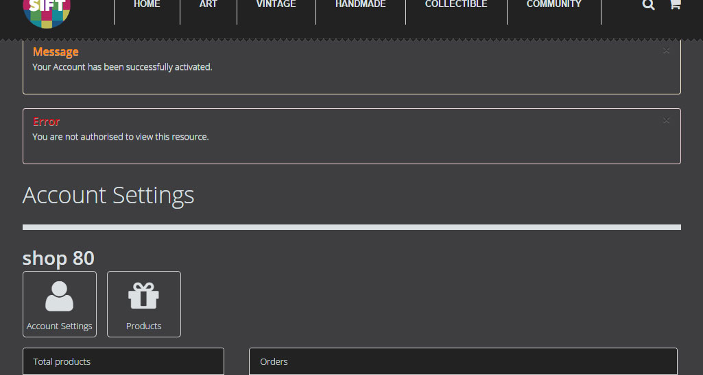

11 years 9 months ago #179925
Hi Jerome,
when registering as a vendor everything works fine - I have it set to put vendors in the correct usergroup (and that works)
it redirects to the vendor control panel upon clicking the authorise email link (which is fine) but it shows the error "you are not authorised to view this resource"
obviously I am in the control panel and have access to everything wih no problems
any idea what is causing this?
  • Posts: 26381
11 years 9 months ago #179961
This message is not display directly by HikaMarket ; it's a Joomla message.
I'm trying to figure it out how Joomla could display this message and when.
The "activate" controller does not have ACL restriction on it ; and after it activates the users, it try to make a login and then, redirect the user to the vendor control panel.
Because the vendor control panel is display, I think that you do not have ACL on the vendor menu...
Maybe checking the browser "network log" can be interesting in order to see if there are more redirection.
Otherwise, it might be necessary to modify temporally the Joomla core in order to get a trace of the moment when Joomla put this error message in the message queue (with the PHP call stack, to find the source).

I'll give that a go
the "you are not authorised to view this resource" appears to have been solved by upgrading Joomla to 3.3.6, Some sort of redirect error with the Joomla core login...
cheers
