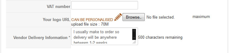

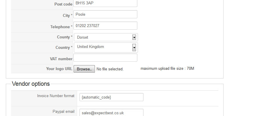

Hi I have a logo field for the vendor as i would like to display this at the top of their page however when i browse and upload an image it says it has saved with success however i cannot see any sign of the image on the front end or backend so i am not sure how to tackle it without looking to you guys to advise?
  • Posts: 26381
12 years 6 months ago #140818
You have some javascript errors in your page.
You should have the dynamic uploader and not see this HTML upload input field.

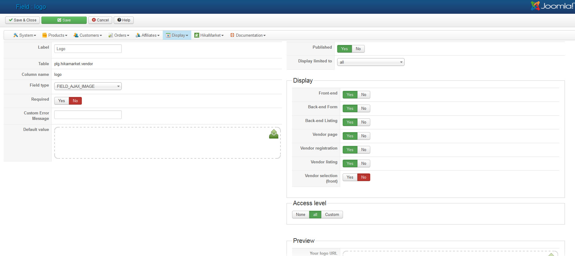

I though you were talking about the "vendor image" which is above in the vendor page.
Could you please provide the screenshot of the custom field configuration ?
Maybe using the new custom field type, "ajax upload image", could be useful.
But the original "file" custom field should work so having your configuration will help us to try to reproduce your problem.

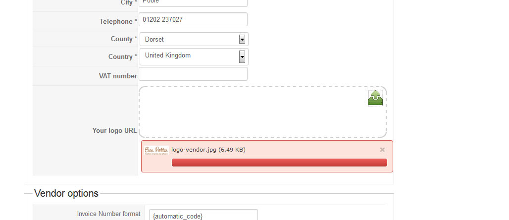

  • Posts: 377
  • Thank you received: 7
12 years 6 months ago #140848
Sure please find attached i have tried the ajax uploader which looks better anyway but just seems to stop once uploaded.
Kind regards

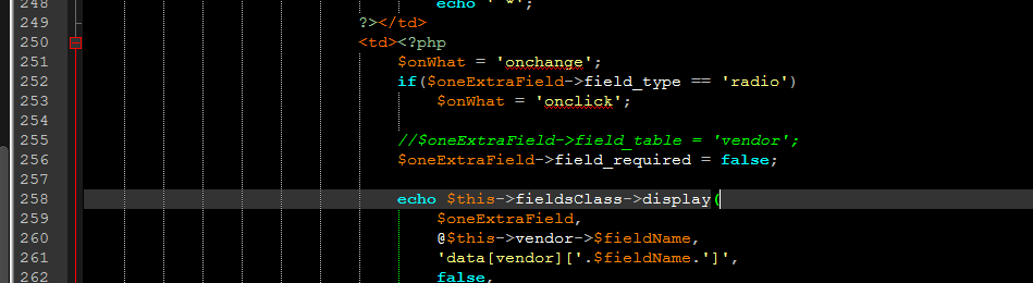

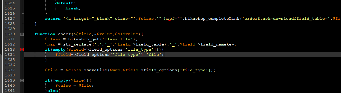

First, in HikaMarket, in the view "administrator/components/com_hikamarket/views/vendormarket/tmpl/form.php" replace
	$oneExtraField->field_table = 'vendor';
	$oneExtraField->field_required = false;
By:
	//$oneExtraField->field_table = 'vendor';

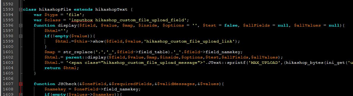

In HikaShop, for the class field ( administrator/components/com_hikashop/classes/field.php ) replace for "hikashopFile"
		if(!empty($value)){
			$html.=$this->show($field,$value,'hikashop_custom_file_upload_link');
		$map = $field->field_table.'_'.$field->field_namekey;
		$html.= parent::display($field,$value,$map,$inside,$options,$test,$allFields,$allValues);
By
		if(!empty($value)){
		$map = str_replace('.','_',$field->field_table).'_'.$field->field_namekey;
And
	function check(&$field,&$value,$oldvalue){
		$class = hikashop_get('class.file');
By:
And it will work for the classical file/image custom fields.

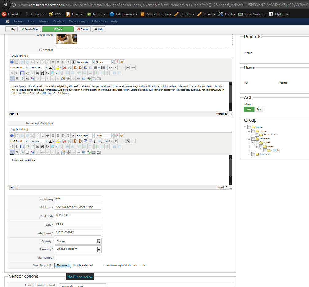

12 years 6 months ago #144789
Sorry for the delayed response we have been on other projects. I have tried your implementation however it just displays the filename not the image. This is when i set the field type to 'image' and/or 'file' and as you mentioned ajax doesn't work either.
www.warestreetmarket.com/newsite/Artist/...w/2-alex-dibben.html
Then when i click on it it takes me to the orders page which is very strange behavior.
I am pretty sure i copied all your code correctly.
Kind regards
Alex

12 years 6 months ago #144850
I am pretty sure i have done them all, i have attached screen shots of all the changes according to your 3 you mentioned previously. Please let me know if i have missed anything by mistake?
