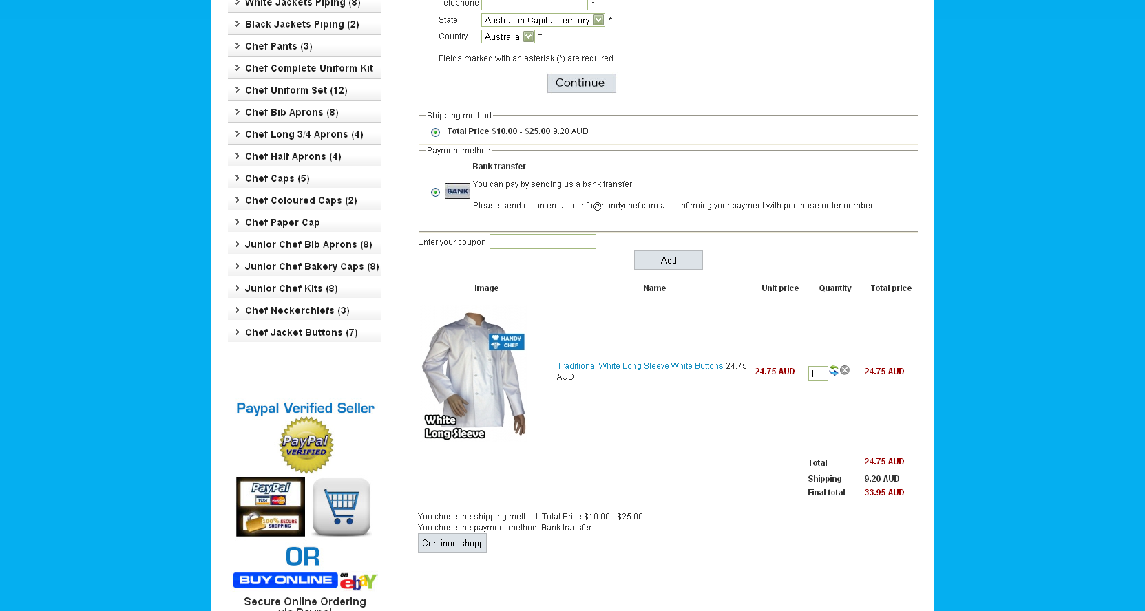

I recently had Paypal payment option disappeared in our hikashop powered site today. Before that and yesterday it displayed fine. My client advised me that she played with the country in settings so I was wondering that could cause this issue where the Paypal option disappeared? I already followed the list of possibilities to rectify the issue but had no success.
Anyone can help with that to fix the issue?
(see attached screenshot with "paypal" option missing)
