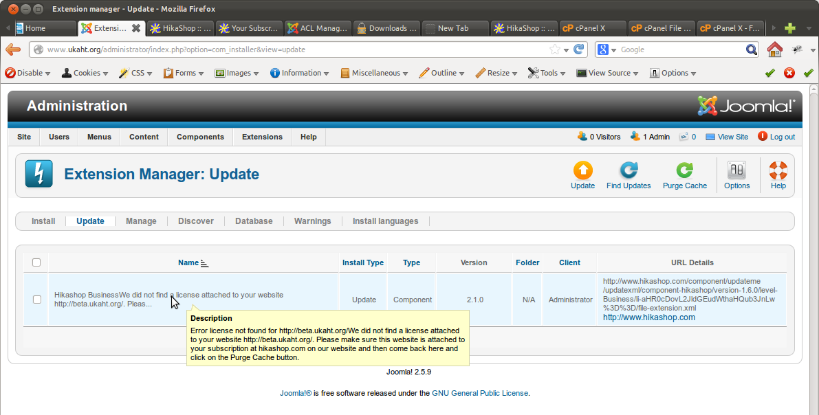

  • Posts: 31
13 years 7 months ago #89589
I tried this too. configuration.php on the root of the live site has no reference to beta whatsoever. The variable $host (which I assume is where this might be set) is as below:
public $host = 'localhost';
configuration.php no longer exists on the beta site.
See the attached, just to be sure I am explaining things correctly (and yes, this is after I have purged the cache).
Steve
  • Posts: 86181
13 years 7 months ago #89620
Ok, I know what it is. That's because the data in the database of Joomla is not up to date.
In recent versions of HikaShop, that will be updated automatically when you access the HikaShop configuration and the problem won't happen. But that was not the case with HikaShop 1.6
So the solution for you would be to manually update to not have the error anymore (you can do that by downloading the package via the menu Help->Update of HikaShop and installing it via the joomla installer.
The following user(s) said Thank You: SteveEvans
  • Posts: 31
13 years 7 months ago #89678
I can confirm that this last suggestion seems to have solved the problem (although I cannot be sure until there is another update!). Many thanks.
Steve
