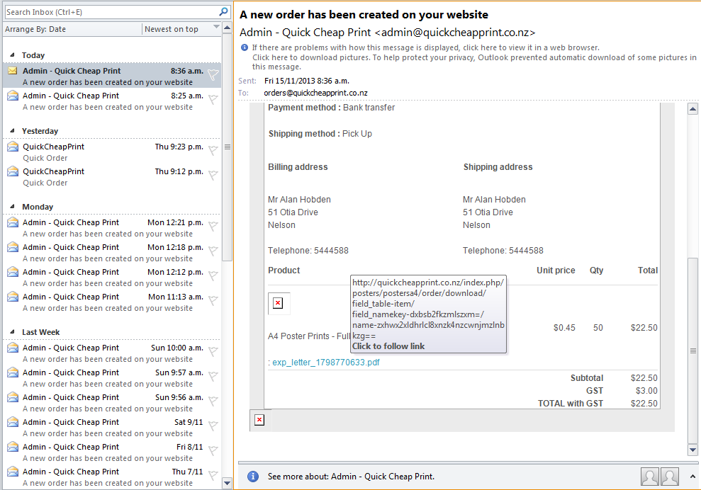

ok, that didn't work. Here is the difference between links from a old order that worked and a new one that doesn't.
WORKING LINK:
www.quickcheapprint.co.nz/administrator/...bV81OTkzODk3NTEucG5n
NOT WORKING LINK THAT WE GET NOW:
www.quickcheapprint.co.nz/index.php/pape...X18zMDU2ODMyNzEucGRm
Does that help you?

  • Posts: 118
12 years 8 months ago #132296
Sorry about that, seems when I saved the email as a PDF it did some wierd format.
The email is the notification email sent to the administrator to say there has been an order created on our website. It has a summary of the order and a link to the file the user has uploaded as part of their order.
(we are a printing business so when a user makes a order, they upload their print file as part of the order).
We then try to click on the link to get the file - this is where the problem is.
I have attached a new PDF of the email, this one will work :)

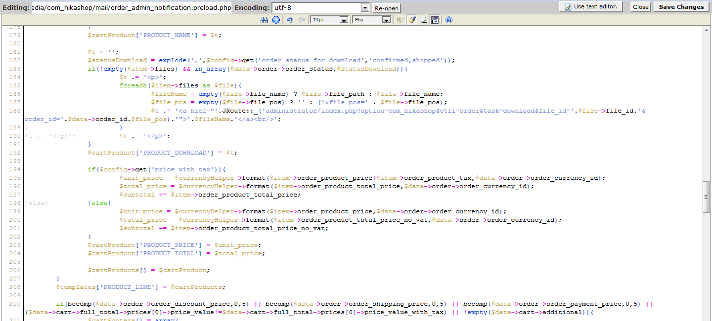

In the file "media/com_hikashop/mail/order_admin_notification.preload.php", you will find this line:
$t .= '<a href="'.hikashop_frontendLink('index.php?option=com_hikashop&ctrl=order&task=download&file_id='.$file->file_id.'&order_id='.$data->order_id.$file_pos.$url_itemid).'">'.$fileName.'</a><br/>';
You can replace it by:
$t .= '<a href="'.JRoute::_('administrator/index.php?option=com_hikashop&ctrl=order&task=download&file_id='.$file->file_id.'&order_id='.$data->order_id.$file_pos).'">'.$fileName.'</a><br/>';
and it should work.

  • Posts: 118
12 years 8 months ago #132488
Unfortunately it didn't make any difference, the link is still the same as mentioned previously. Its like its not even looking at that code...
I have attached the screenshots so you can confirm the code is correctly inserted. Also showing the email link.
