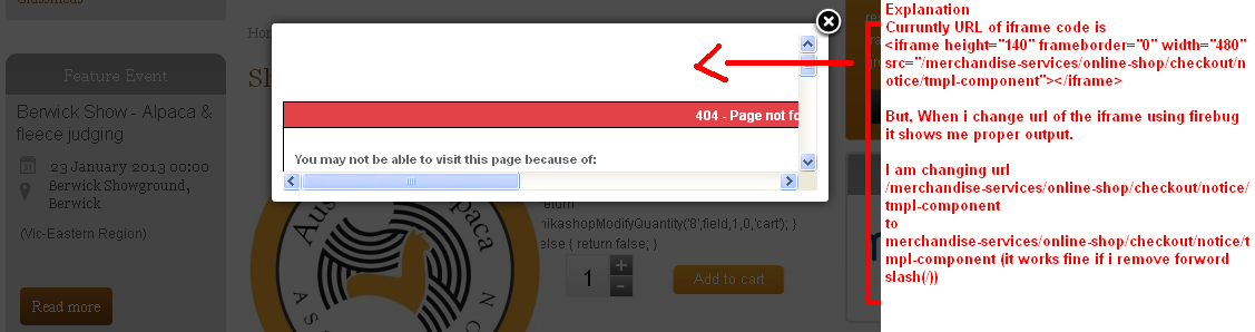

Let me explain visually.
Here i attached image. kindly check that image.
Last edit: 13 years 7 months ago by Hariyani.
