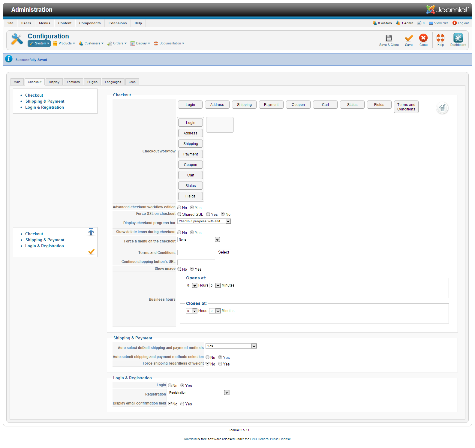

I think this behavior is normal according to your Hikashop configuration.
There should just be an error message showing there to tell the customers they have to validate their account by clicking the link the email sent.
Could you give us a screenshot of you register configuration (System>Configuration>checkout>login & registration) and tell us if you did something to hide joomla's messages?

SO can somebody please help me fix the problem. I have posted a screenshot of my configuration as requested and no one has responded since.

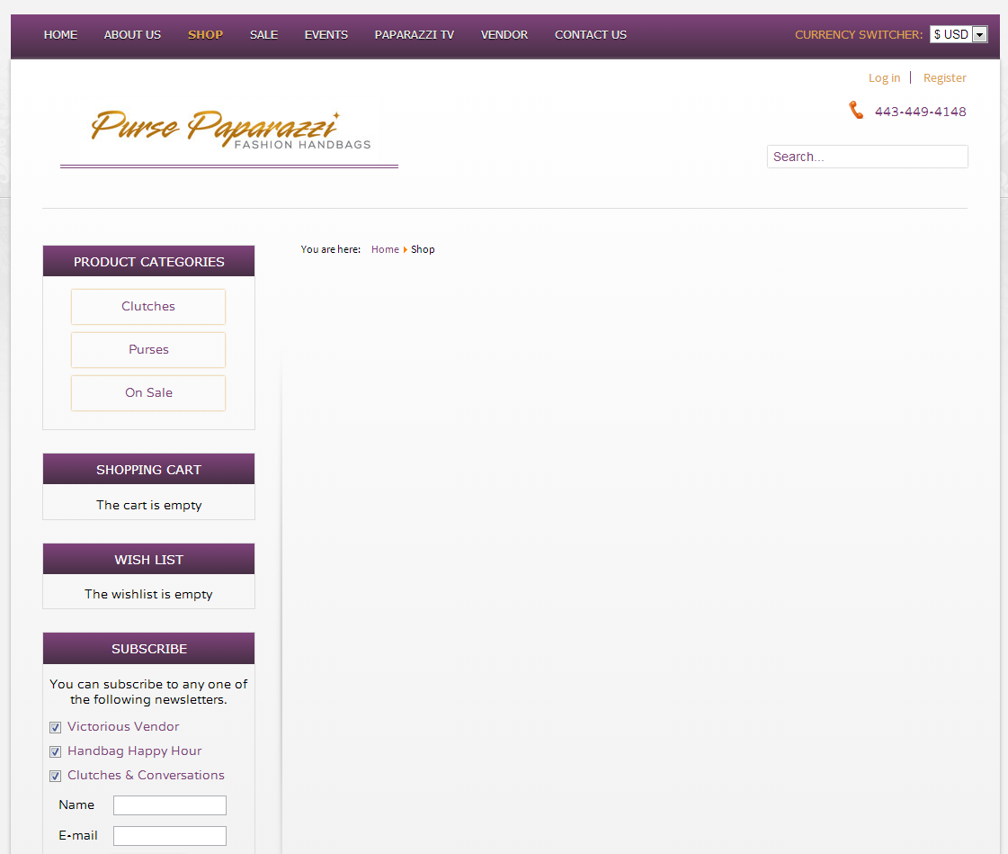

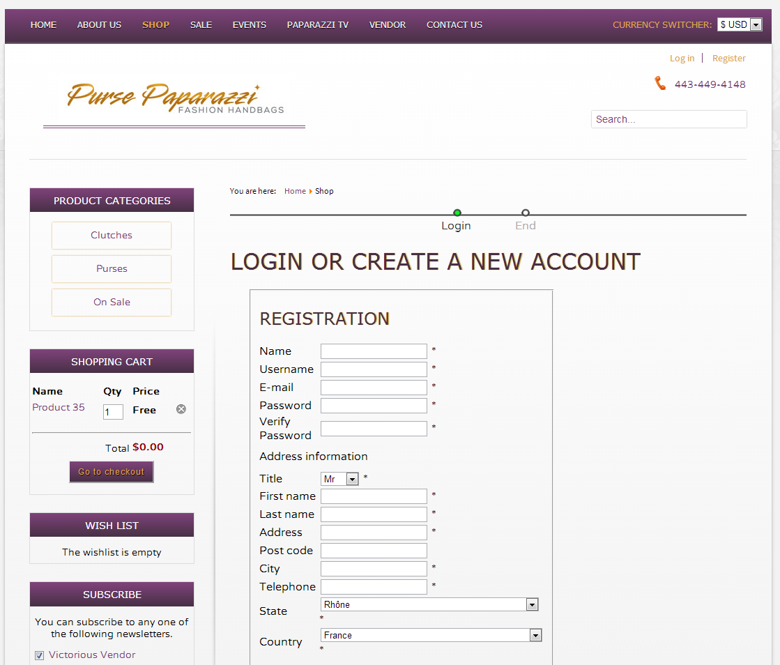

Your first problem mentioned here concerned the display of HTML code instead of the checkout page after adding a product to the cart and going to the checkout.
I just tried and I got the correct page displayed:
You now say that you have the same problem when you remove an item from the cart module.
I just tried and I got the correct page displayed too:
So I'm sorry but I don't see any problem on your website.
