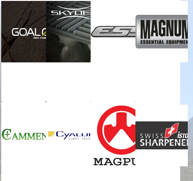

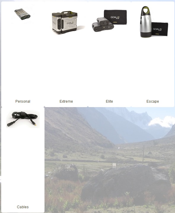

However, after trying to make a smaller thumbnail picture for the product div page with ".hikashop_product_image img {width: 100px !important; height: 100px !important; }", they are able to be reduced to my desired size of 100x100px, but now there is a huge gap between picture and title, please see the following screenshot.
2nd problem, I don't know how to manually edit the size of the thumbnails in categories listing page, please see the following screenshot, the categories pictures follows my product page pictures size.
Last edit: 14 years 8 months ago by Darken.

14 years 8 months ago #29821
For your products and categories listings, you should edit their options via the menu Display->Content menus/modules and set the "images width/height" options so that they take the correct size. You should not use CSS for that. Otherwise, the div around the image won't have the proper height and you will get that big blank space (which can however be corrected with a bit more CSS).
