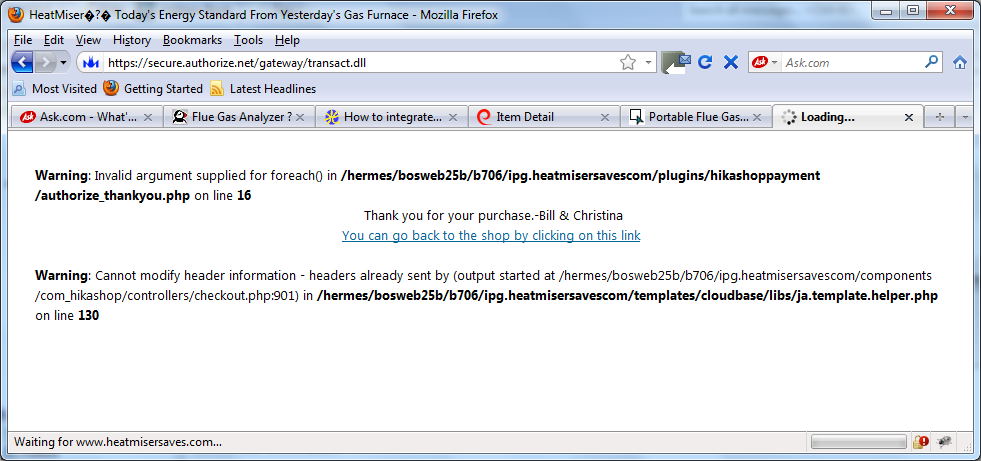

This page appears for a second after the credit card goes through but before the thank you page is displayed. I had to be quick to get the Alt-PrtScr.

15 years 7 months ago #12828 by nicolas
You need to change the line:
foreach($products as $product){
to:
foreach($dbOrder->products as $product){

Mechanically things look like they are working but now I need to fix this error:
Warning
: Cannot modify header information - headers already sent by (out started at <path>/ipg.heatmisersaves.com/components/com_hikashop/controllers/checkout.php:901) in <path>/ipg.heatmisersaves.com/templates/cloudbase/libs/ja.template.helper.php on line 130.
15 years 7 months ago #12887 by nicolas
In your code you have:
print $dbOrder->order_number;
but you don't have any code to generate it... You should replace it by:
print hikashop::encode($dbOrder);
For the warning, you can just edit the file templates/cloudbase/libs/ja.template.helper.php and add a @ at the beginning to hide the message.
