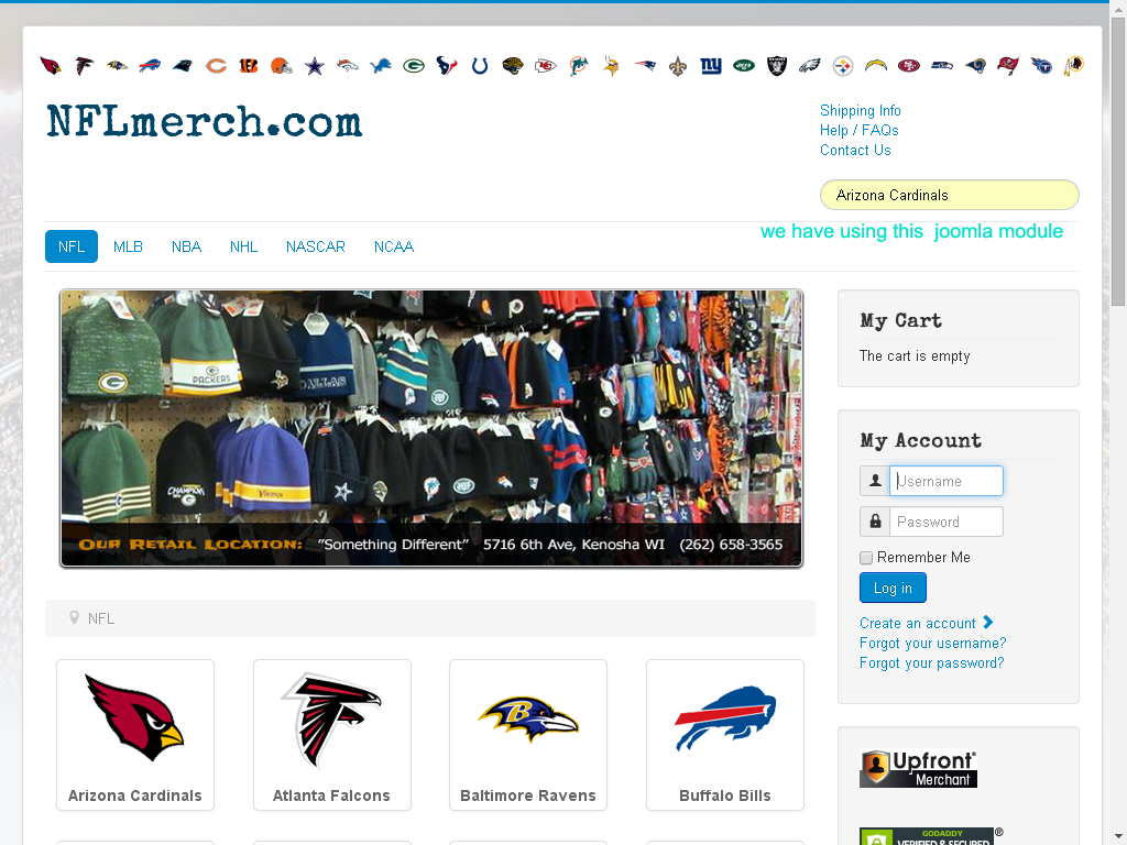

  • Posts: 10
11 years 5 months ago #188112
hi
we have try to Product Picture in Search Results ( joomla default search page.)
please check my website nflmerch. com
can you please help me ?
Deepz

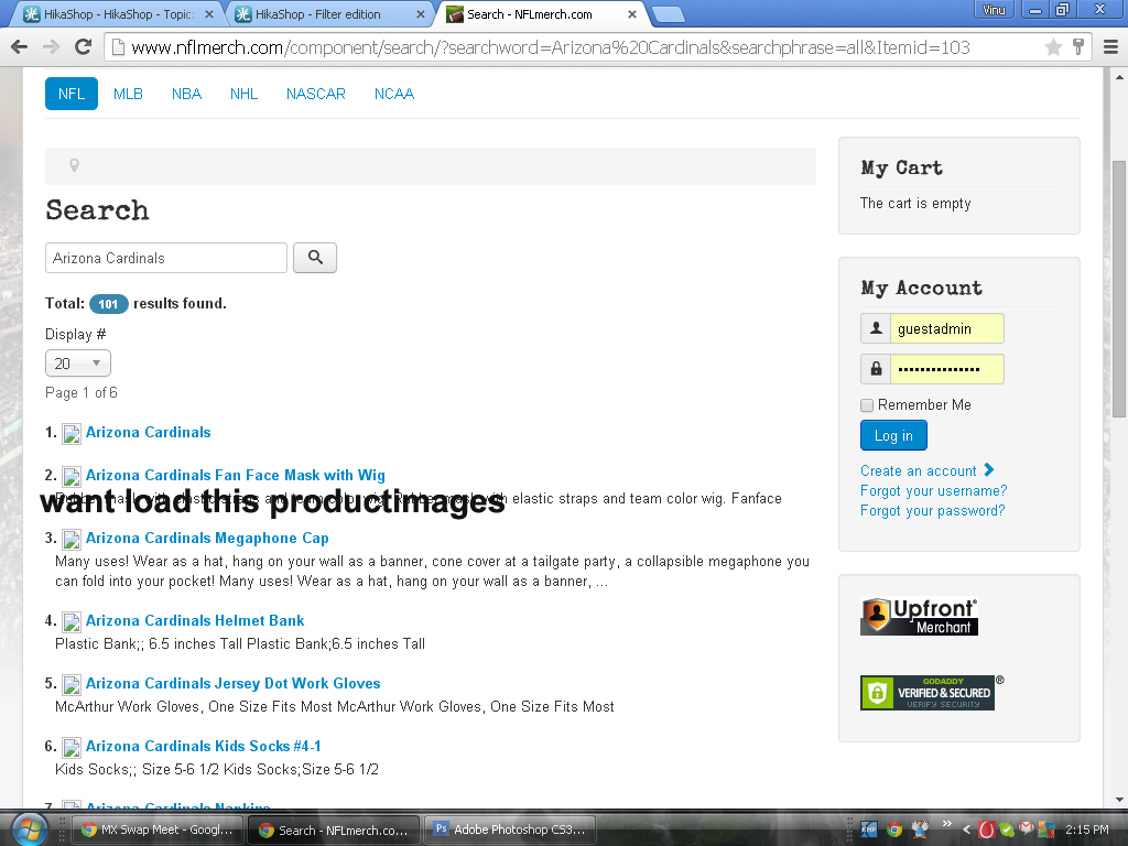

  • Posts: 10
11 years 5 months ago #188161
thanks for your reply.
What i want ?
please check this screen shots. And please help me.
waiting for your biggest Help.
Vinu
11 years 5 months ago #188188
In the search plugin you have to get the product images, you can see how it is working in the view "product / show_block_img".
You will potentially have to get the full product php object before looking for its attached images.
/* You will potentially have to use two different codes, one for the products and one for the categories */
$ids = array(); // fill it with the ids of the products returned in the search
$imgAddress = array();
$imageHelper = hikashop_get('helper.image');
$productClass = hikashop_get('class.hikashop');
$productsData = $productClass->get($ids);
foreach($productsData as $product){
  $image = reset($product->images);
  $imgAddress[$id] = '/mainPath/'.$image->file_path;
And then for each results get the image path from the previously created array.

11 years 5 months ago #188305
The given code is not complete, it require more elements, more php loops etc.
So if you are not a developer we recommend to:
- Use the default search
- Use the hikashop filters instead of the search
- Post a request on the commercial jobs section of this forum
- Ask to a third developer
The following user(s) said Thank You: vinu
  • Posts: 10
11 years 5 months ago #188385
Once you check this link
www.nflmerch.com/component/search/?searc...hrase=all&Itemid=103
we have using default search (joomla)
But i want show product images or thumbs
can you help me ?
  • Posts: 85786
  • Thank you received: 14079
11 years 4 months ago #188457
The default search of Joomla doesn't support images display.
If you need that and you're not a developer and you don't want to pay one for that customization, you're left with two options:
1. You use the HikaShop filter system which can do that.
2. You try to find another search extension which is compatible with HikaShop and which supports the images display.
