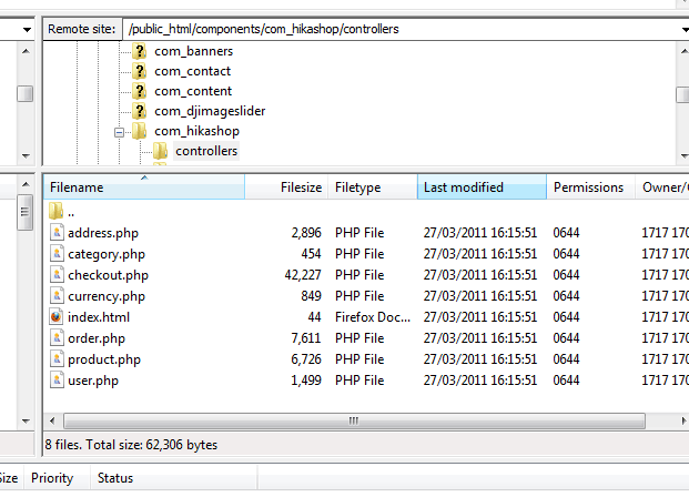

  • Posts: 110
15 years 2 months ago #12362
Hi Nicolas
I don't even have the config file. These are the files I have on that path:
Please help.
  • Posts: 85788
  • Thank you received: 14079
15 years 2 months ago #12364
You're not looking at the good folder.
You're looking at components/com_hikashop/controllers and not administrator/components/com_hikashop/controllers
