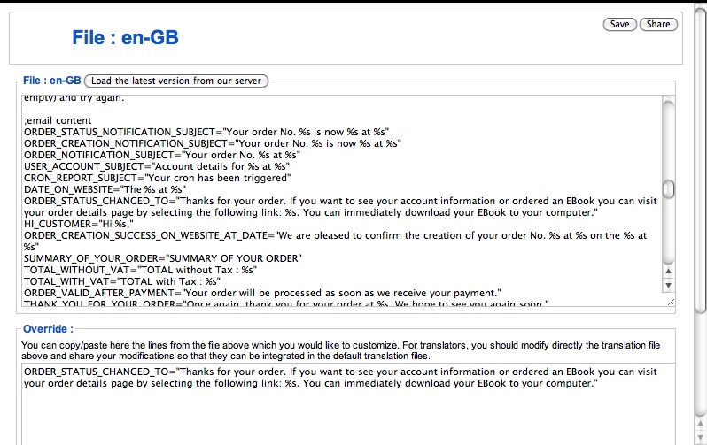

Followed your suggestions as best as I could.
Receipt text isn't working.

Could you do a screenshot of the translation change you did ?

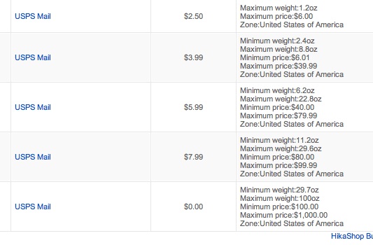

EBooks = download, no weight
Clickers = $6.00 cost $2.50 shipping
If anyone orders anything besides clickers, the cost starts at $3.99 for orders of $6.01 and higher.
EBooks should be zero shipping. The $2.50 charge works if I just order clickers, but if I add an EBook the shipping jumps to $3.99 and it should stay $2.50
Thanks.

You based your shipping methods on prices without any weight restriction.
You should set a minimum weight for your shipping method and that will solve the shipping cost problem.
For the translation, it seems right. Could you try the same modification on our demo website and tell us if that works for you ?

Okay, so if I sell different products with different weights. I need to figure out how much they would add up to for each price?
For instance, the M/L harness weighs 5.8 oz and the large harness weight 6.0 oz and they both cost 20.95.
Since two M/L harnesses would put the customer over the 39.99 price point and they weigh 11.6 oz.
So, 11.7 oz would be the next shipping weight?
Is that the right line of thinking?
It seems like I would have to do a lot of calculations and things could change if I start carrying different products with different weights.
Am I missing something?

Yes, you will need to made the calculations for your shipping methods. In the future, we'll add the possibility to enter the shipping price of each product so that the shipping methods price are calculated automatically.

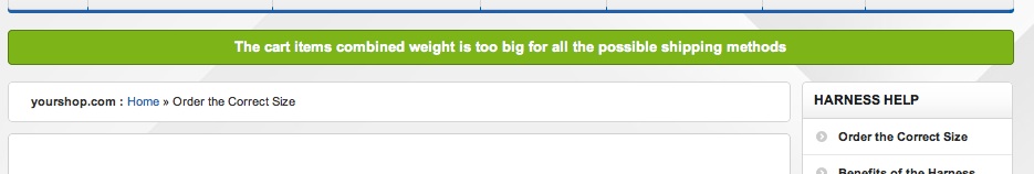

I have a new error: "the cart items combined weight is too big for all the possible shipping methods."

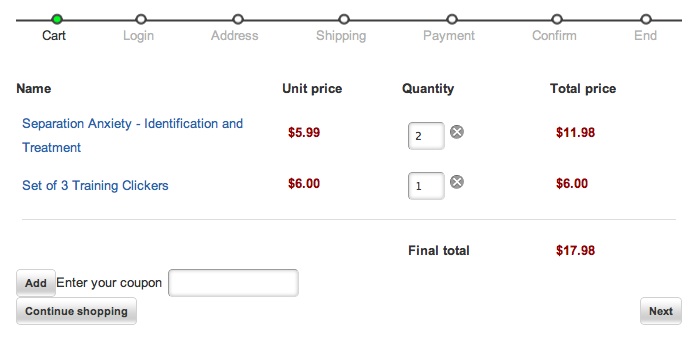

This error happened in conjunction with the shopping cart image that you can see below. The cart wan't very full, as you can see, there just must be an error in how it can choose a shipping method?

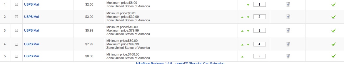

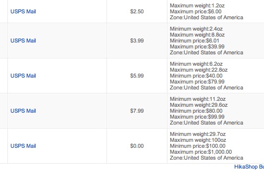

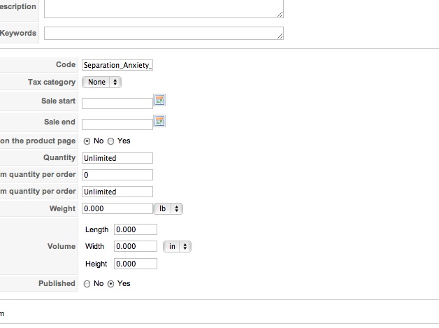

Enclosed are 3 pics. One of the shipping options, prices and weights.
The other is the shopping cart. The 3rd is the error message.
The EBooks are absolutely zero weight.
I ALSO HAVE ANOTHER QUESTION:
Is there any way that the EBooks DON'T count towards the shipping total to increase the price, but DO decrease the price to ZERO when my customer orders more than 99.99 worth of any products?
I am not sure if this is possible.
The EBooks are not getting charged for shipping when it is just the EBook in the cart, (good) but they do add to the shipping cost when they are in the cart with another physical product (bad), and the Ebook "pushes" the price to the next shipping level. (bad).
Thanks.

For the error message, what is the weight of your products ? Is your customer's address in the USA ?
For your ebook issue: That's not possible. The prices limitations of shipping methods are based on the total price of the products in the cart.
You have two solutions to that:
1. Edit the code of the shipping plugin so that it works like your want ( it's the file plugins/hikashopshipping/manual.php ).
2. You need to use the volume limitations instead of the price in your shipping methods and set the volume for each product equivalent to its price.
So if a product costs $10 his volume would be 10, if the product costs $20, his volume would be 20. For ebooks, you don't set any volume and you're set.
