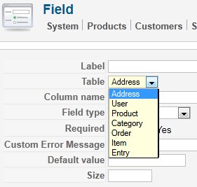

where would i add the custom fields of the table product? where would i find the table? if i go to display ---> custom field, and i try to create a field it automatically picks address as the table.
  • Posts: 26381
15 years 2 months ago #18124
HikaShop Starter just allows custom fields on "address" table.
You need a commercial version of HikaShop in order to have more possibilities.

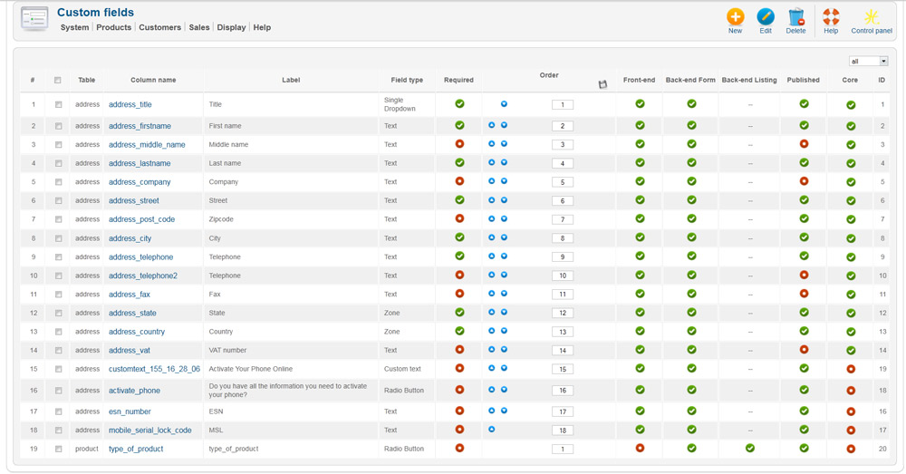

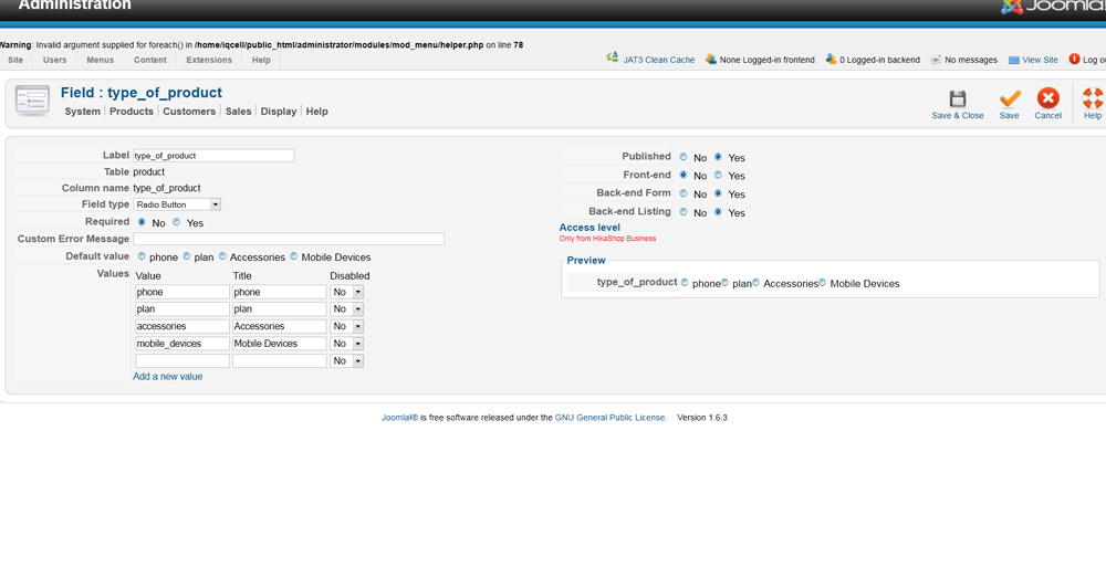

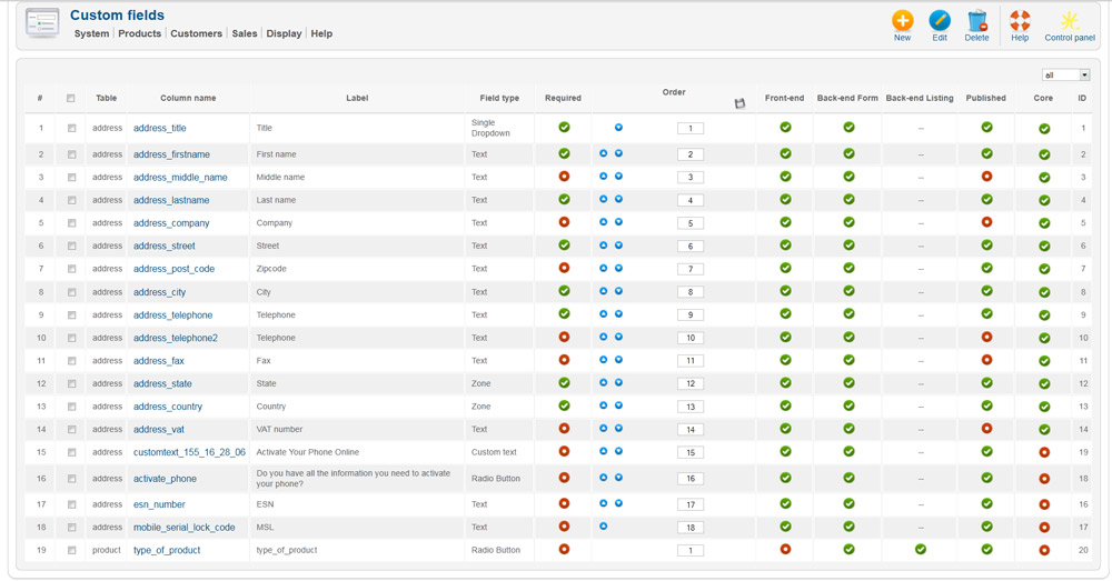

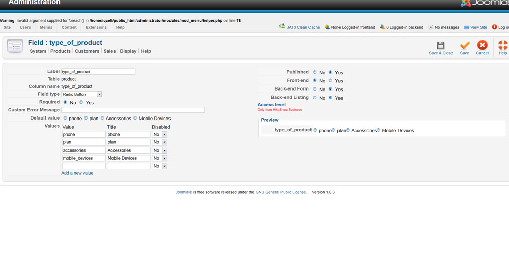

  • Posts: 156
15 years 2 months ago #18336
here they are.
  • Posts: 156
15 years 2 months ago #18337
Here is inside the field.
