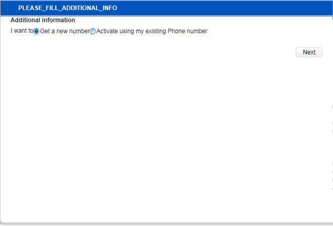

15 years 2 months ago #18793
i would like to add a link right after to the field of the order custom fields. check out the image.
the idea is to have a link that will be a lightbox window with more information about what we are asking for in the field.
should be a core feature :)
anyway for now i just need to make it happen though, any ideas of the easiest way to implement it?

15 years 1 month ago #19110
The label can be displayed with:
echo $this->fieldsClass->getFieldName($this->extraFields);
  • Posts: 156
15 years 1 month ago #19121
How about the please_fill_addiotional_information problem? Any reason why this keeps happing to me ;(?
  • Posts: 86049
  • Thank you received: 14177
15 years 1 month ago #19122
That's because of the check of that custom field type. That's a new type of custom fields that we introduced in last release and there are still some hickups when using it. That's why I recommended you to not use it for now.
  • Posts: 156
15 years 1 month ago #19124
The radio check custom field type?
Well like I said above I tested it with no fields being echoed and I was still having the issue. I. also tested it just with a text field and still the same issue. This form is really important in my case so I need to get it working nicolas, would you like back-end access to help move this along?
  • Posts: 86049
15 years 1 month ago #19129
Yes. Please send it via our contact form so that I can have a look. Also, an FTP access might be needed in order to correct the problem if it is indeed because of a bug.
  • Posts: 156
15 years 1 month ago #19171
hey , so what seems to be causing this issue? let me know if there is anything i can do.
Last edit: 15 years 1 month ago by Rickhavoc.
  • Posts: 86049
15 years 1 month ago #19172
I had a look but I couldn't find the problem, your settings seems fine. We would need to add debug traces on the checkout files in order to find the problem and for that we will need an FTP access.
  • Posts: 156
15 years 1 month ago #19176
i'll send you log in information to the cpanel of it.. the ftp is not going to work cause the domain is not pointing to the server at the moment.
Edit-- login info has been sent.
  • Posts: 156
15 years 1 month ago #19184
any luck my friend?
  • Posts: 86049
15 years 1 month ago #19185
We didn't had yet the time to look at it.
  • Posts: 86049
15 years 1 month ago #19189
We put some traces and found out that the data is good on HikaShop's end but that joomla does not stores the variables that HikaShop gives it in the session. Which results in HikaShop believing that the custom fields have not been filled.
That can happens sometimes on servers with a specific configuration and with the session handler being the database. Usually, changing the database handler to "none" in the joomla configuration solves the problem without any drawbacks.
We can't access the configuration of your website and can't modify the configuration.php file so we couldn't test that.
Please change it yourself and logout/login from the front end and try again.
