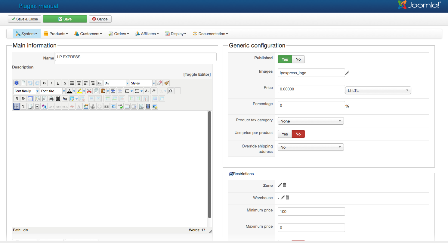

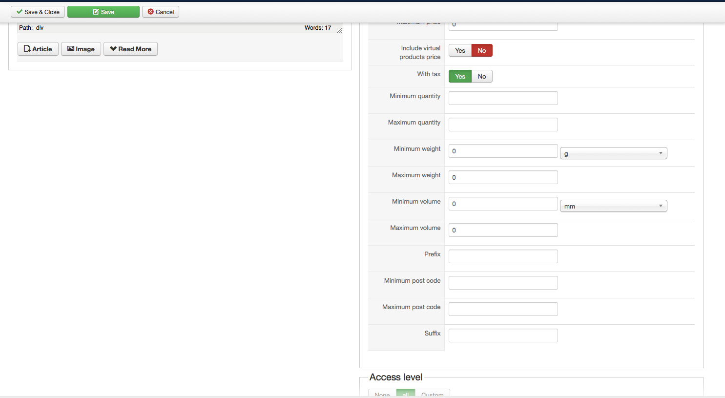

Can you show me some screenshots of how did you configured one of the shipping method which is not showing ?
  • Posts: 198
  • Thank you received: 4
  • Hikaserial Standard Hikaserial Subscription Hikashop Business
11 years 11 months ago #169300
11 years 11 months ago #169317
Ok thanks :), and are your sure that the price of your order was above 100 ? Because you have "Minimum price" restriction.

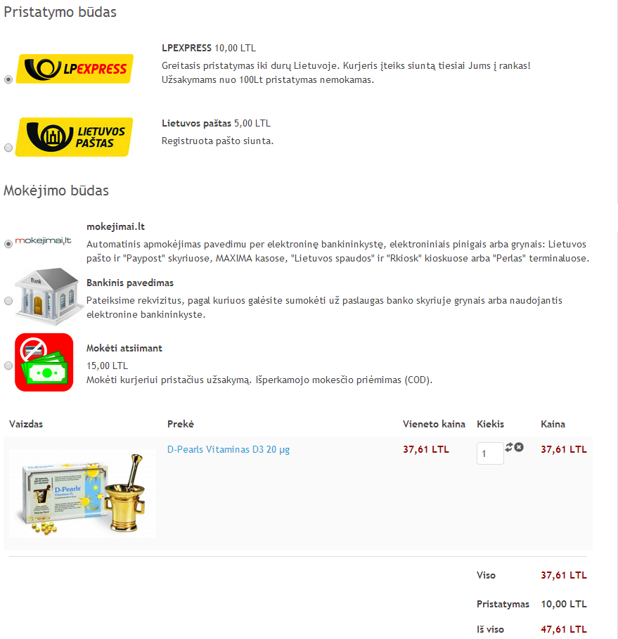

11 years 11 months ago #170150
Shipping is showing now, but selection is not working. If there are two shipping options, whatever you choose, nothing changes (price is not changing, and at the bottom of page, you can see that selection is not changing, even if you selected different shipping method.
11 years 11 months ago #170175
To do that you'll have to set the "Auto submit shipping and payment methods selection" option to "YES" through "Hikashop->System->Configuration->Checkout".

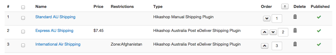

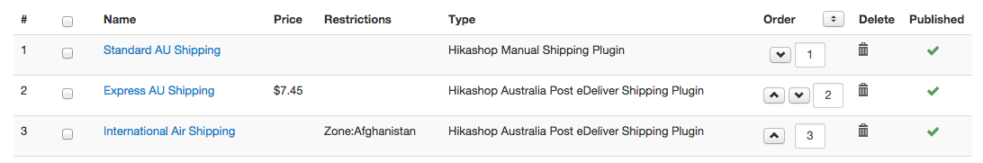

  • Posts: 35
11 years 3 months ago #198664
Dear Nicolas,
I have the same issue and have gone through the FAQ points. I have also checked the plugins and they are published and set to public.
Could it be that one manual shipping method is set to $0.0 as price?
Attached is a screenshot of my shipment methods.
Edward
Edward
11 years 3 months ago #198666
Hello Edward,
Firstly can you show me how did you configured your shipping methods and the weight/dimensions of the products that are on your cart when you test it ?
Also, what do you exactly mean by : "Could it be that one manual shipping method is set to $0.0 as price?"
