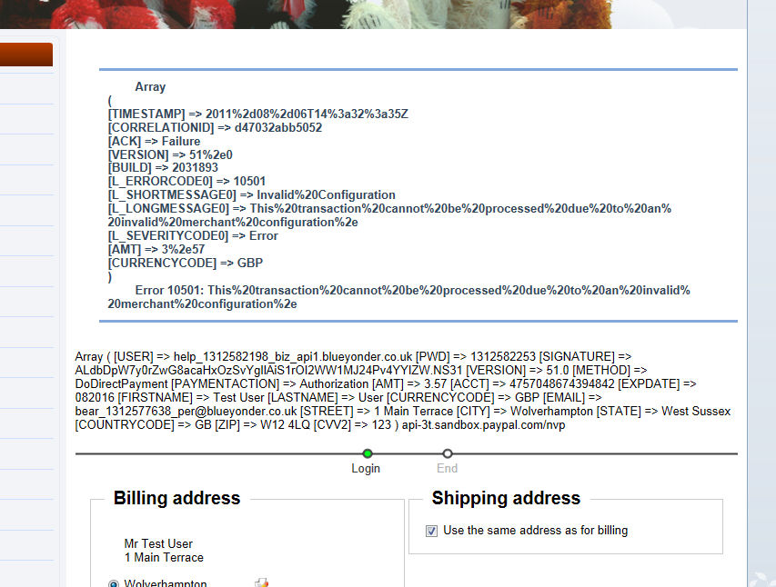

Hi again, I cannot get this to connect to sandbox, can you advise what may be wrong from the error message? Pretty sure I have all the bit's in the right places passwords etc.

Looking at the 10501 error on google, I found that thread: www.x.com/thread/39182
Apparently, when testing with the sandbox, you need to ask paypal support to activate the payment pro of the sandbox account and make sure that you're using the correct credentials. You should contact PayPal directly for help on that issue.

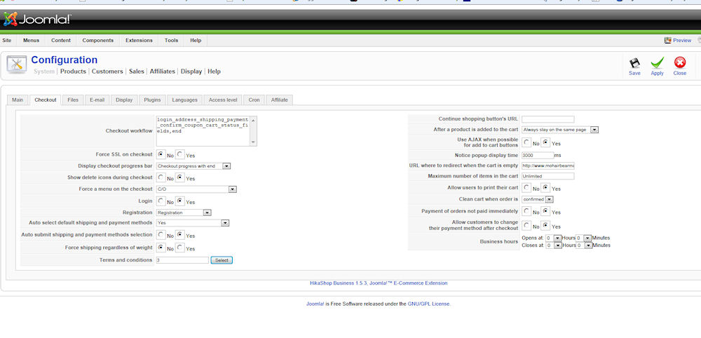

Concerning the two steps, it depends on how your configured your checkout options in the configuration. It's possible to have it in two steps like you have , but it's also possible to have it in one step. Could you do a screenshot of the checkout tab of the configuration ?
  • Posts: 590
  • Thank you received: 12
15 years 1 week ago #22969
checkout config.
  • Posts: 86049
  • Thank you received: 14177
15 years 1 week ago #22981
your checkout options are fine. Did you edit any file of the view checkout via the menu Display->Views ?
