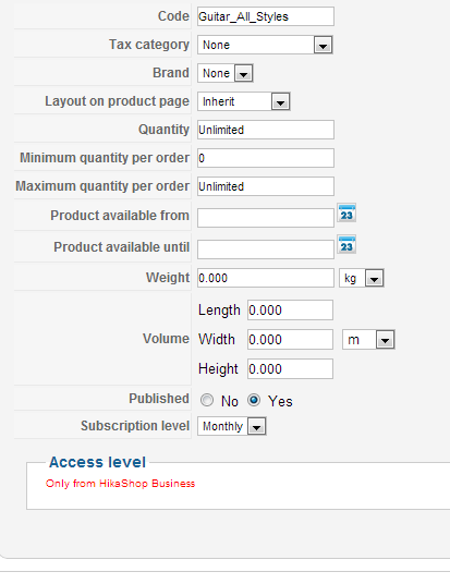

Do you have assign the subscription level on you product ?
Could you post a screenshot of one recurring product configuration ?
(I think that with that one I will have all the possible screenshots for the recurring ;) )

13 years 8 months ago #76453
Recurring Product Configuration:
13 years 8 months ago #76646
In the file: "administrator/components/com_hikashop/classes/cart.php" can you replace the code:
			if(!isset($product->subscription_level_id) || $product->subscription_level_id == '0'){
				$noRecurring++;
			}else{
				//check the subscription duration in the subscription plugin
				$subLevel[$i] = $product->product_subscription_id;
				$recurring++;
By:
			if(!isset($product->product_subscription_id) || $product->product_subscription_id == '0'){
				$noRecurring++;
			}else{
				$recurring++;
Last edit: 13 years 8 months ago by Xavier.
