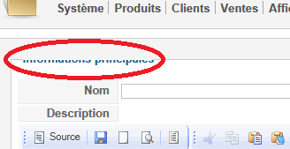

I have another problem into the backend with IE9, all the box of all menu are over the title. See image

For the fieldset titles on IE9 on joomla 1.6, you need to change the code:
#hikashop_main_content FIELDSET.adminform LEGEND{
position:relative;
float:none;
to:
position:relative;
float:none;
top : 0px !important;
in the back end CSS of hikashop. You can do that via the interface in the config under the tab display.

15 years 4 months ago #11923
For the cart problem, I just replace the 3 lines for the new one and it display the cart into a blank screen. When I click to the delete item it add one more.
For IE9 problem, I didn't find where to change it. I use the french backend.

15 years 4 months ago #11924
We tested the modification on our end and it's working. Please double check that you correctly replaced in the code in the cleancart function. Otherwise, please zip the file and attach it to your next post so that we can check it.
For the CSS, you can edit it via the interface in the config under the tab "affichage" in french. You have a CSS zone there where you can edit the back end CSS.
