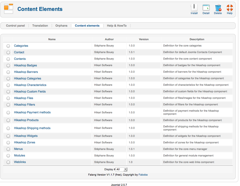

Hello, sorry to resurrect this thread but I have run into issues as well.
Main components:
Joomla 2.5.7
HikaShop 1.6.0
Falang 1.1.7
PhP 5.3.17
db collation: latin1_swedish_ci
My website is multi-lang: English and French (default). The Hikashop content elements appear in Falang and work properly when I use the backend to manually enter the text and translations. It doesn't seem to work properly, however, when I attempt to use the import feature.

13 years 9 months ago #74909
I'm assuming Falang is working properly, I can see all my products and categories. Also, when I manually add translated text into Falang:Hikashop elements (products/categories) it seems to work as expected.
