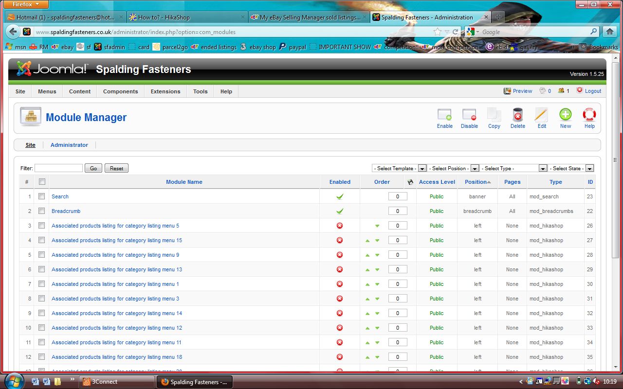

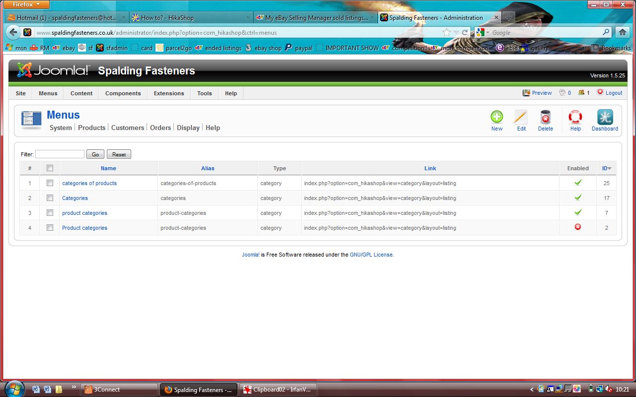

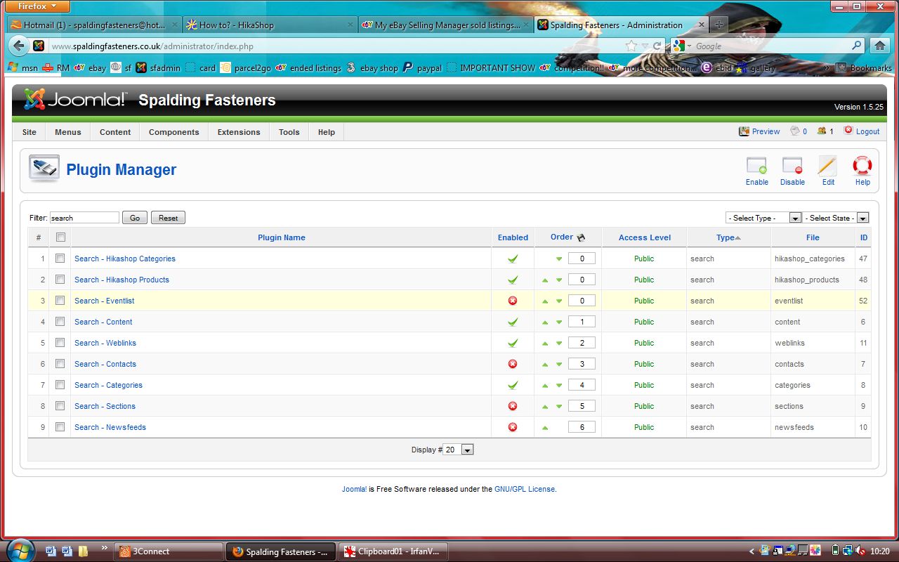

  • Posts: 90
13 years 11 months ago #58291
hi,
yes I think so. I have attached screen shots of both the module manager and plugin manager. I have also attached screen shot of the content menus screen - I have tried putting the ID of each of the content menus (25, 17, 7, and 2) into the item id box on the search plugin, but none of them work.
could it be anything else I'm doing wrong?
kind regards,
Tanya
  • Posts: 85796
  • Thank you received: 14090
13 years 11 months ago #58340
Can you try to turn on the "debug mode" of the configuration of joomla and search again ?
If there is a problem with the plugin, it should then display a big error message.
Otherwise, it should work. In that case, please give a link to your products listing and search module on your website so that we can see that.

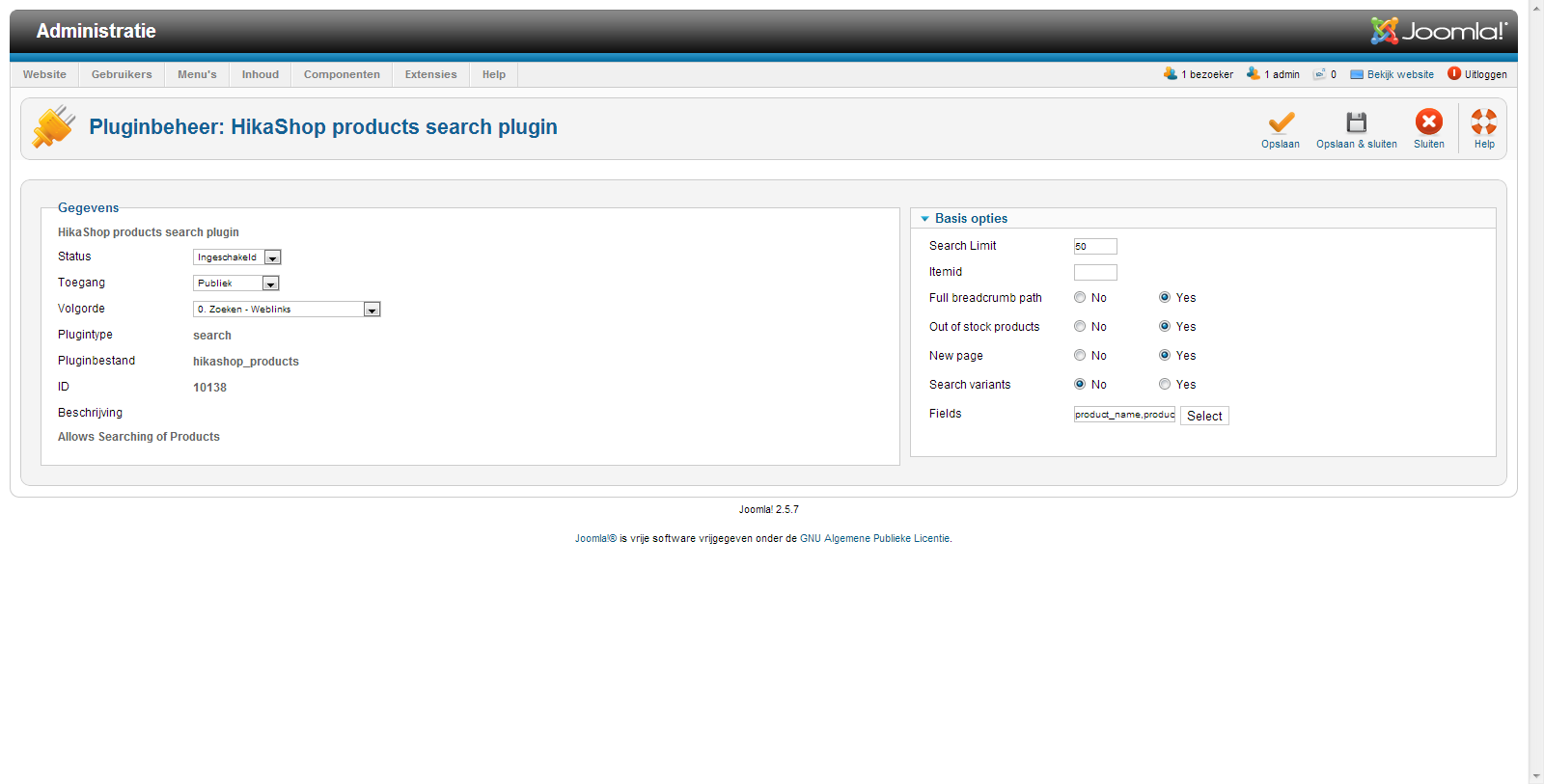

  • Posts: 235
  • Thank you received: 4
13 years 8 months ago #70642
Attached 3 files with the screenshot and the queries.`
Kind regards
Jan
  • Posts: 85796
13 years 8 months ago #70692
So the query which is run by the plugin is this one:
SELECT DISTINCT b.*
FROM s3gof_hikashop_product_category AS a
LEFT JOIN s3gof_hikashop_product AS b
ON a.product_id=b.product_id
WHERE b.product_published=1
AND b.product_type = 'main'
AND a.category_id IN (2)
AND (b.product_access = 'all' OR b.product_access LIKE '%,1,%')
AND ( b.product_description LIKE '%duplo%' )
ORDER BY a.ordering ASC
LIMIT 0, 20
As you can see, it only searches in the product_description field, not the product_name field.
You might have a second hikashop product search plugin which is configured to search only the description in your plugins manager. Otherwise, try to change the selection of the search fields in the options of the search plugin. There must be something related to it.
