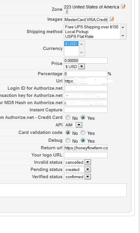

Please help! An order will go through and it says it is ok in the orders section - but it never gets to authorizenet. They have not seen transactions in the last 10 days! I have a screenshot of the plugin setup.

More info - I checked old "merchant email receipts" from an old order that went through ok compared to a recent one that failed and the recent one said "Test mode" in the top and no authorization code or transaction Id. Then I checked Authorize net on line and my account shows I am still in "Live Mode". I will call them when they open but could this be a php file issue? (I am wondering if I damaged the file) It just started recently when I went to HIKA 1.6 The recent email receipt says I am still in capture mode (even though the hika plugin has capture turned off)

If you don't get any transaction at all to authorize.net even though the orders are created in HikaShop, then it's definitely not a problem with the instant capture option.
That plugin is working well in 1.6.0 for other users. There is no reason it wouldn't be the case for you.
Contacting authorize.net support is a good idea at this time. It might indeed be an issue with your account.

I still have a big problem. I just talked to authorizenet on the phone and did some tests with them. I am not in TEST MODE - (They said I would see a big red bar saying test mode on the site if I was) They submited a .01 transaction at their end ok, I can submit transaction ok through my virtual terminal and then I did a test order through the Hikasop program. I received the order at my end, I received a Merchant Email Receipt that said I was in test mode and authorize net received nothing. Something from hikashop is putting authnet in test mode.

You probably have the "debug" option of the authorize.net plugin turned on. It activates the test mode of authorize.net
Turn it off and you will be in live mode.

:) Thank you - Now I remember that I probably turned the debug on to fix the capture issue. Orders are now going through.
