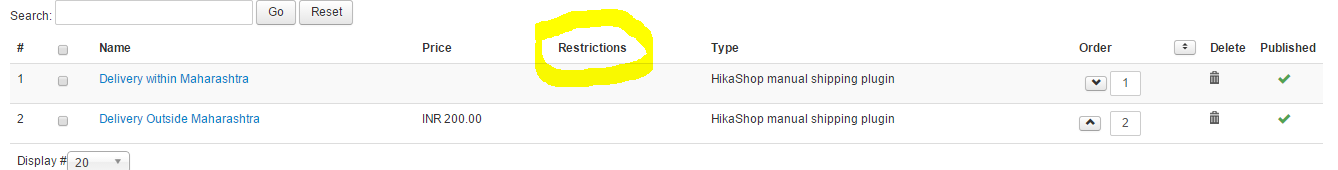

I tried to find the way to add restrictions to the shipping zones. But I am unable to find. I can see the title as 'Restriction' on shipping methods layout. Please refer the screenshot below. I cannot find any option or setting where can I actually add those state/zone restrictions.

Sure you can also use the 'Maharashtra' State, you won't have to create a shipping zone for that state, but regarding the other states of India, you'll have to create a shipping zone.
You'll be able to use the "Zone" option via the "Restriction" tab of your shipping configuration page (You'll just have to click on the "Restriction" check-box).
