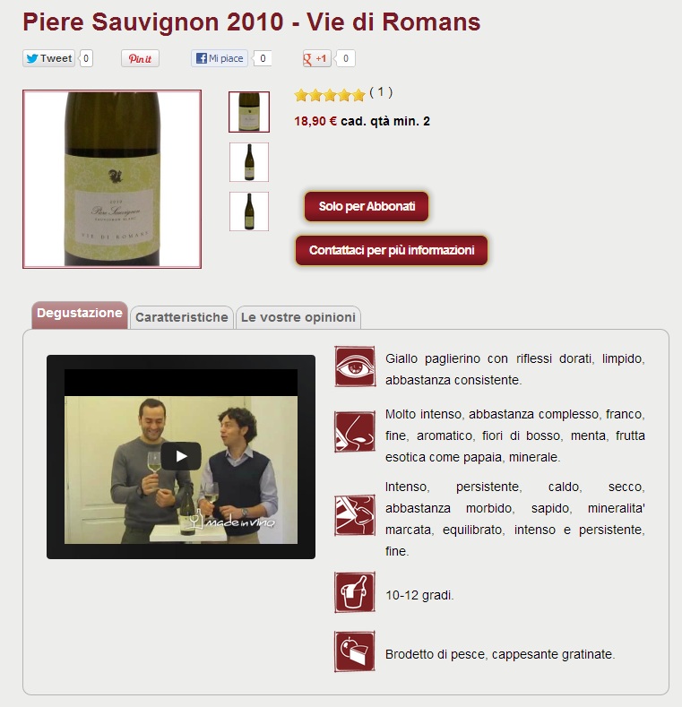

Hello everybody
I am testing the version 2.1.0 on my labs environment.
I was using an old version (1.6.0) and for this reason i am recreating all the custom views.
I have some problem to use in the correct way the tabber plugin.
I was trying to replicate the old modifications but i have some problems with the comments block.
www.labs.madeinvino.it/la-nostra-cantina...ti.html#degustazione
As you can see the comments is outside the tabber.
The reason is that now the comment block is no more inside the view product show_default.php
Could you give me an advise?

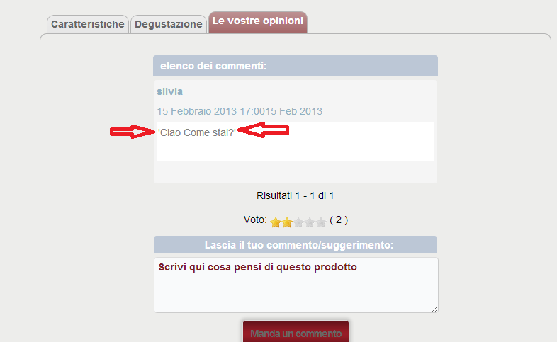

Probably I also found out a bug, when you leave a comment, hika stores it into the database with the apex (quote):
I also enabled the Jcomments, do you think is possible easely insert it inside the tabber?
Last edit: 13 years 6 months ago by Teto.
  • Posts: 86051
  • Thank you received: 14179
13 years 5 months ago #90488
To fix the quotes, edit the file administrator/components/com_hikashop/classes/vote.php and change the lines (2 occurrences):
$vElement->vote_comment = $db->quote($safeHtmlFilter->clean($element->comment, 'string'));
to:
$vElement->vote_comment = $safeHtmlFilter->clean($element->comment, 'string');

thank you now the bug is fixed.

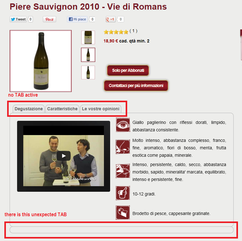

Dear all
I found a problem on Internet Explorer (I hate IE.... :( )
www.madeinvino.com/la-nostra-cantina/pro...0-vie-di-romans.html
Everything looks fine with Chrome and Safari
On Internet Explorer 9 there is an unexpected tab and there is no tab active (is the same problem on IE8).
I think it is not a problem of TABBER because I use it to on an article and I have no problem
www.madeinvino.com/abbonati.html
I also upgraded the tabber extension to the last available version (3.0.6) but the error is the same.
Do you have any idea or suggestion? :dry:
09-03-2013 15:00
I found the reason, this is the customized view product/show_default.php

  <?php // Stefano Start - Inserimento PlugIn per Tabulazione  ?>
  {tab=Degustazione|grey}
  <?php // Stefano End ?>
  <?php
  if(!empty($this->element->extraData->bottomBegin))
    echo implode("\r\n",$this->element->extraData->bottomBegin);
  <div id="hikashop_product_description_main" class="hikashop_product_description_main">
    <?php
    echo JHTML::_('content.prepare',preg_replace('#<hr *id="system-readmore" */>#i','',$this->element->product_description));
  </div>
  <span id="hikashop_product_url_main" class="hikashop_product_url_main">
    <?php
    if (!empty ($this->element->product_url)) {
      echo JText :: sprintf('MANUFACTURER_URL', '<a href="' . $this->element->product_url . '" target="_blank">' . $this->element->product_url . '</a>');
  </span>
  <?php // Stefano Start - Le 5 righe di cui sopra sono state spostate qui ed è stata aggiunta la stringa per abilitare la TAB?>
  <?php
  if(!empty($this->fields)){
    ?> {tab=Caratteristiche|grey} <?php
    $this->setLayout('show_block_custom_main');
    echo $this->loadTemplate();
  {tab=Le vostre opinioni|grey}
  <?php // Stefano Start - Aggiungo parte presa da product_show.php  ?>
  <form action="<?php echo hikashop_currentURL() ?>" method="post" name="hikashop_comment_form">
  <div id="hikashop_product_vote_listing" class="hikashop_product_vote_listing">
    <?php
    if($this->params->get('show_vote_product')){
      $js = '';
      if(isset($this->element->main)){
        $product_id = $this->element->main->product_id;
      }else{
        $product_id = $this->element->product_id;
      $this->params->set('product_id',$product_id);
      echo hikashop_getLayout('vote', 'listing', $this->params, $js);
  </div>
  <div id="hikashop_product_vote_form" class="hikashop_product_vote_form">
      <?php
      $js = '';
      }else{
      echo hikashop_getLayout('vote', 'form', $this->params, $js);
  </div>
    <input type="hidden" name="add" value="1"/>
  <input type="hidden" name="ctrl" value="product"/>
  <input type="hidden" name="task" value="show"/>
  <input type="hidden" name="return_url" value="<?php echo urlencode(base64_encode(urldecode($this->redirect_url)));?>"/>
  </form>

The problem seems due to this part of code I moved from product/show to product/show_default
    <?php
      $js = '';
      }else{
  </div>
      <?php
      $js = '';
      }else{
  </div>
  </form>
To solve the problem I had to move back to product/show.php these lines:
</form>
Do you know how solve the problem?

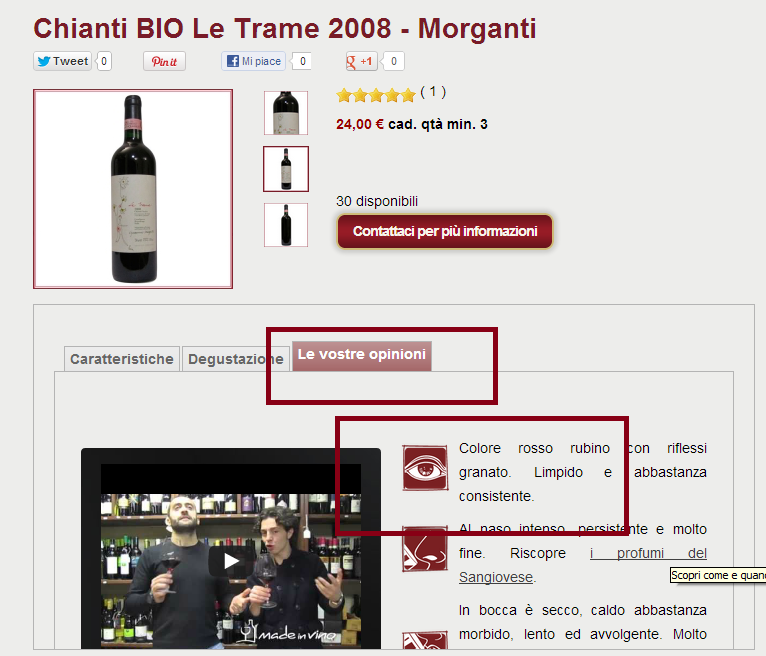

I checked on my end with IE 9 but the tabs work fine on the page www.madeinvino.com/la-nostra-cantina/pro...l#le-vostre-opinioni and I don't see the "unexpected tab".
  • Posts: 184
  • Thank you received: 4
13 years 5 months ago #94066
Hello
On the live environment to solve the problem I used the modification I wrote in the previous post
</form>
You can check the TEST env here: www.labs.madeinvino.it/la-nostra-cantina...10-ca-dei-frati.html
I will send you a PM with the information to access the test env.
  • Posts: 86051
13 years 5 months ago #94176
Then if it is already solved, I don't see what you want ?
I actually don't know why that happens on IE9. It's probably coming from your modifications as you said.
