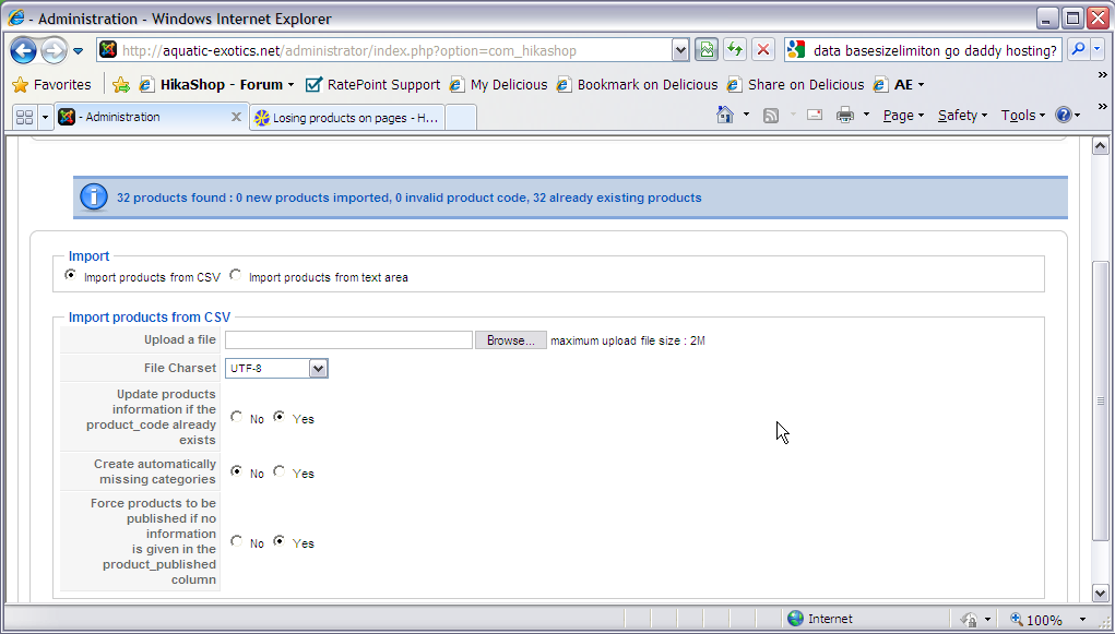

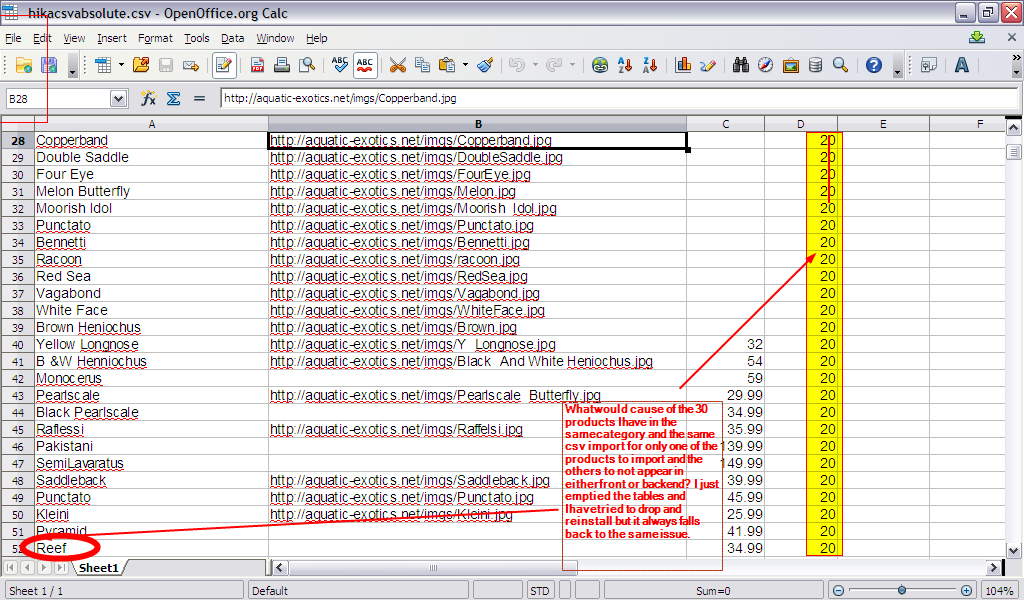

In the image. The only one showing is the circled in the front or back end. I spokewithmy host provider and they have looked into the DB and all of the strings are correct. I have emptied and dropped tables, but no luck. I can't flush the tables because I don't have reload privleges on this server>?
I could really use some additional help or advice on where to look to findout how to correct the issue.
THANKS!

Could you try to just create a new CSV with some of the entries missing and just import it via the interface ? Does it work ?
Could you also send us that small CSV so that we can have a look at it ?
  • Posts: 79
15 years 4 months ago #12876
Here is the file I amimporting it right now

15 years 4 months ago #12890
You should really update hikashop.
There was a bug in the import prior to 1.4.7 which could result in the removing of products or otherwise unexpected results.

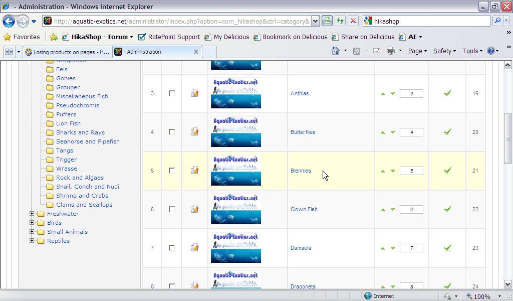

Could you make sure that the category with the id 20 exists ?
If the products are in the table hikashop_product but not in hikashop_product_category it means that there is a problem with the categories in the CSV.
I would first ask you to update. Is there a reason why you don't want to update ?

15 years 4 months ago #12968
I thought I had updated,lol. Maybe i downloaded it and forgot to install it? Who knows?
It's current now. Attached is a "SS" that shows the existence of the category.
I am going to try to reupload the shortened CSV and see what appears, and then try the full CSV to double check results.
