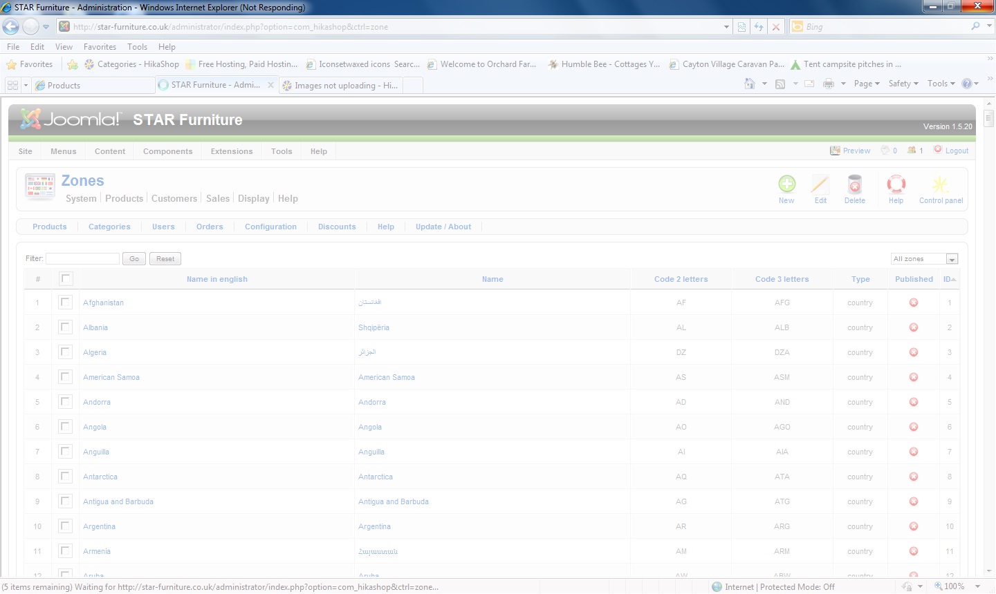

For your information, i`m finding it difficult to edit Zones. When i click 'System>Zones' then changes display to view 'All', my browser locks up and i cant make any changes:
Just to add that this doesnt happen in Firefox, only in IE8 it seems.

That's normal. There are around 5000 zones by default in HikaShop. If you try to display them all on one page your browser will struggle to process all that information and result in the problem you had.
It's the same with any joomla listing when you have a lot of information in it.
If you want to unpublish countries, you should first select the filter on the right to countries. Then, when you select all, it will only display 200 items which should be ok.
You don't need to unpublish states of unpublished countries because by just unpublishing a country, all its states won't be displayable by your users.

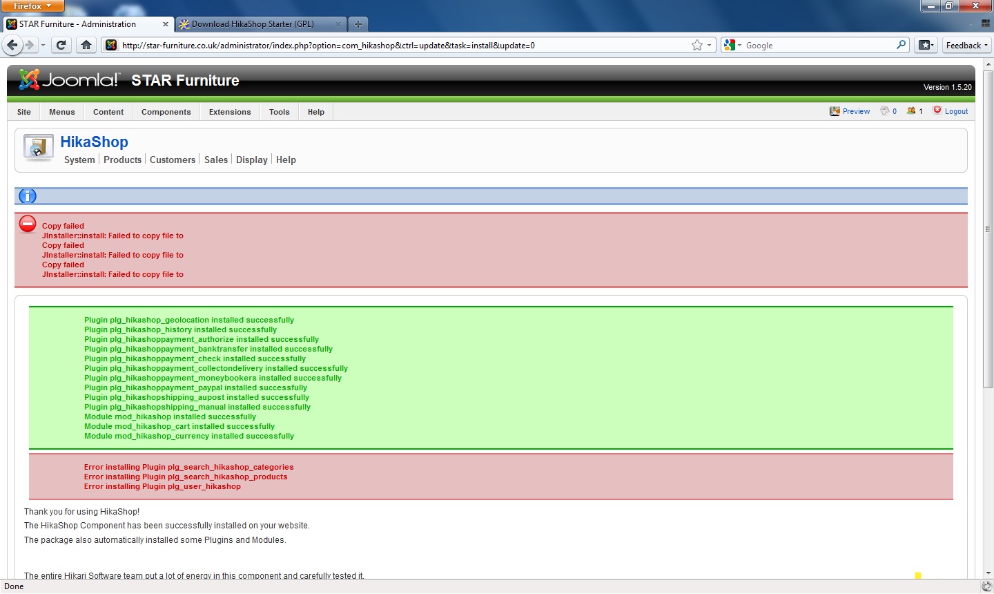

Thanks for the quick update, i have installed this but joomla throws up some errors after clicking install:
