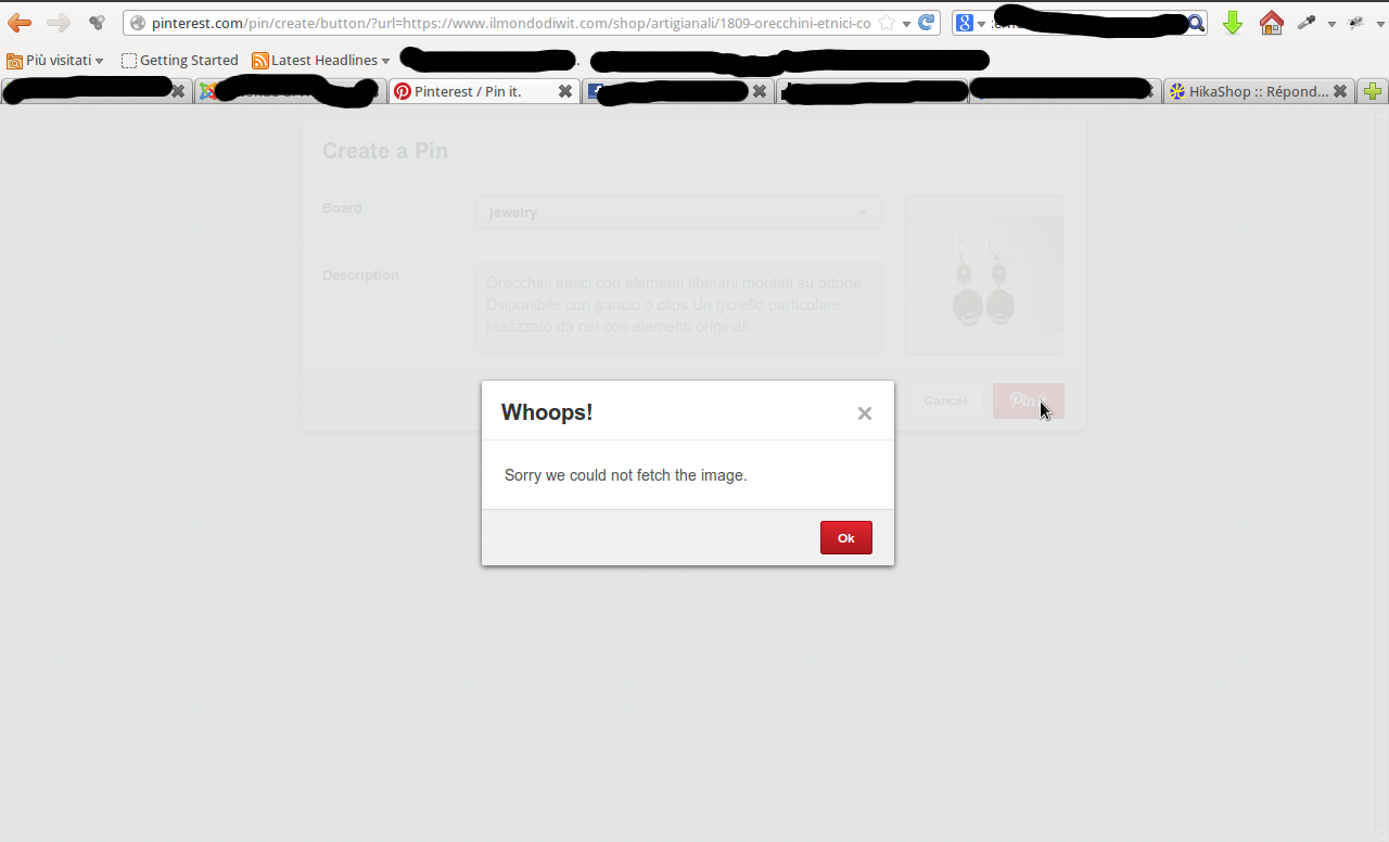

I have a new issue with pin after updating to business version. when i pin and product i get and error on pin it which i didn't get before update.
What can be wrong?

About the error message and according to this topic: www.inmotionhosting.com/support/communit...t-button-not-working it looks like it comes from pinterest and their specific restriction on images so I'm not sure we can help you on this point.

are you sure. i pinned [url=http://pinterest.com/pin/517562182147340430/?fb_action_ids=3104574149818&fb_action_types=pinterestapp%3Apin&fb_source=other_multiline&action_object_map=[279412582202623]&action_type_map=[%22pinterestapp%3Apin%22]&action_ref_map=[]&fb_collection_id=10151306687677165]this[/url] some days before form here https://www .ilmondodiwit .com/ shop/ artigianali/1418-bracciale-elba-ottone-e-argento.html and it worked. after this i updated to busines and i have this issue

The issue that i cannot pin anymore my products after upgrading to business edition is true.
I installed for testing issues here: http:// crystal-therapy . info/index.php/shop/product /1-test (take out the spaces) the starter edition which i had on my site before upgrading to business edition.
And it works like a charm with the same image sizes that i use for my other site. Try here https:// www. ilmondodiwit . com/shop/artigianali/ 1418-bracciale-elba-ottone-e-argento.html (take out spaces) this product i pinned with the starter edition and now unchanged with business it's not working anymore.
I think i can only be an issue form hikashop
Could you please verify this.

I reinstalled the business version and nothing no change. The images couldn't be pinned. I changed the http https like you mentioned in a post before and nothing. I looked for more http in the social file and there were was the line
$html=$div.'<a href="http://pinterest.com/pin/create/button/?url='.hikashop_currentURL().'&media='.$imageUrl.'&description='$return $html;
and i changed the http to https just for curiosity and ??? it works.
don't ask me what was really the problem but now it works.
Thanks for support
