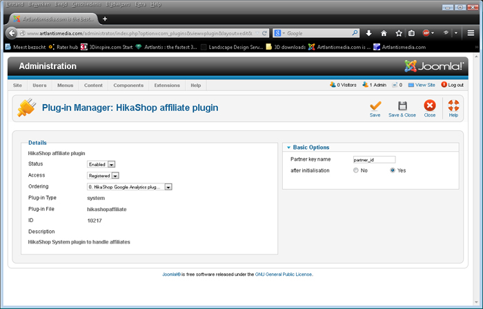

12 years 2 months ago #163845
Sorry to say so but it doesn't help much.
Please tell me where to find the "onAfterRoute" trigger. Screenshot attached.
And I do not know how to use "$app->enqueueMessage('....');"
user is activated IserID is correct.

  • Posts: 26386
  • Thank you received: 4078
12 years 2 months ago #163850
It is in the source code of the plugin.
It requires some full debug in the plugin in order to understand why the plugin is not called and the click is not stored in the database.
Because, it is possible that something else in your website block the hikashop affiliate plugin to work correctly.

Well, apparantly the plugin does not work correctly. Since I do not know how to code I buy software so I don't have to code.
Some time passed since I posted my question and now it seems something has to be done in the sourcecode.... :dry: .....mmmh
How can this be solved?
