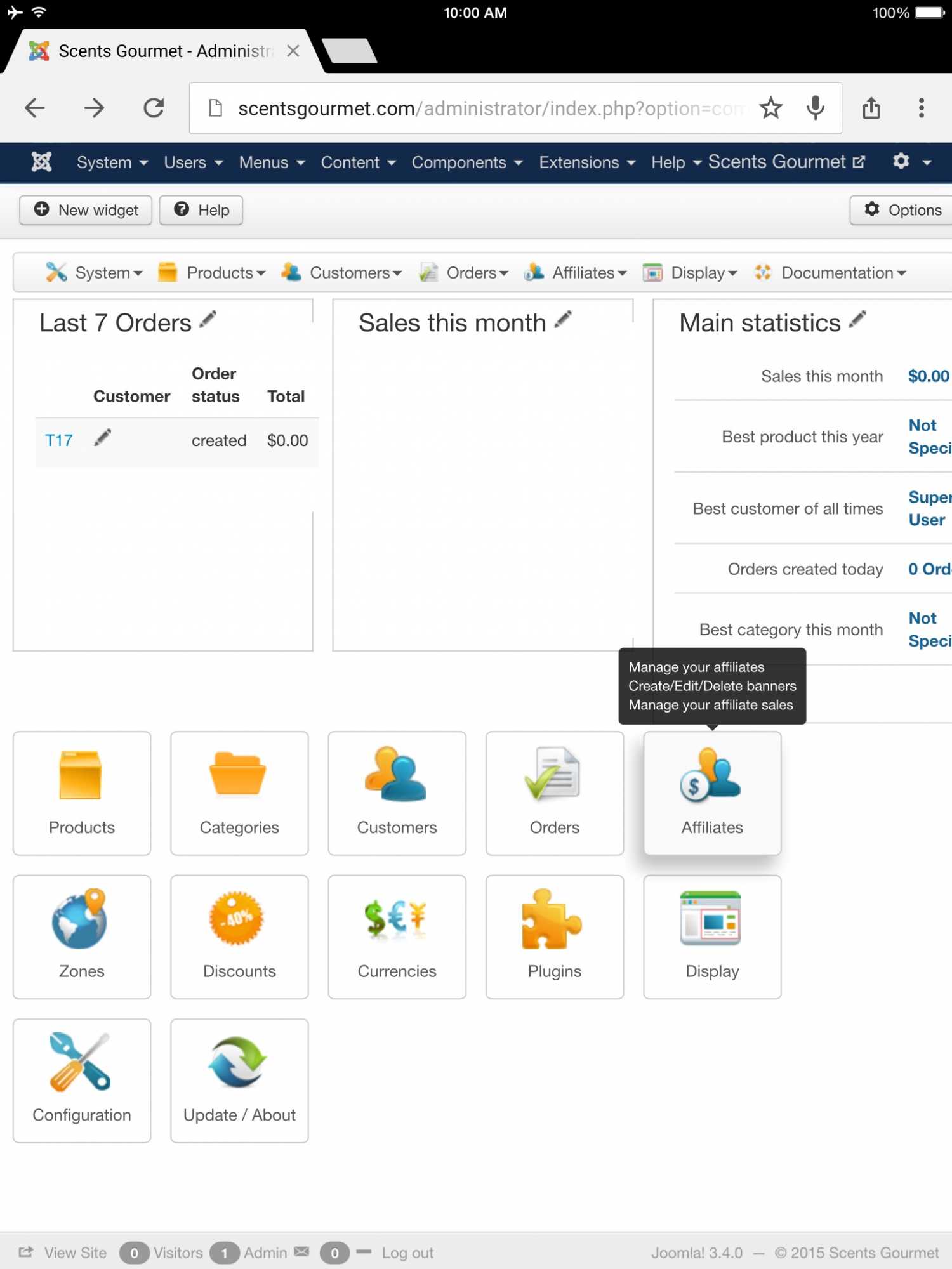

-- Error-message(debug-mod must be tuned on) -- : It won't let me click on the Affiliate Tab to change the affiliate information. I don't know what to do it absolutely doesn't work.

11 years 4 months ago #201788
I cannot change the % commission or any of the other options for affiliates. No matter how many times I try pressing that button it doesn't do anything.

I am using Chrome and Firefox.
The Tab is still not working. I want a set fee for all affiliates when I click on components and then HikaShop which brings me to the last 7 days, sales this month, main statistics with the buttons, products, categories, customers etc and the button for Affiliates does not work.

11 years 4 months ago #201910
1. Ah now I understand. It's just the button on the dashboard with doesn't work. That button actually leads to the same place as the menu Affiliates>Banners in order for you to configure your affiliate banners. If you want to configure your affiliate fees globally, you can do that in the Affiliates section of the Features tab of the Hikashop configuration page.
