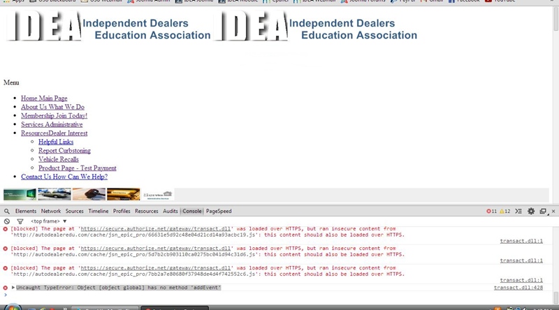

I set it back to Yes. Registered as a new user, was redirected to Authorize.net payment page, submitted payment, and the Authorize.net thank you page is messed up, there is a script error (I think this is a script error).
Here's a screenshot of the error - Uncaught TypeError: Object (object global) has no method 'addEvent':
So when the Force user logout on group update is set to Yes in the Hikashop group plugin, the thank you page from Authorize.net is messed up but the user is logged out. When I set the Force user logout on group update to No, then the thank you page from Authorize.net is fine and the user is able to be redirected back to the site, but is of course is logged in.
Not sure what is causing the error and the thank you page looking weird. How can I fix this? Since it only happens when the Force user logout on group update is set to Yes, then I am assuming it's tied to the plugin somehow?

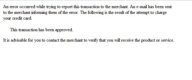

I turned on debug mode and the error reporting and this is what I get when I register as a new user, then I'm directed to Authorize.net payment page, I submit payment, and this what I get for Authorize.net's thank you page now:
I am not sure if this is what you meant by turning on debug and error reporting. But I am getting the script error on the thank you page that is displayed after submitting payment with Authorize's payment form. So this is still with Authorize and the URL of secure.authorize.net/gateway/transact.dll , so it's not part of my Joomla site. I don't see any Joomla debug or error reporting for this page. Or am I doing this wrong? Is there another way to debug this error using Joomla's debug and error reporting even though it's on Authorize's page?
I only get the script error on Authorize's thank you page when Force user logout on group update is set to yes in the Hikashop group plugin.
