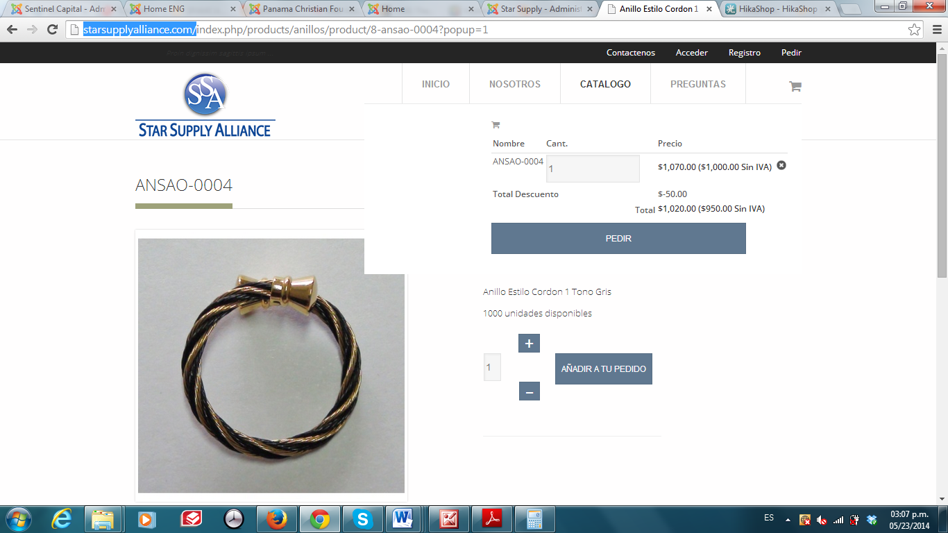

Your suggestion has fixed the issue with the incorrect discount calculations.
We now only have one remaining problem with the total calculation.
The system is calculating the tax on the pre-discount total not the post discount total.
I have attached a screen shot to show the issue.
How do we modify the config to get the desired result?
Mike

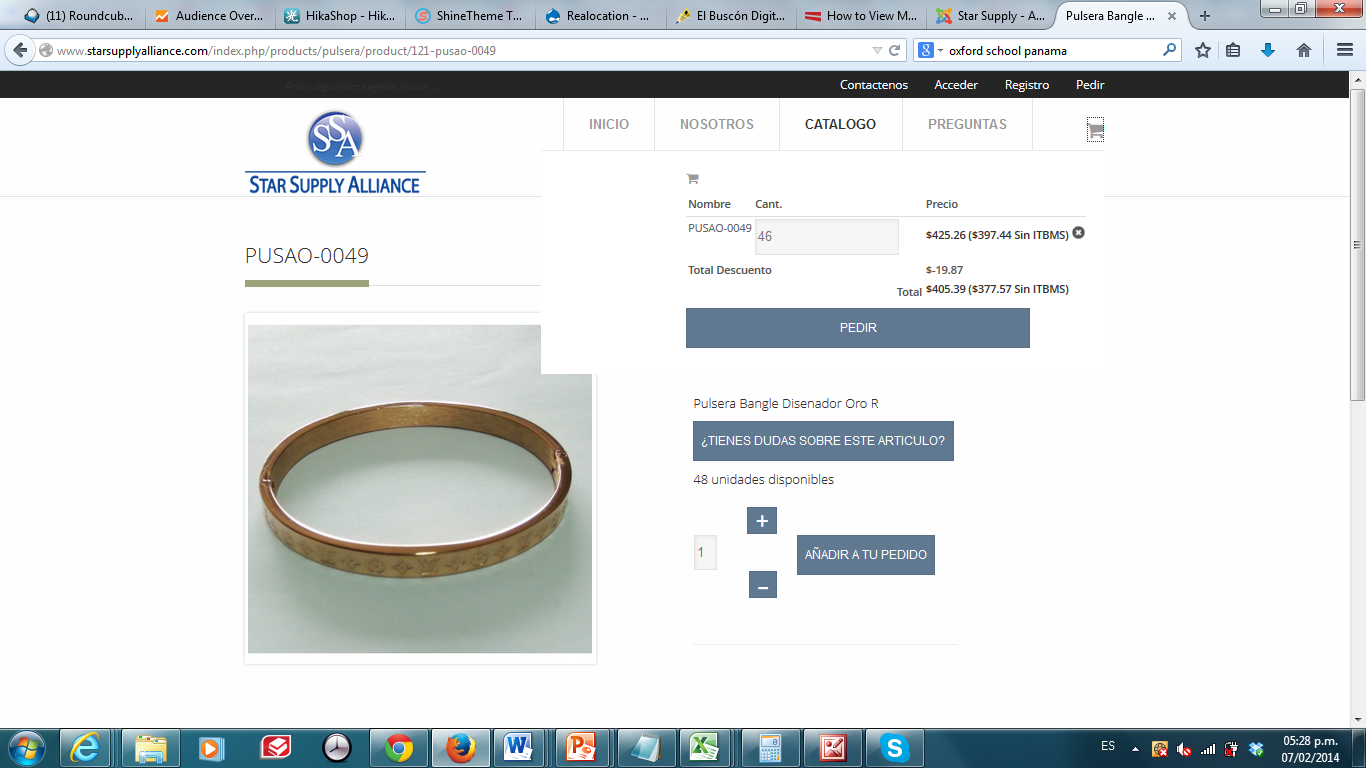

In the Product tax category we have three options None, ITBMS, or Panama Default Tax Category (shown in screen shot). If I choose either ITBMS, or Panama Default Tax Category I get the tax worked out on the pre-discount amount.
All the products have a tax category of Panama Default Tax Category - so I think that using Panama Default Tax Category in the coupon is correct.
However the problem lays with the Apply discounts in the Configuration.
1. If I set Apply discounts to be before taxes (before taxes screen shot) the overall total is correct but the discount is wrong
2. If I set Apply discounts to be after taxes (after taxes screen shot the overall total is incorrect but the discount is correct
I would be more than happy for one of your team to log into my admin account and check why this mystery occurs in the set up
Mike
